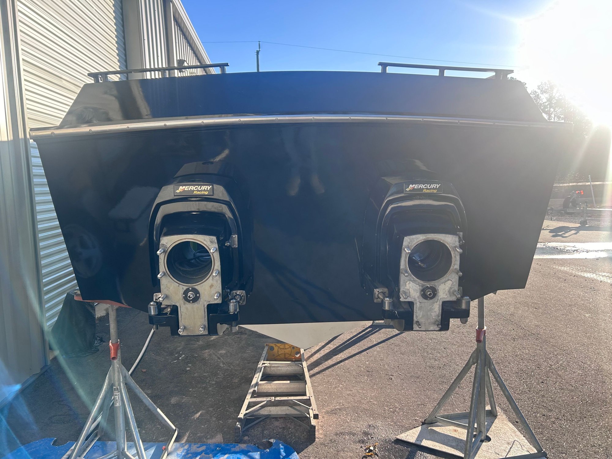

Well.. been a little, but damn are we close now
https://cimg2.ibsrv.net/gimg/www.off...7a989e166.jpeg
https://cimg3.ibsrv.net/gimg/www.off...0fc594891.jpeg
https://cimg5.ibsrv.net/gimg/www.off...d7483e48e.jpeg
https://cimg6.ibsrv.net/gimg/www.off...cfff261fe.jpeg
Anyone have a set of #6 drives for sale? Or anyone want to buy a set of #5’s and boxes? Didn’t think I’d be ready this soon lol.

Building some 540s w/ aluminum heads, putting my blowers on them. Probably going to be around 800-850 if I were to guess. Not looking to make crazy power just yet. Over next down season I’d like to build a nice set of EFI motors. But we’ll see.
Also forgot to mention after cutting the holes for the drives we thought it would be stupid not to blueprint the last 5-6ft of the bottom. And good thing we did bc it had a pretty bad “hook”. Don’t have a ton of pictures of that but here she is blocked up.
https://cimg5.ibsrv.net/gimg/www.off...25022fb33.jpeg
https://cimg6.ibsrv.net/gimg/www.off...295eb4065.jpeg

I’m sure that helps with straight bottom but now that I have about an 11” notch it may act differently.
