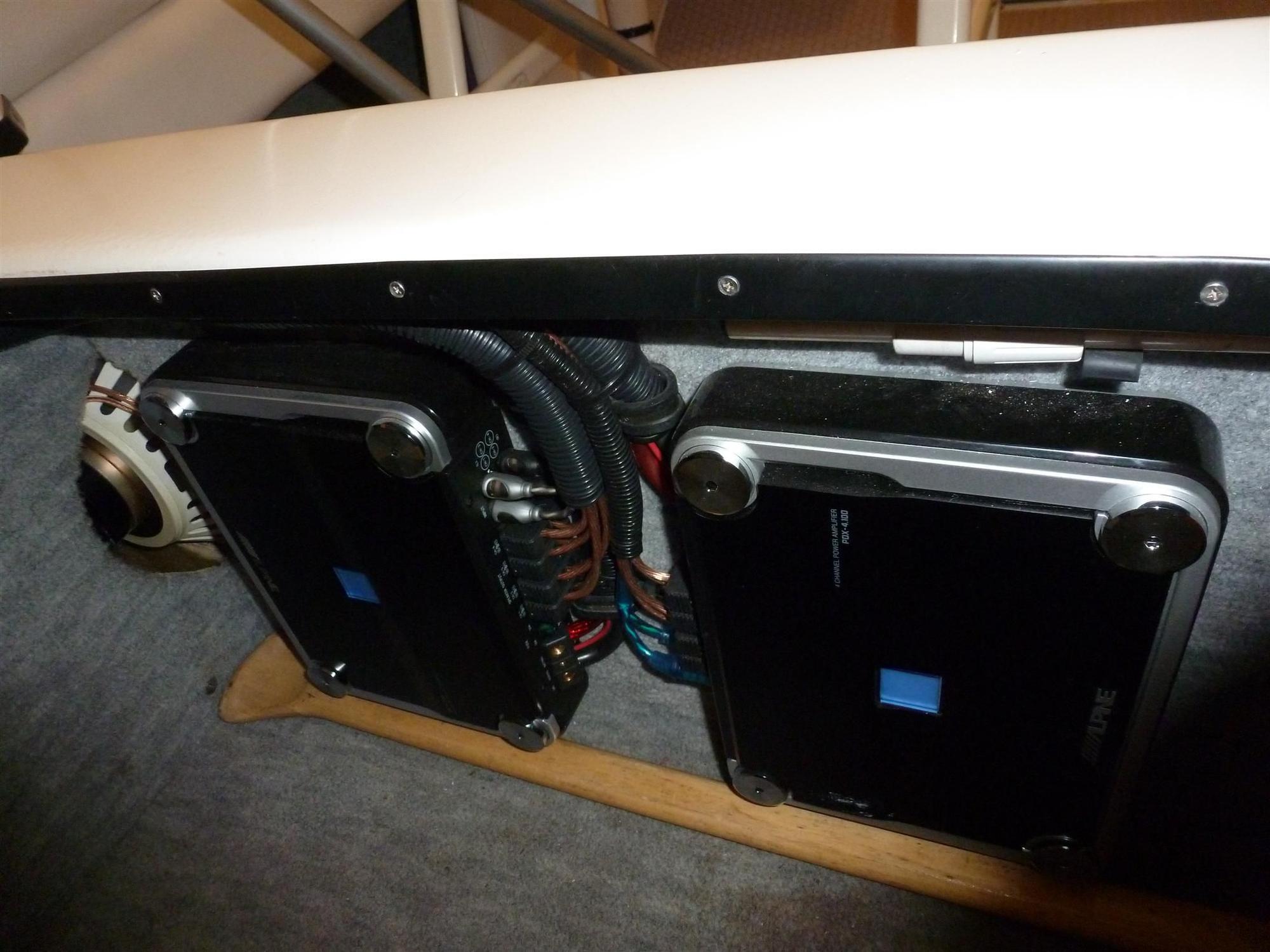

I prefer to keep my amps as close to the batteries as possible. I would rather run shorter power and ground wires to reduce resistance and then run longer RCA's to the head unit.
I put my amps in my AT under the back seat. I have a 2-3" overhang lip though, so the chances of them getting wet are slim to none.

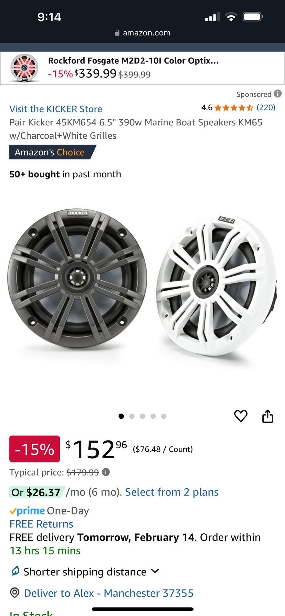

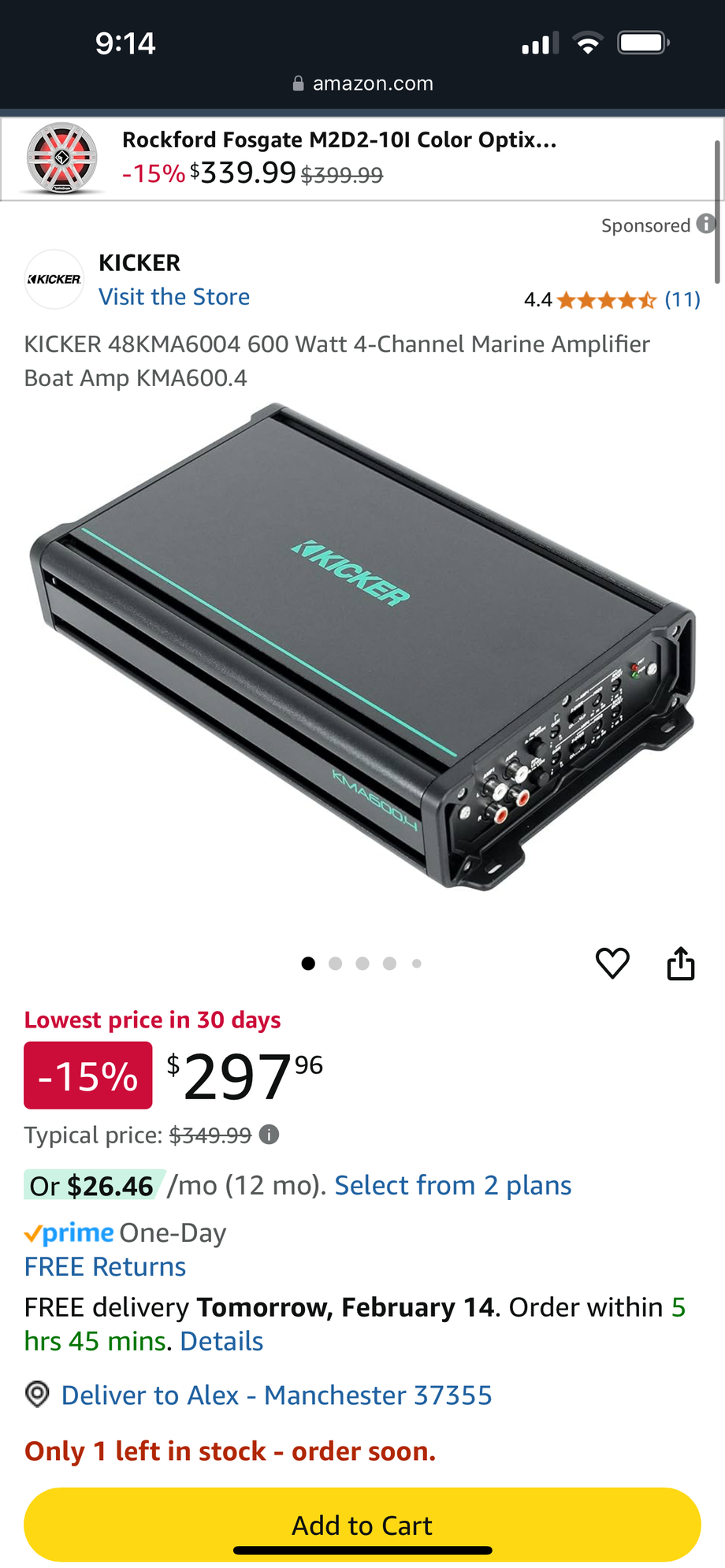

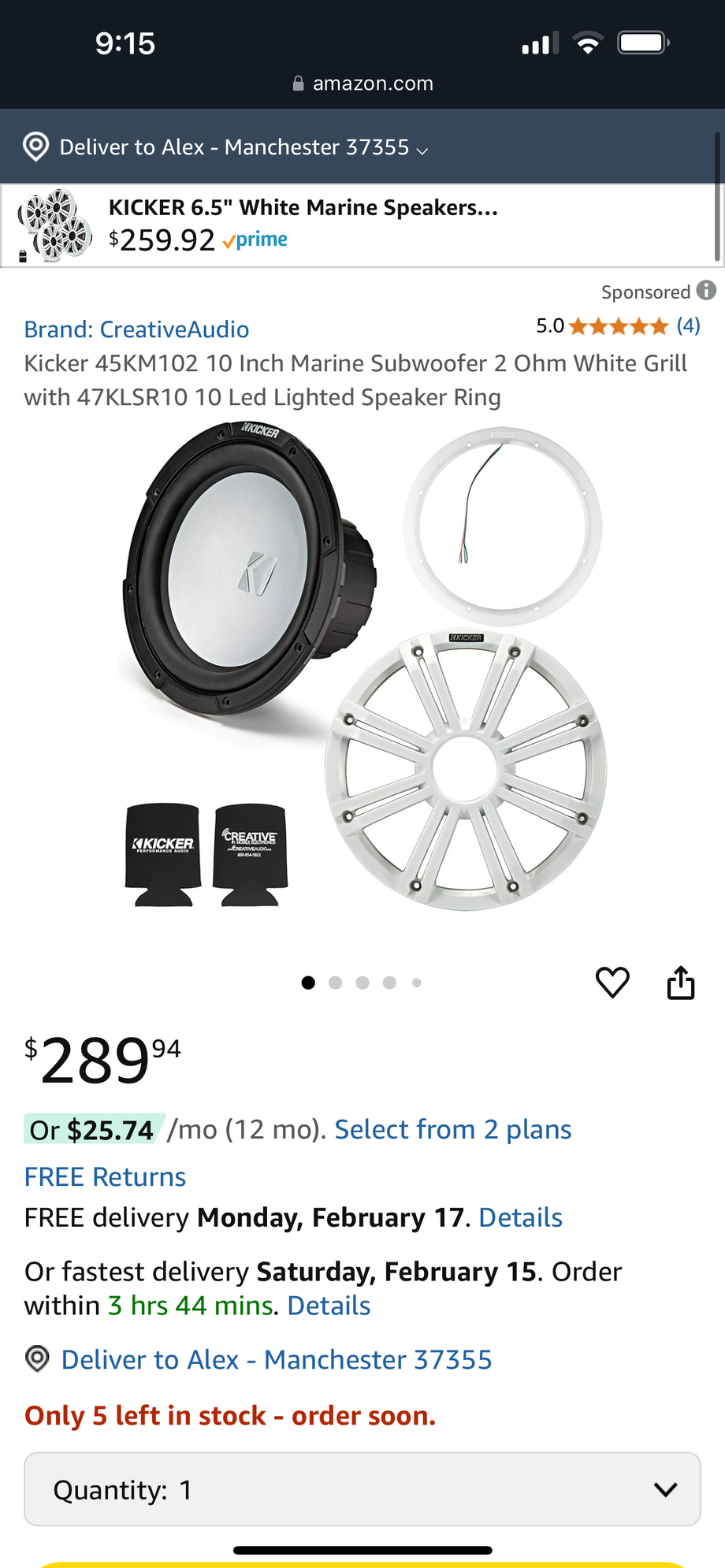

Thinking on this set up I’m not a real stereo guru if you guys want to give me your opinions. I’m certainly not trying to be the loudest either. My dry exhaust makes the noise I wanna hear anyway LOL anyways
im thinking these 2 6.5’s
this 600w 4 channel amp
2 10in subs.

I personally like the sound of kicker and JL better than fosgate. Personal preference though. Fosgate does have a great name in the industry and people love them. Like Glock and sig or Chevy ford dodge, people have their favorites
I would recommend getting two sets of the 6.5’s though. A set at the side panels next to the front bolsters and a set lower behind the bolsters next to the rear bench. You may even want to consider a 3rd set in the cabin to have music down there too. It’s nice to have those on a fader to dim them though. You can run a 4 channel amp to the 2 sets of 6.5’s and a 2 channel dedicated amp to the subs. Cleaner, more power. Less load.

Where are you going to mount the subs? Under the rear seat? If you’re just going to slap them in there and not have them in boxes, you should purchase free air subs. Other options is have small sub boxes built behind the area you mount them under the rear bench. Enclosed boxes always sound better and have more of a bass sound or harder crisper thump. Open air is less “solid” bass. They mounted my 12” free air subs in the gunnels under the bolsters in our cafe. I wasn’t a fan. Rattled a bit and lost the deep bass. Our old gun had free air subs under the rear bench that sounded ok. Best sound is gonna be from an enclosed sub box. Our current hub has them. Nice deep bass. Hard punch.
