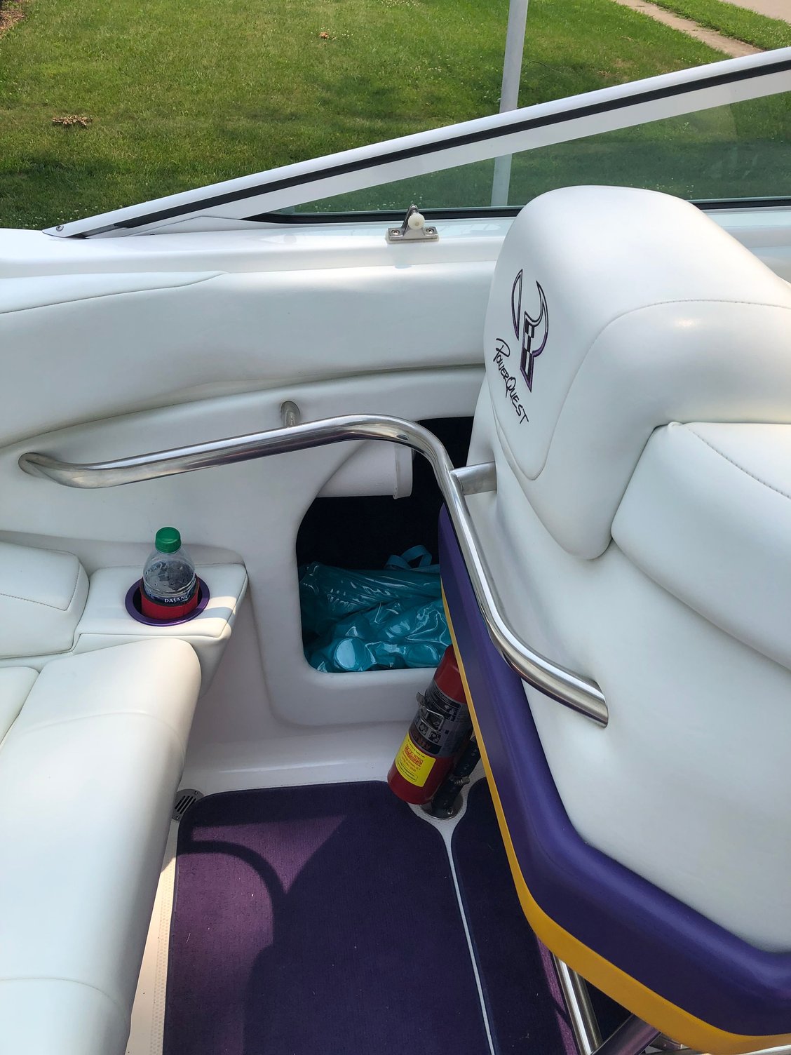

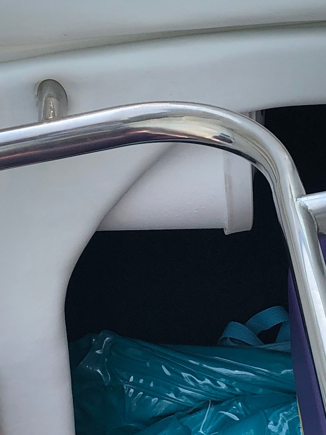

Use a router to cut the hole through the panel from behind without cutting the vinyl. Try and suspend the area you're cutting over open air so you're not pushing the vinyl and padding toward the cutter. You might even stop just short of cutting all the way through and finish with a utility knife. Then you can cut slits in the vinyl from the center to just short of the hole in the panel, making triangles that you can stretch around behind the panel and staple. This will keep the vinyl tight. While I've never done it, I've seen it done and it works great.
As for subs, I'm a full-throated advocate of Bazooka tubes. They are self-contained, relatively compact and sound great. They have passive and several levels of powered models. I have an 8" tube, the lower powered model, tucked into the gunwale pocket in our PQ that takes up zero space I can actually use, and it will run us out if I crank it.

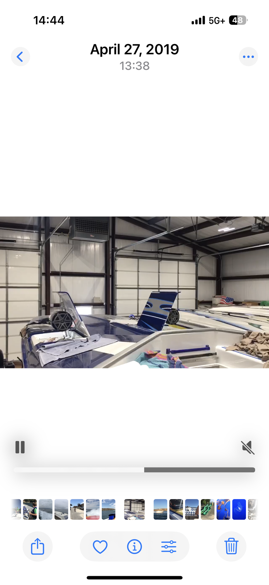

Carter did these in a cafe. This still is from a video. The hatches were on an electric ram. Push the button at the helm and they open up. Bad azz design. Speakers out front for when you’re beached.
