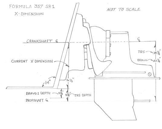

So I’m curious about this I’ve done some researching it seems like about everywhere. Just how big a deal is this dimension in our boats or I should say on my 1987 Cafe?
reason I ask after talking with old owners of mine and even the glass company that put the transom and stringers in and converted to bravo from TRS they “ x” was forgot to be raised im told and after some half a$$ Measuring and comparing others my Bravos are at TRS height. Which I have gathered are deeper? That being said I’m swinging my bravo 24p 4 blades easily in all ranges of rpms etc. my question is I guess would I be more beneficial top speed etc? going to a 3 blade as the drives are as deep as a TRS or am I looking at and thinking about this wrong? I know it’s a Cafe and it’s a sled and it’s not fast and I don’t expect it to be but if I can get what I can get or even see better I’m all ears!

I cant seem to find it, but i have a comparison chart between the drives somewhere. But the Bravo is like 2.5" shorter than the TRS drive...so if the bravo is mounted in the exact same spot, the prop shaft is still 2.5" closer to the hull bottom than the TRS was before. This is assuming they cut the transom according to TRS specs...
interesting!! I’ve been trying to find that info as well!

Dont know where i got this from so i cant give credit where its due...but i found this in my stash
