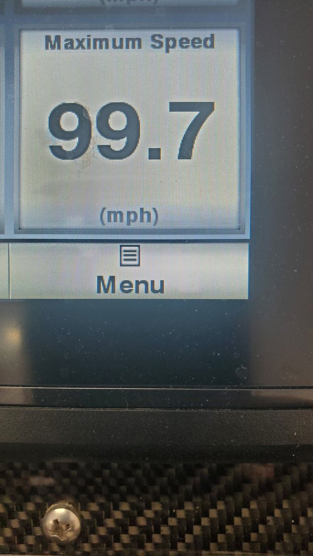

-2 shorties may be slipping. I know we just figured this out on my old T/S Gun. I was over 800 HP and never could crack 100. barley hit 95.
Way too much slip on mine. I was full SCX but drives were way high.
