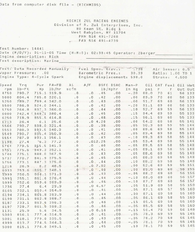

Originally Posted by GLH
I think he's having Zul put in an 1150HP with a crashbox on a #6.
You know ... to match the overkill from tabs.
No we went with 800+ here is the print out from dyno
Rick OSG
Attached Thumbnails Let The Work Begin On The 20'-osg-20-engine-dyno-sheet-web.jpg

niiiice, is that a 598 tunnel ram?

Rick, I thought you were gonna just stay w/ stock merc for the 20?
But I must say..."GOOD CHOICE!"
