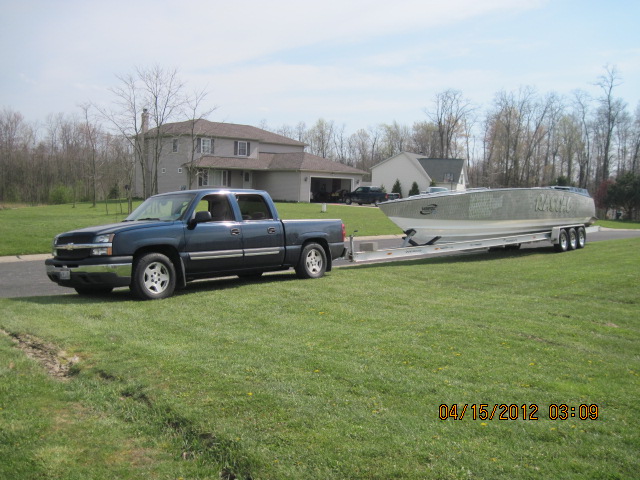

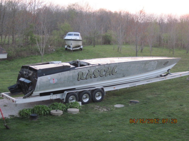

Here are some more pictures. Taking the Rascal to get weighed. Any pictures would be appreciated.
