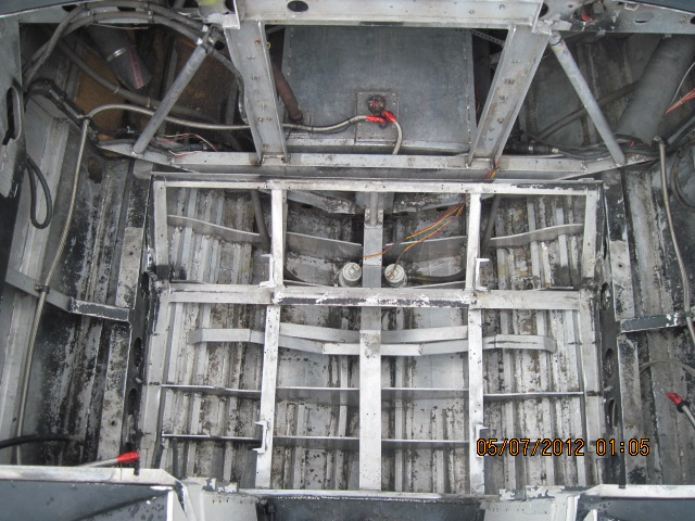

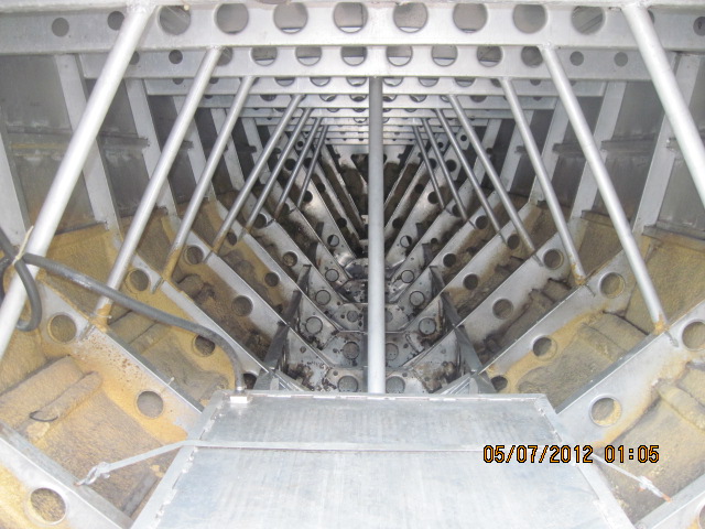

The cockpit transformation is coming along good. The cockpit area was filled with fuel tanks and extra aluminum for the bracing of the canopy. A couple of hundred pounds of aluminum where taken out for that. The cockpit floor area had extra's that had to be cut out to get back to the old floor platform. this week I am welding in the new dash panel the full length of the top forward edge of the cockpit and edge of the deck. I found a very good welder that will dime weld it so not to have to grind down the welds to keep that machine look. I have the floor panels cut out and the sides of the cockpit will be diamond plate.
I also added a picture of the inside bow structure. Remember this was built in 1973 when most aluminum boats had regular plate stringers and ribs. Most of the Rascal's structure is bent aircraft aluminum for strength and less weight.
