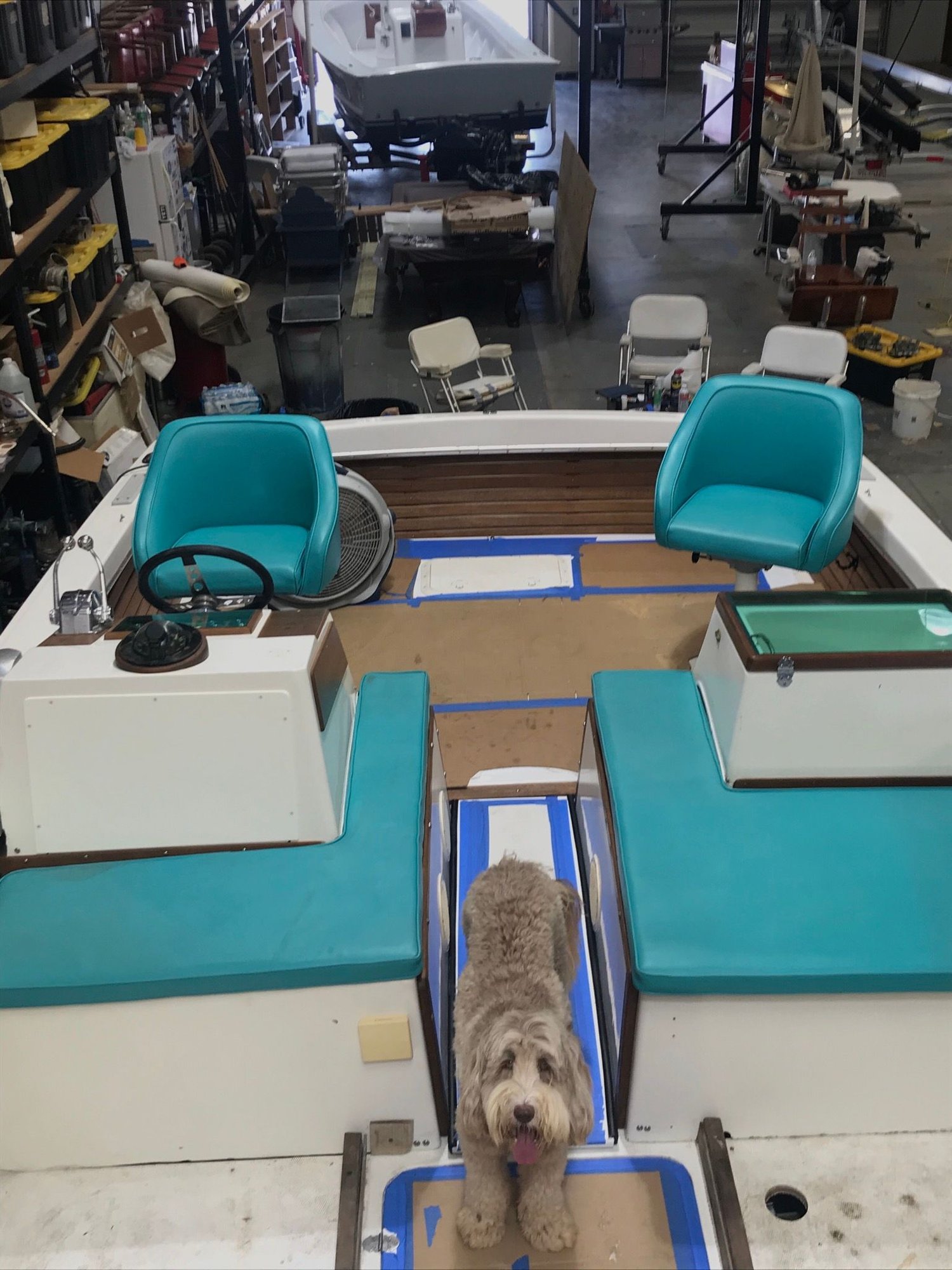

Post 7 Cary 28: For the past few years before my purchasing she apparently sat outside without a top, just maybe the large bimini, and the result was the abundant teak taking a beating. We removed what we could easily remove, including all of the strips surrounding the inside of the aft cockpit, and refinished it and other teak in-place. Looks great now. Also added teak pieces around the helm to cover up previous penetrations no longer needed. We’ve got a few more pieces we still may replace.

Post 8 Cary 28: In the cabin we replaced the original hull-liner ceiling carpet along with the side panels. All of the original teal vinyl upholstery was professionally cleaned and still looks unbelievably remarkable. (And I’m assuming it’s original as it still has the old mfr’rs tags on them). We plan to borrow or re-purpose back sides of several cushions to create forward combing pads as was an original option, and will hope to cover some less than attractive repainted and worn surfaces. The hull was repainted sometime before Jim bought the boat as he told me in a conversation last year. The paint job was very well done and has held up well but they did paint over several thru-hull fittings which I’ll clean up later. And where moist cushions sat on the paint for the extended period it naturally did some damage. We had the floor panels repainted with non-skid as had been done before so unfortunately the original plank molded look in the gelcoat is long gone,

Post 10 Cary 28, whew! I plan to re-launch in the coming hours, with most all interior parts reinstalled except for the front built-in seats which are still out for painting. The complicated four-piece engine boxes are now back in as well, and helm box bolted back down as last week we had it securely balanced with ratchet straps fore and aft for testing. Cardboard on the floor is obviously protecting the new finish until all testing is complete. We also replaced the badly worn clear acrylic covers over the engine gauges and port-side cooler?? with classic tinted acrylic. Maybe I can now post a few pics.
