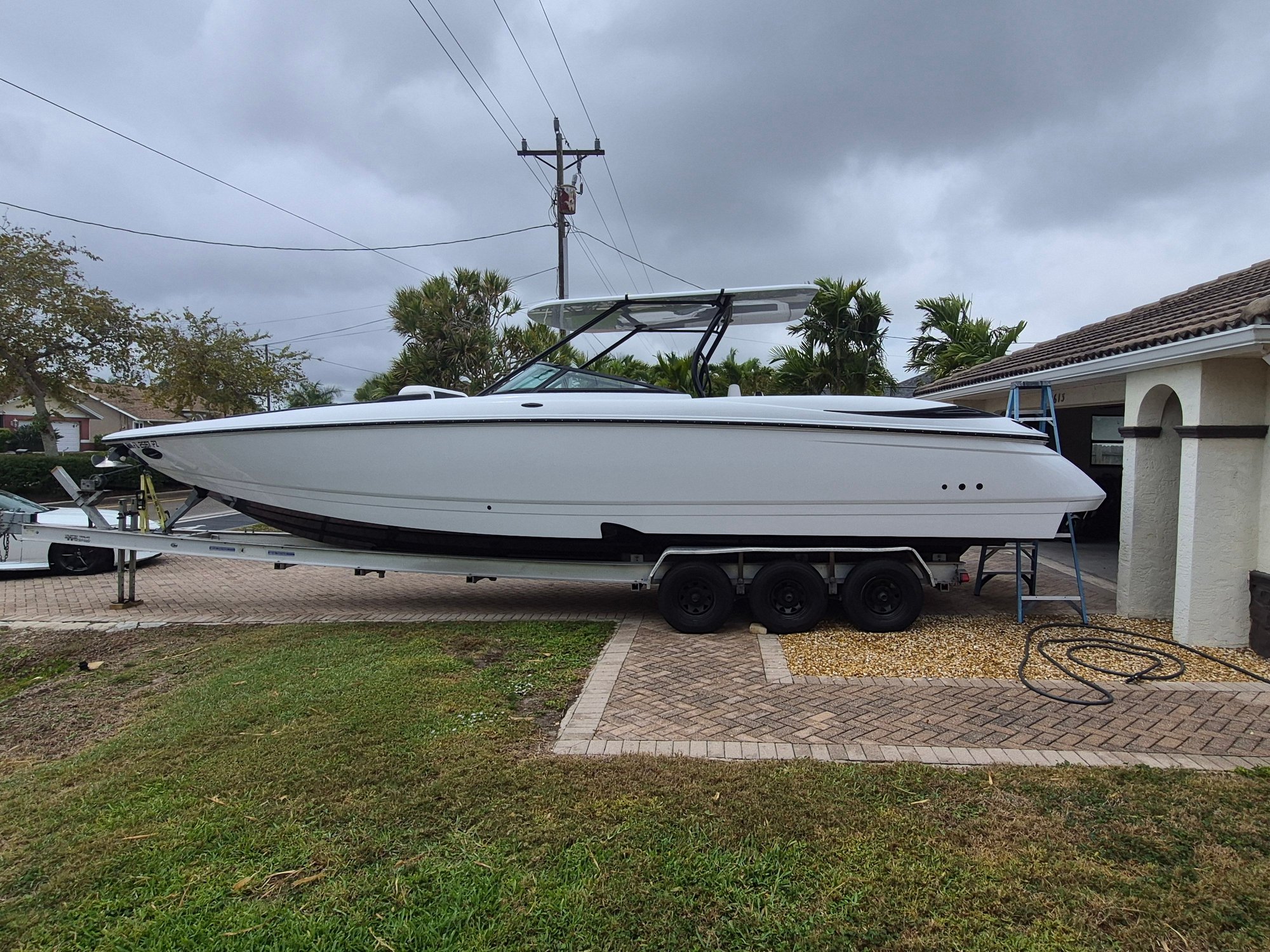

Old 03-30-2026 | 07:17 PM
  #74
Joined: Nov 2003
Posts: 2,504
Likes: 153
From: Cape Coral, FL
T-Top mounted
Maritime_Eng is offline
