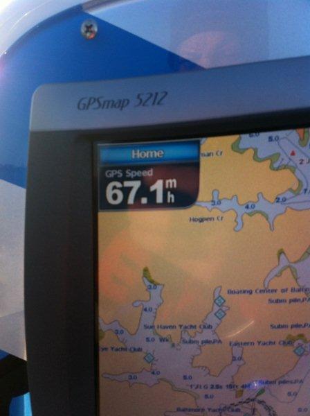

Allstar Marine just completed testing on a 2008 36' Concept with a pair of 300HP Mercury Verados. The guys from Concept were very helpful with information and assistance. Below is our results.
Prop Testing:
Customer Props
Props: Mercury Enertia 21 Pitch 3 Blade Props
Part #: Mercury 48-89902/03
Fuel: 163 Gallons of fuel
Trim: 3.4
Rotation: Props Rotating Out
Slip Rate: 14%
RPM: 6400 (5800-6400)
Speed: 61.3 MPH
Customer Props
Props: Mercury Inertia 21 Pitch 3 Blade Props
Trim: 3.4
Slip Rate: 14%
Speed: 62.4 MPH
Allstar Propellers
Props: Mercury Bravo 1 22 Pitch 4 Blade Props
Part #: Mercury 48-831909/10
Trim: 5.0
Slip Rate: 11%
RPM: 6100 (5800-6400)
Speed: 64 MPH
Allstar Propellers
Trim: 7.0
Rotation: Props Rotating In
Slip Rate: 12%
Speed: 67.1 MPH
