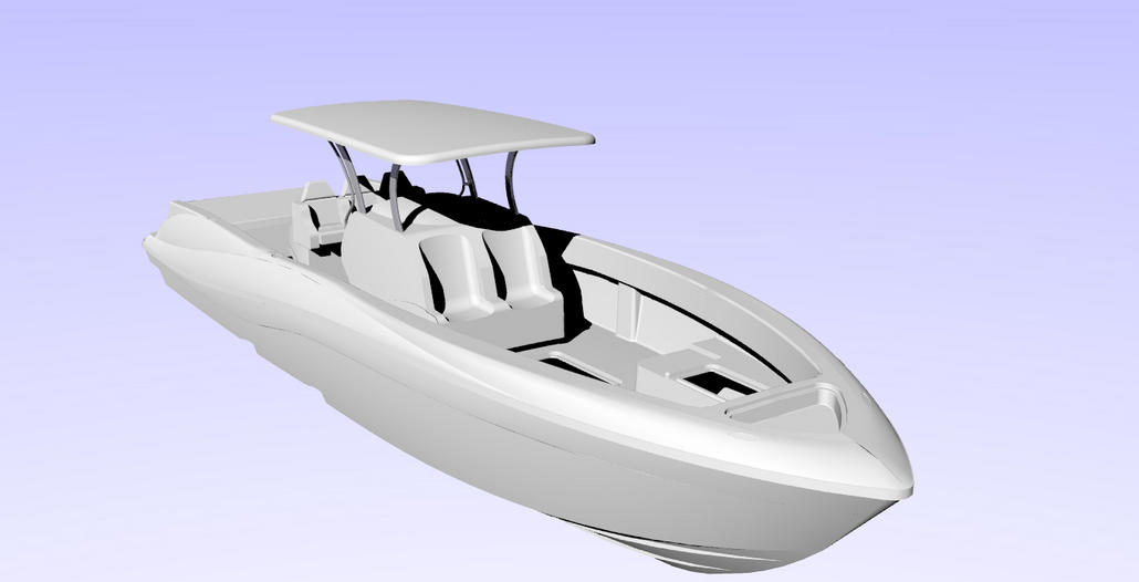

Default Quick shot of the new 39...
Well on it's way!
The hull and deck are final for the Open. The console, top and helm seat are in process...
More to come...

I like it.
Projections for weight etc?

It should be 13,000lb with trip Verados...

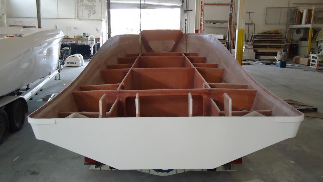

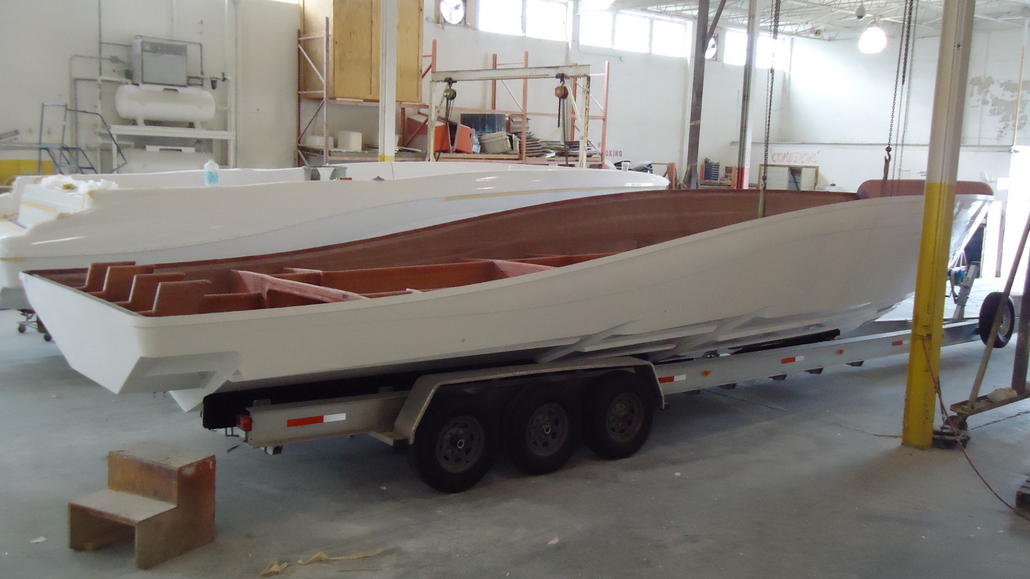

Default First hull is out of the mold
Moving along...

We build all the boats with the same materials in the transom now.... The only difference between the triple and quad is just the width of the well area.
The transoms are cored with 24lb density foam in 1" layers with two glass layers between each layer of foam, then capped. All get knuckles on the outer joint.
Stringer arrangement changes triples to quad.
I get the stringer and transom foam pre cut via CNC, as well as each layer of fiberglass and core. It is a hand laid vinylester layup, but I took the trimming and overlap factor out of most of it....
