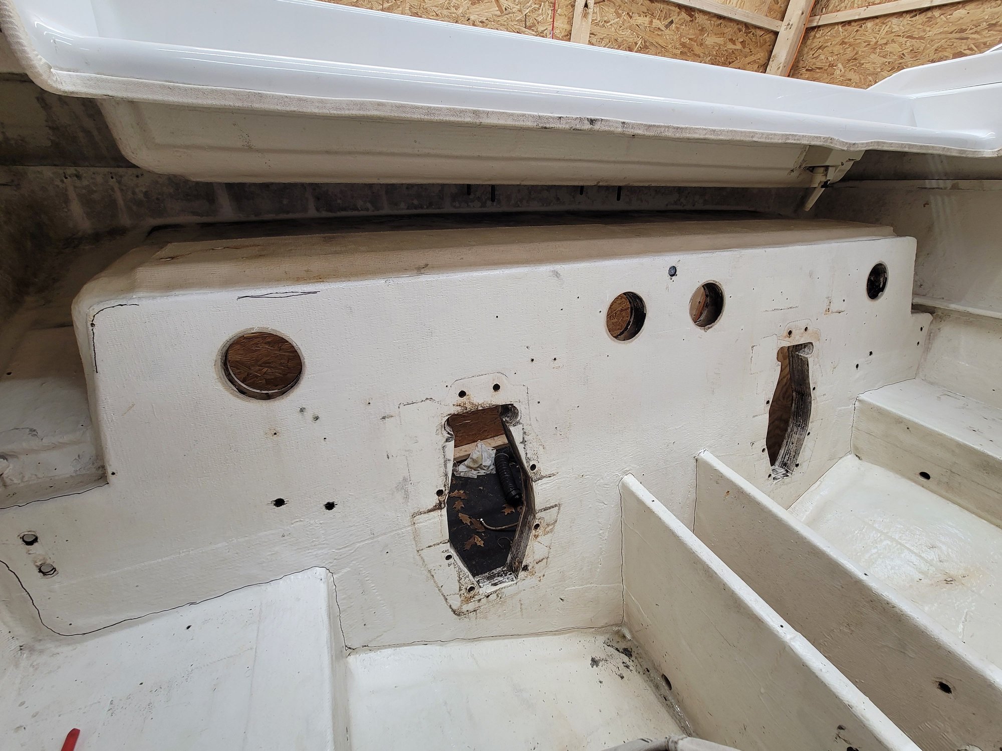

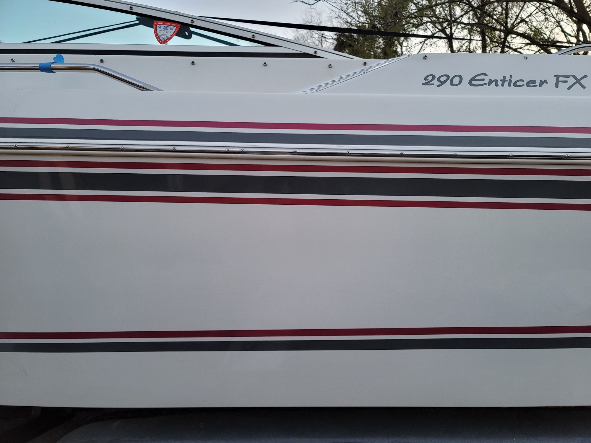

Here are some pictures to get things started. This boat was kept indoors for its entire life in a climate-controlled building until my father became very ill about eight years ago when it sat outside under the original cockpit cover that couldn't withstand the seasons and environment. The only issues this boat has ever had were the common gimble/swivel issue and now this transom rot; other than that, regular maintenance and a carb refresh & tune-up. I've been pretty lucky. Oh, I only found out about the transom because I shredded a drive coupler on the starboard side at full throttle on a poker run. After all, the flex allowed the engine misalignment. Luckily that was the only casualty.
Spent a lot of time with a buffer, and a wide variety of compounds

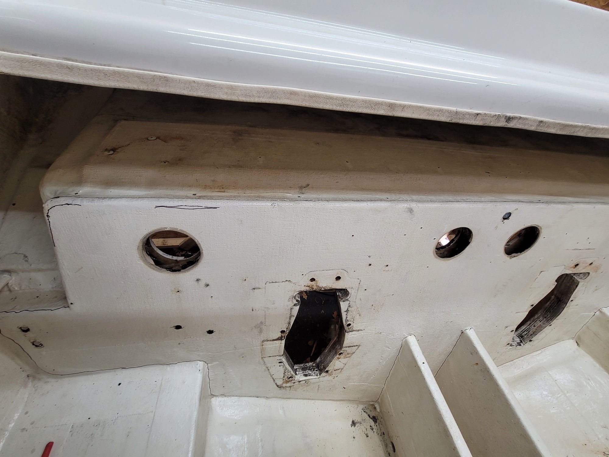

The carnage
The carnage

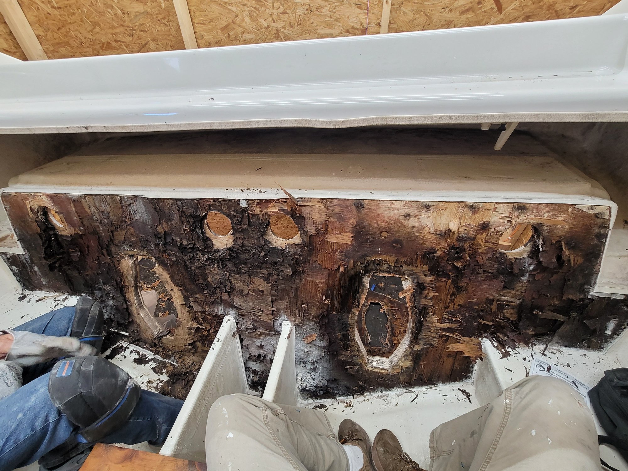

the discovery
Getting started on the inner skin removal
Well that's not good, at least i didn't have too difficult of a time getting the old core out.

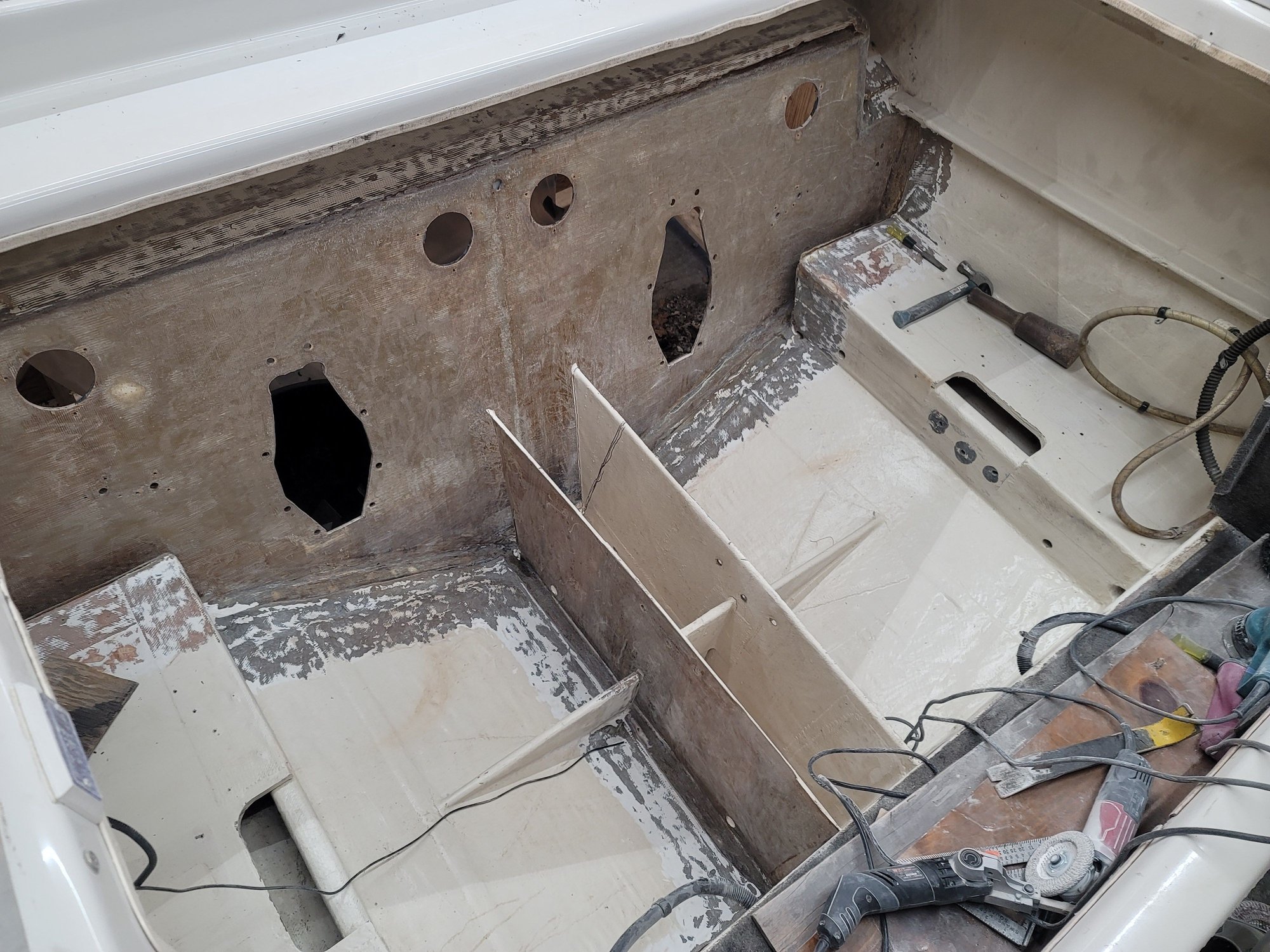

Transom is cleaned and ready
Stringers are out.

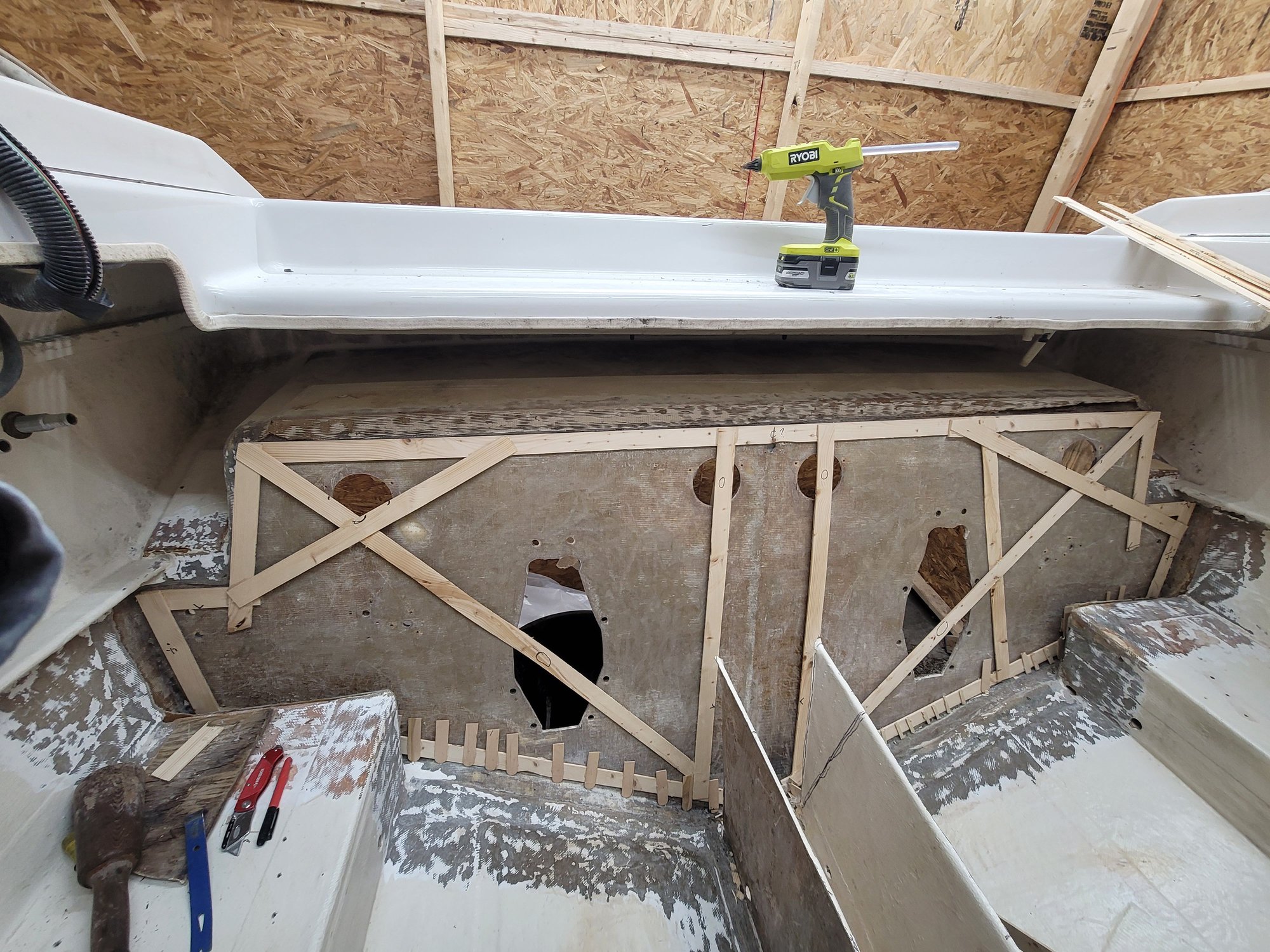

Templating for the new core.

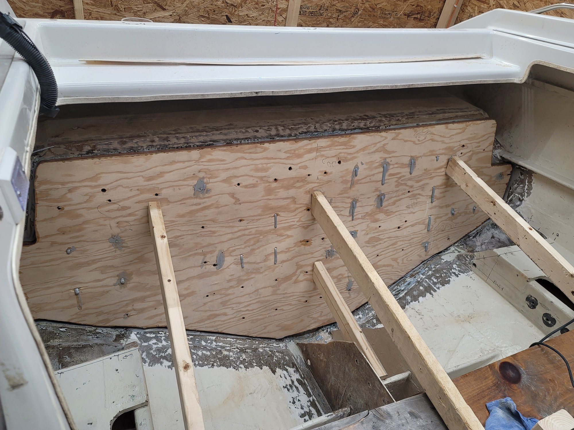

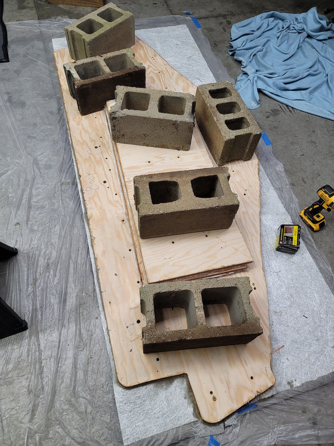

My fiancee and I hotcoated the inside faces of the cores and then laminated them last night with CSM and vinylester resin. Then this morning I hotcoated the bonding face and put it in this afternoon. Using LBI 945 Vinylester Corebond.
laminated the inner stringers while i was at it.

Put boards on the back side over the exhaust holes and key holes and ran screws into the core to get it flush against the fiberglass. That compound is some serious stuff. I used woodworker's finishing wax to protect the gel coat around and beneath all the holes on the exterior, and everything just popped right off after it dried; I'm giving it a few days to cure, and then I'll go ahead and pipe in more of the corebond around the edges and gaps before doing the rest of the glasswork. Unfortunately, it's 32F outside, and my little infrared heater is doing all it can to keep the core mildly warm in the makeshift OSB shack I built around the back of the boat. I hope it warms up soon.
Transom is in, using LBI 945 Vinylester Corebond.
