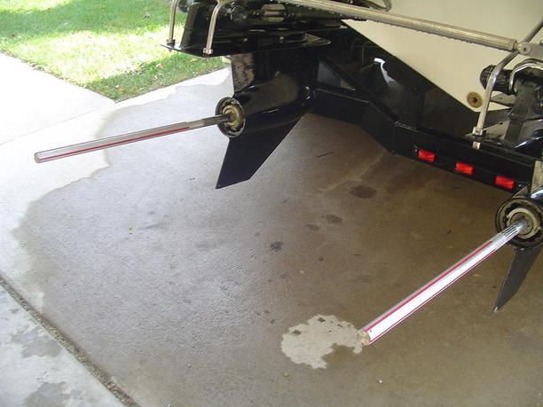

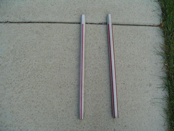

Here's my idea for a drive alignment tool. You thread the rods on the ends of the prop shaft and use the red lines on the rods as adjustment references. You measure the front and rear of the red lines and adjust your tie bar till they are even ......then take the rods off and adjust you toe-in/out...never having to crawl on the ground to measure the front of the drive torpedo

obviously this is for twin applications....
