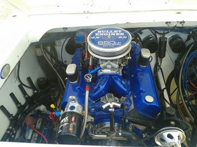

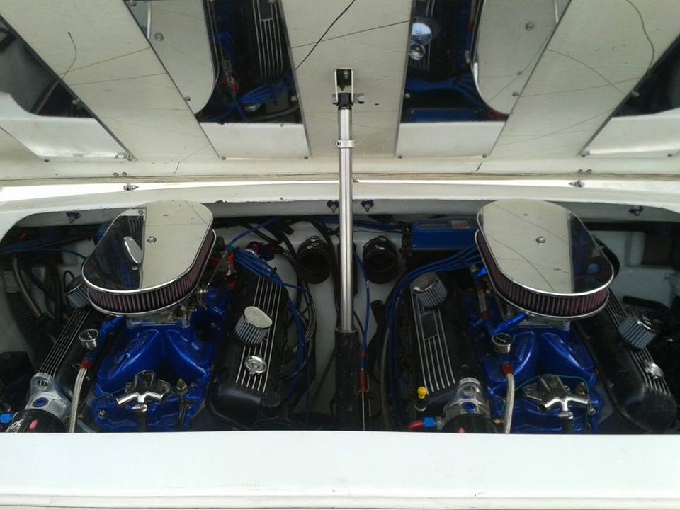

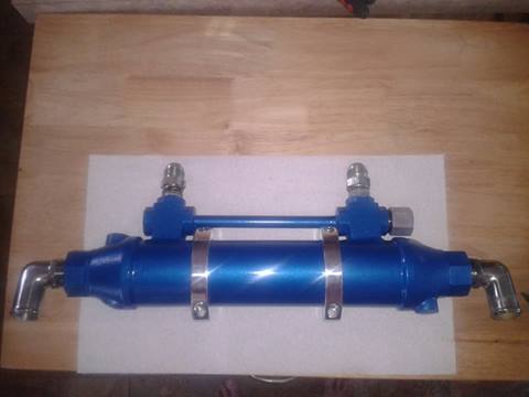

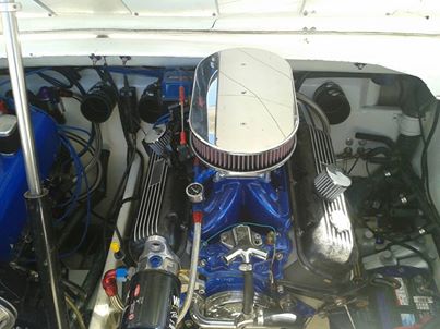

[ATTACH=CONFIG]522170[/ATTACH][ATTACH=CONFIG]522171[/ATTACH][ATTACH=CONFIG]522172[/ATTACH][ATTACH=CONFIG]522173[/ATTACH] A few updates for this year, The coolers were not cooling enough on hard runs & too cold while idling around. New finned 420 valve covers & some Eddie Marine flame arrestors. I think with the headers mounted it is going to look great. Randy
