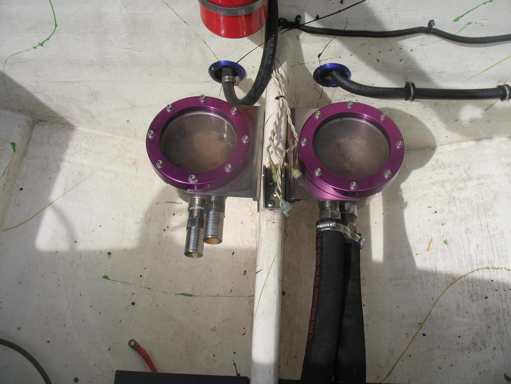

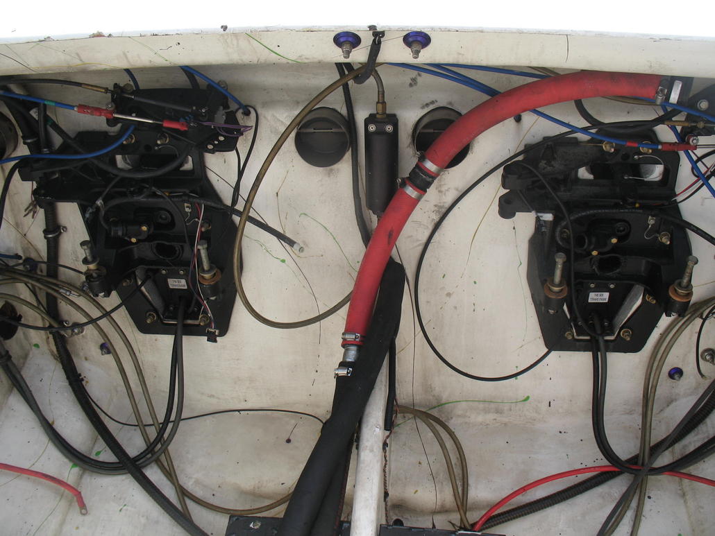

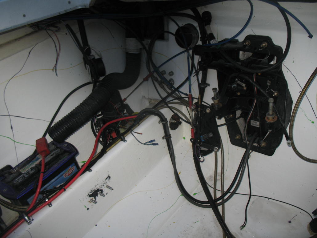

Cleaning
The engines are out & the bilge is filthy go figure, after scrubbing with dish soap & a pressure washer I was only 1/2 way there. Went to the parts store & asked for the best degreaser they have. Its called Super Clean & WOW does it work! Ran out of daylight but I got most of it, will finish up tomorrow. Randy
