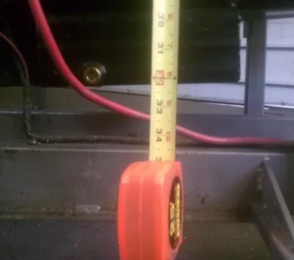

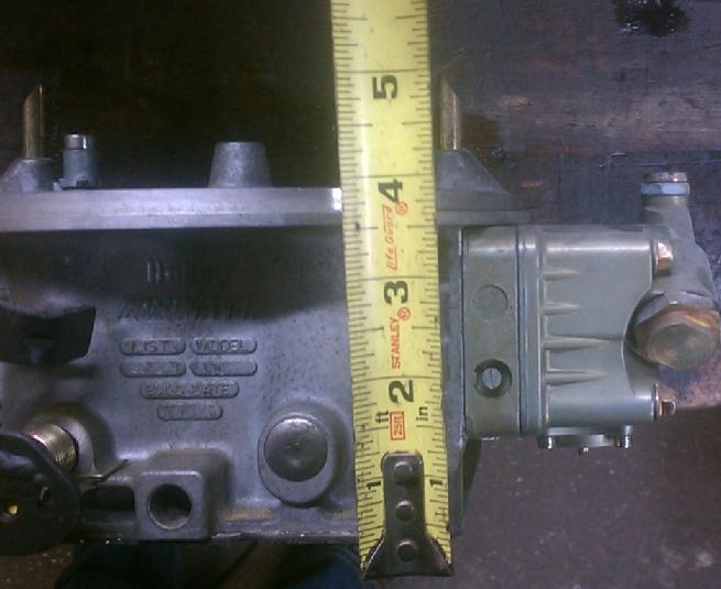

Jersco,
With a Dart single plane and a 4150 Holley the overall height is 32" from the bottom of a Canton 10qt oil pan to the top of a 3" Gaffrig flame arrestor. My Dominator carb measures 4" and the 4150 measures 3.5". So add 1/2" for the Dominator.
