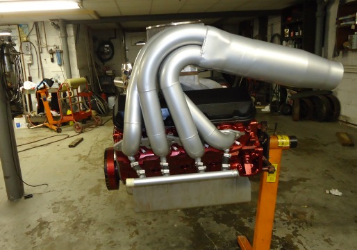

Can't see your pics but here is a couple of an engine in the classifieds with lightning headers & aftermarket manifold & carb to give you an idea
Attached Thumbnails Engine upgrade in process.  ADVICE-50359_3.jpg   Engine upgrade in process.  ADVICE-50359_2.jpg

Give me a few days Randy. I'm going to make arrangements to get it out of storage this week, get some other photos and become a paying member here. I'll keep you posted.
Photos you sent based off photos i have it looks pretty close. What about the other questions i had?
