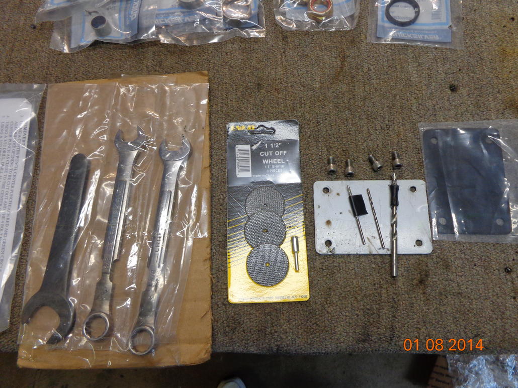

Old 01-08-2014 | 04:39 PM
Posts: 1,085
Likes: 22
From: Fort Worth, Texas
Originally Posted by 86242ls
How much does a kit like this cost?
This is what you get...
Attached Thumbnails Swivel pin replacement...-dsc00948.jpg   Swivel pin replacement...-dsc00946.jpg   Swivel pin replacement...-dsc00947.jpg

Very cool, beats buying a whole new transom assembly! I'll have to check this out come spring on my boat.
