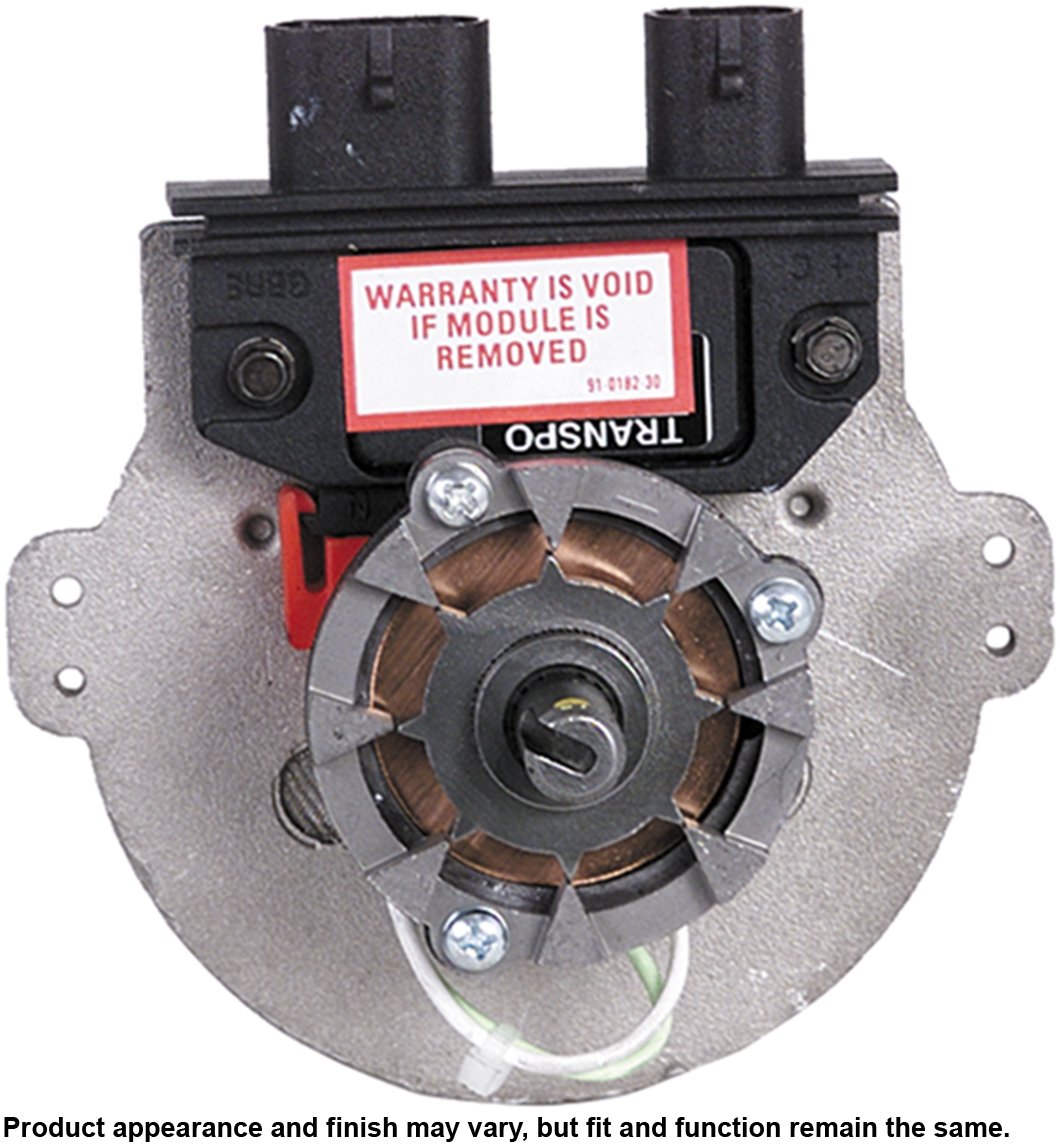

That's (even though a Cardone reman) the Delco / Merc EST, Voyager we are referencing.
Here's the one from Delco themselves:
http://www.amazon.com/gp/offer-listing/B001S34JP0
Note: supposedly comes with cap, rotor too.
You can see the screened vent (flame arrestor) on the left side of the cap base:
SB is online now
