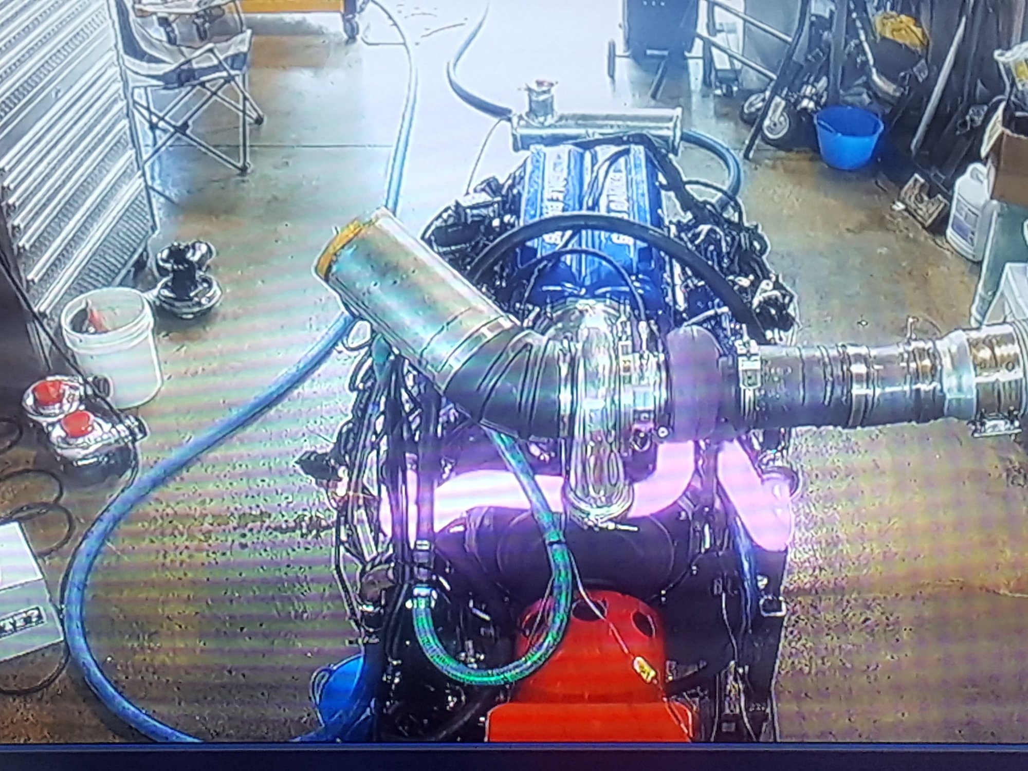

Finally got some builds caught up to this thread. Been hard at work, helping several members get their marinized engines fired up this spring.
Here is the two I've been most waiting to hear run for over a year now. Both fired right up, and are being prepped for some time on the dyno next month. Maybe even bolt some turbos on em..

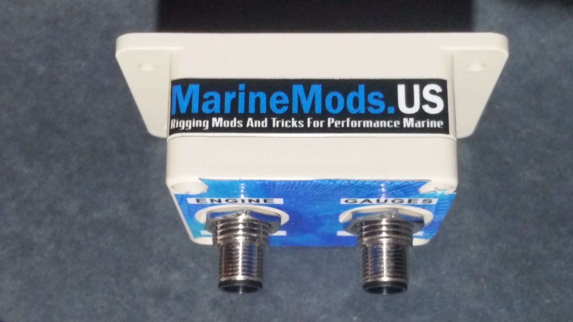

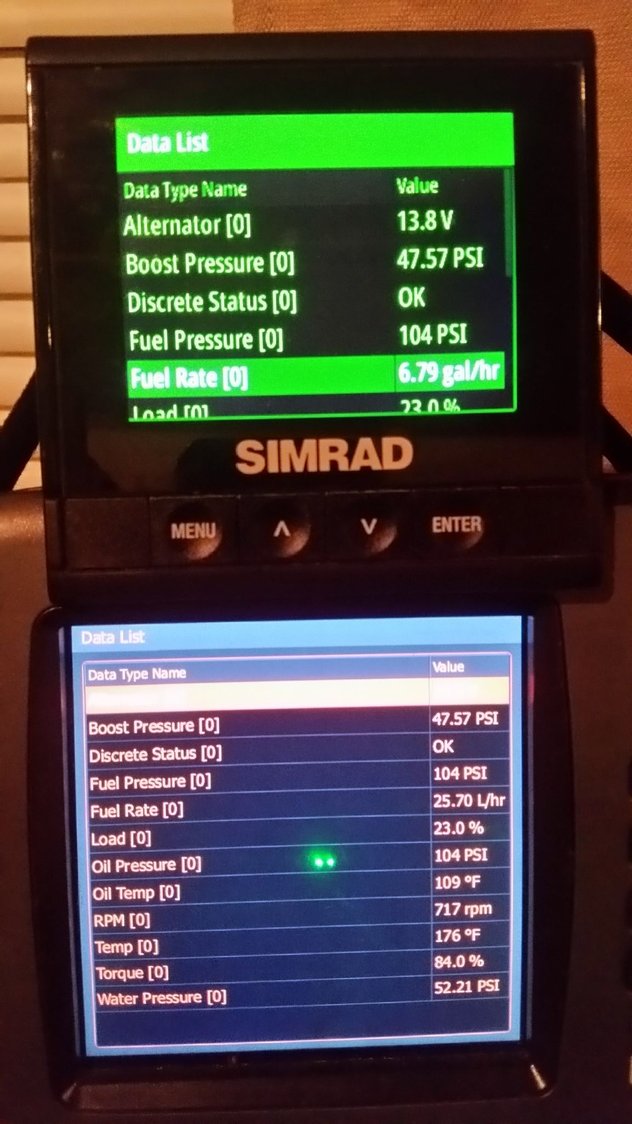

Anymore information on setting up gauges or getting it into a chartplotter display?

Depending on the model year platform you chose, I have a gateway unit that converts GM CANbus data into N2k protocol for all chart plotters and VantageView gauges. Provides ya main gauges like temps, boost, rpm and oil pressure. It's a plug-N-play setup that only requires two wires from the engine to helm.

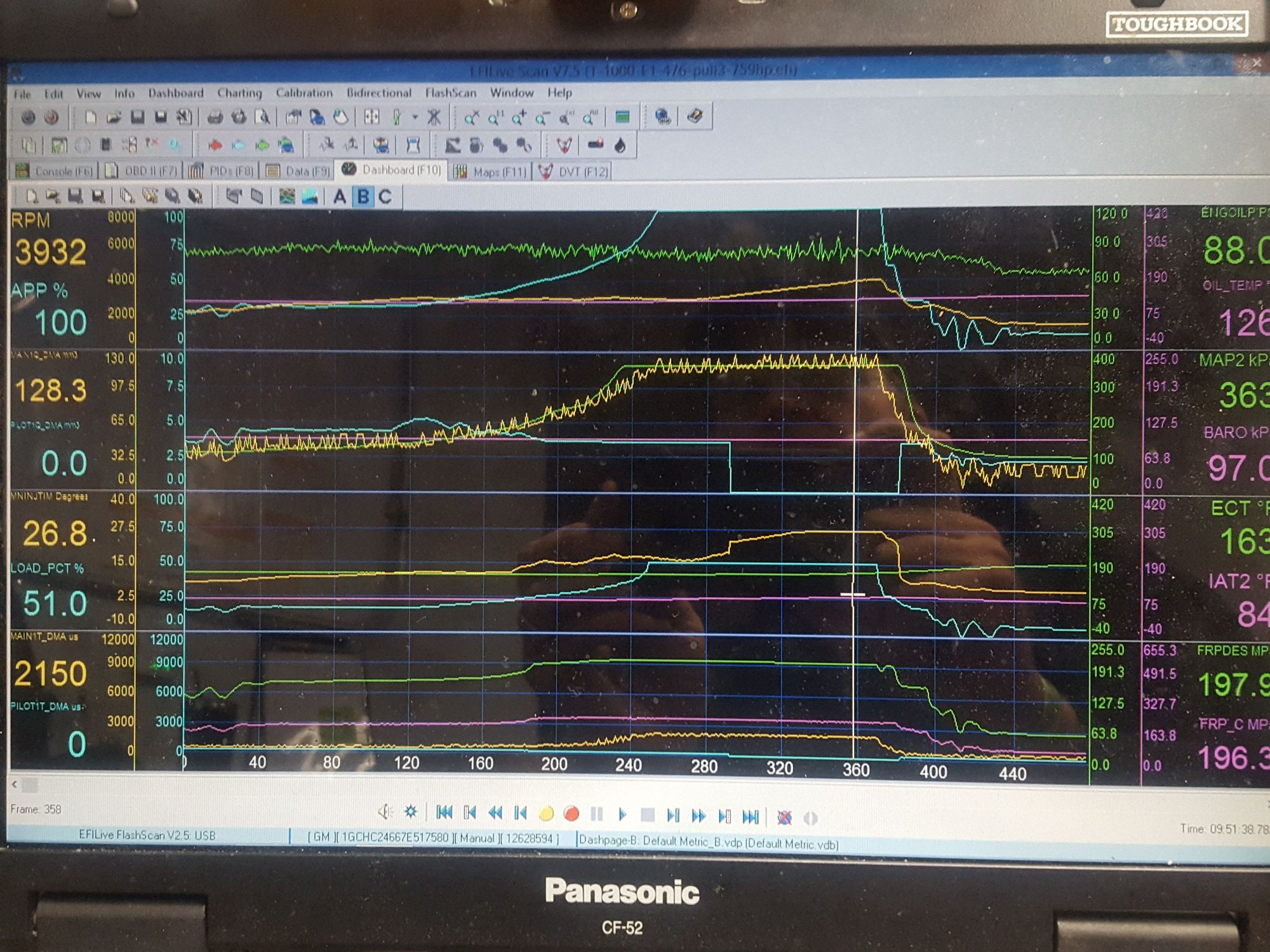

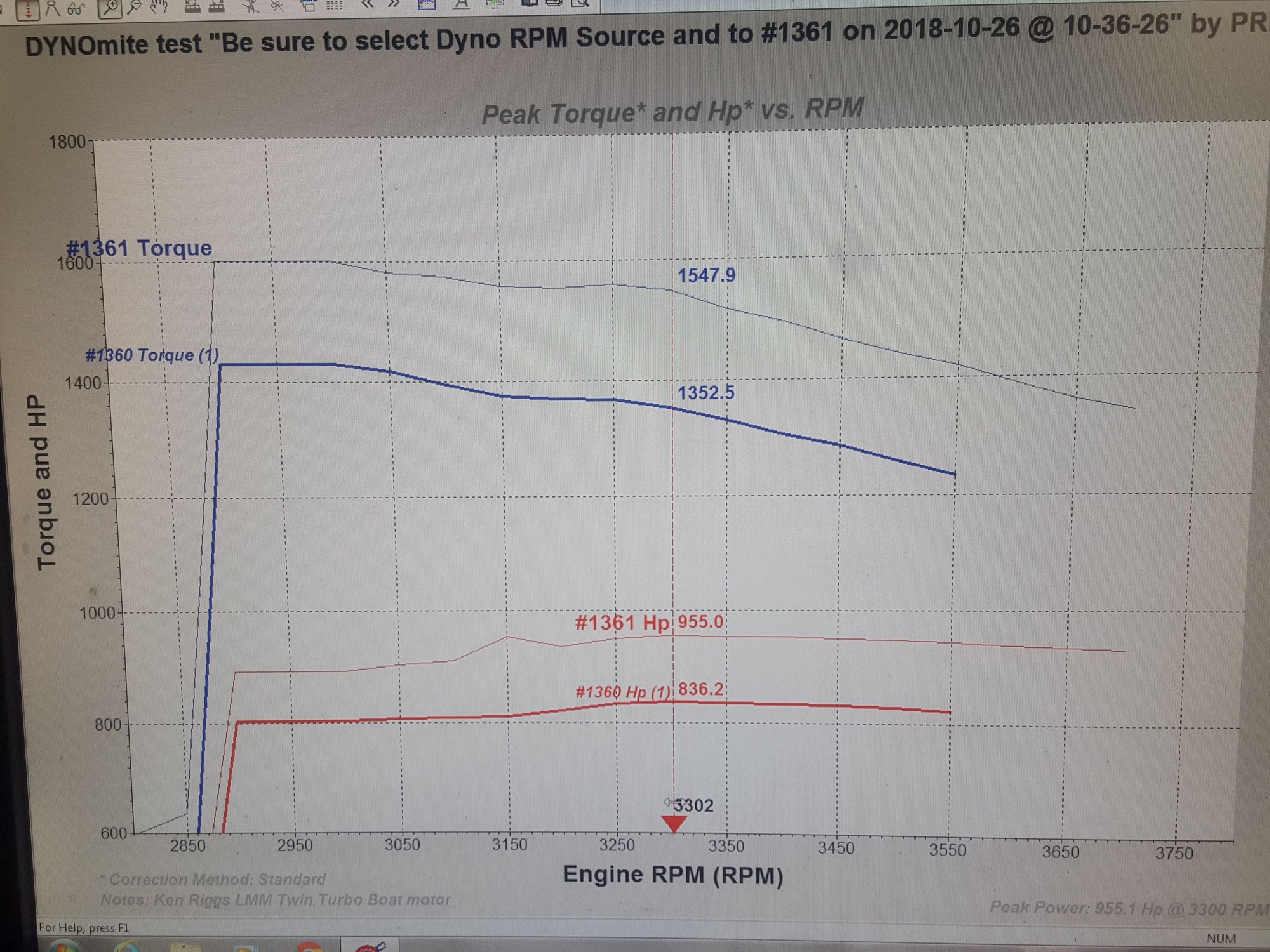

Getting Back On Tack
Just finished a month long dyno testing session on the pair of T-1000 marinised Duramax engines I posted video of above back in April. These engines are the conclusion of all the posts above. Goal being to see if these 403ci V8 engine can live happily making over two horsepower per cubic inch within a marine application, using the best hardware available today. This includes testing those beautiful Banks marine intakes, that I have yet to see pictured in a boat. I'm glad to say, the results look very promising.
Also have updates on cooling system options, along with some strange quarks we ran into during testing to share. For now here's some data and video from our testing sessions.
