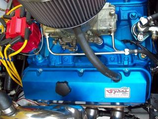

I have 1 of these

Originally Posted by ezstriper
I had a marine 177 setup a few years back, came with that, but I never used it, used a crossover and a billet housing and cleared fine
Do you have any pictures of the T-stat housing you used?

here you go, hard to see, second pic is same housing on a different engine and a thermostat w/bypass installed, did not run that way with the 177
