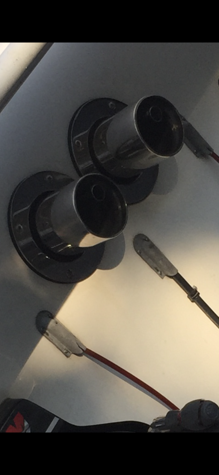

Here are some pics from custom exhaust I had made last year.

Nice looking setup. How loud is that?
