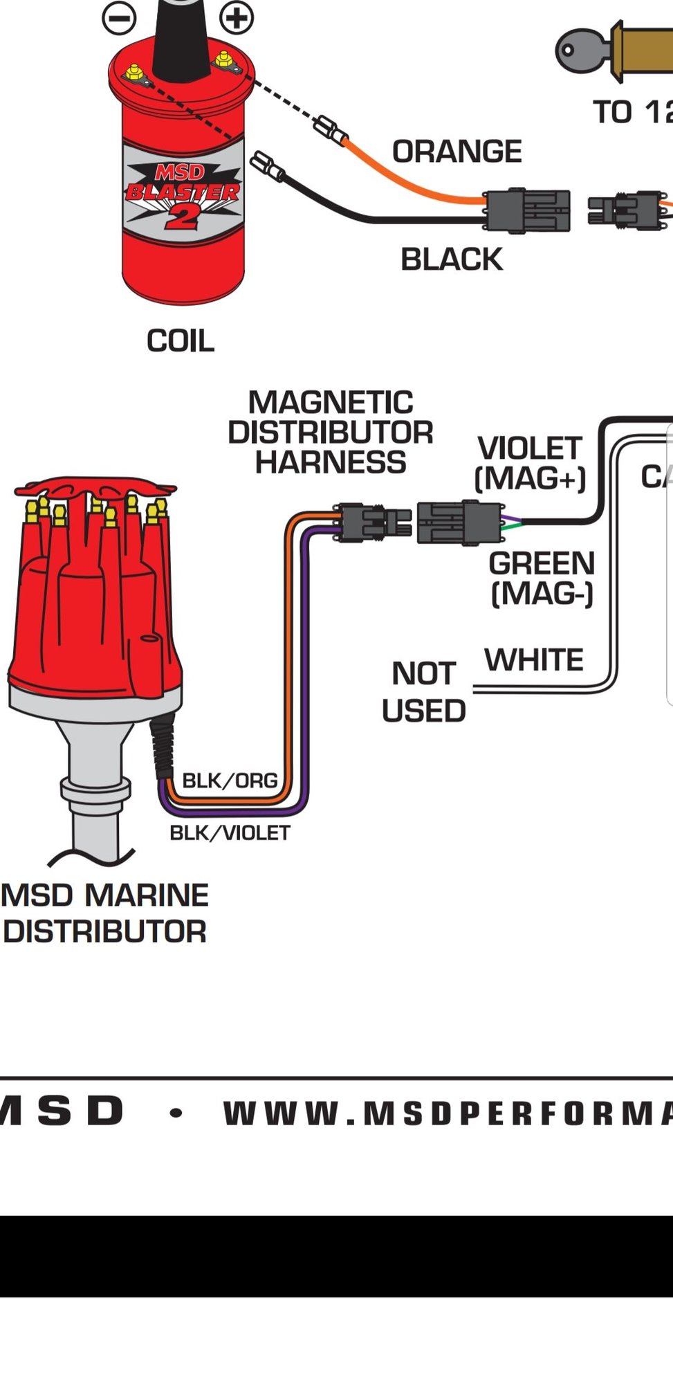

MILD THUNDER is offline
Old 09-08-2018 | 08:50 AM
  #59
Joined: Jul 2004
Posts: 11,332
Likes: 73
From: chicago
See how the wire colors switch at the distributor side? Purple becomes negative on the distributor side.

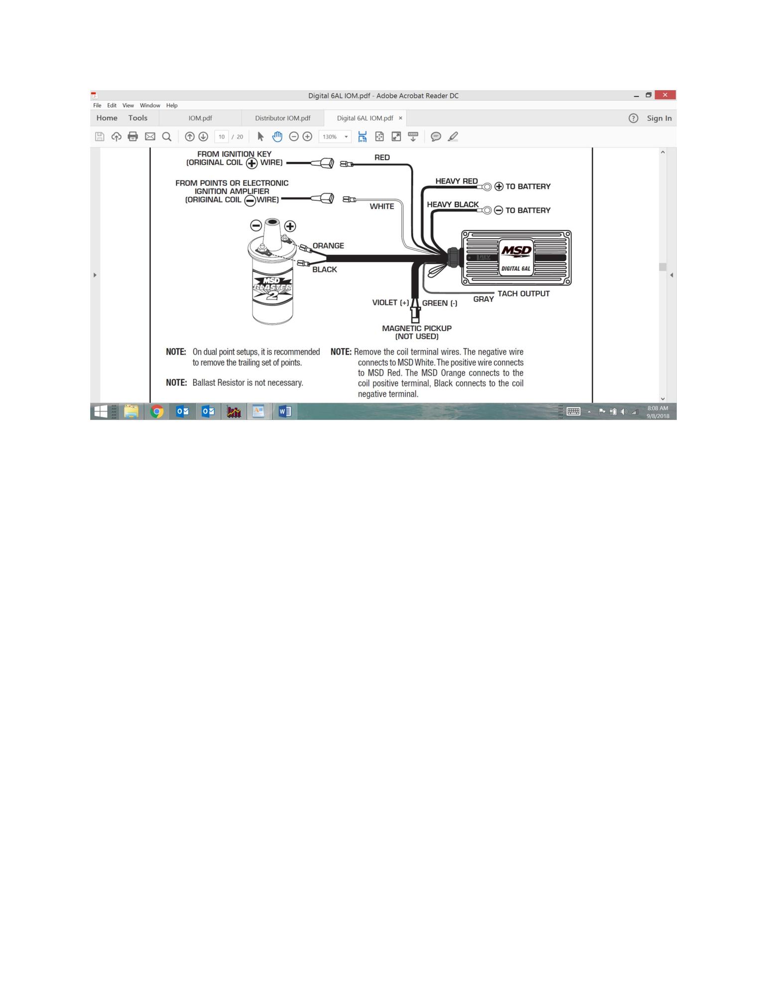

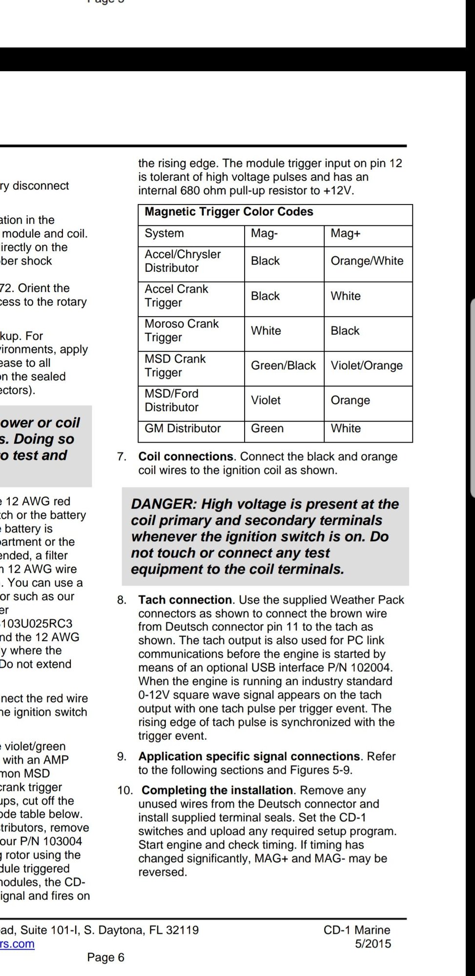

Old 09-08-2018 | 08:54 AM
  #60
Joined: Jul 2004
Posts: 11,332
Likes: 73
From: chicago
