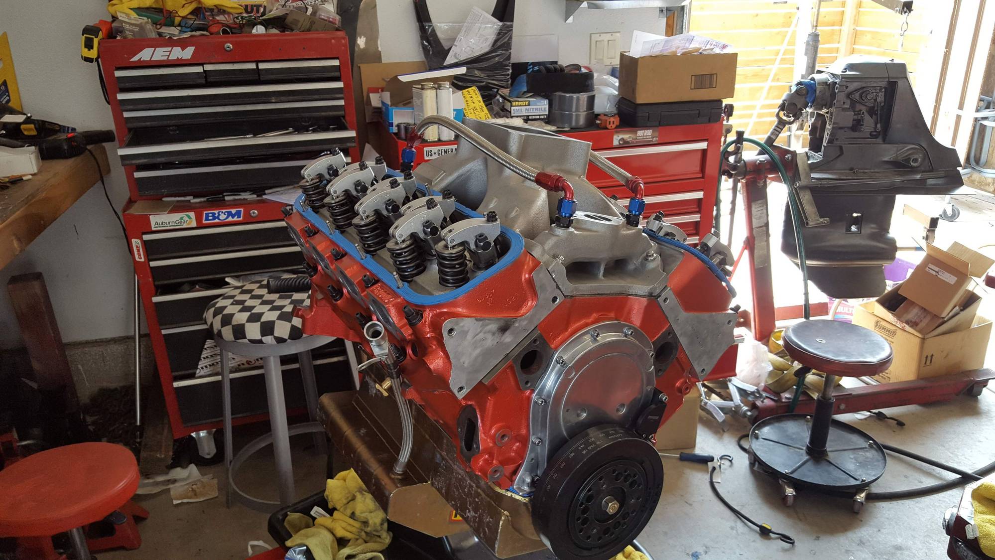

Also run the same brand on my Mark IV 555. Nice piece for the price.https://cimg1.ibsrv.net/gimg/www.off...9555025409.jpg
