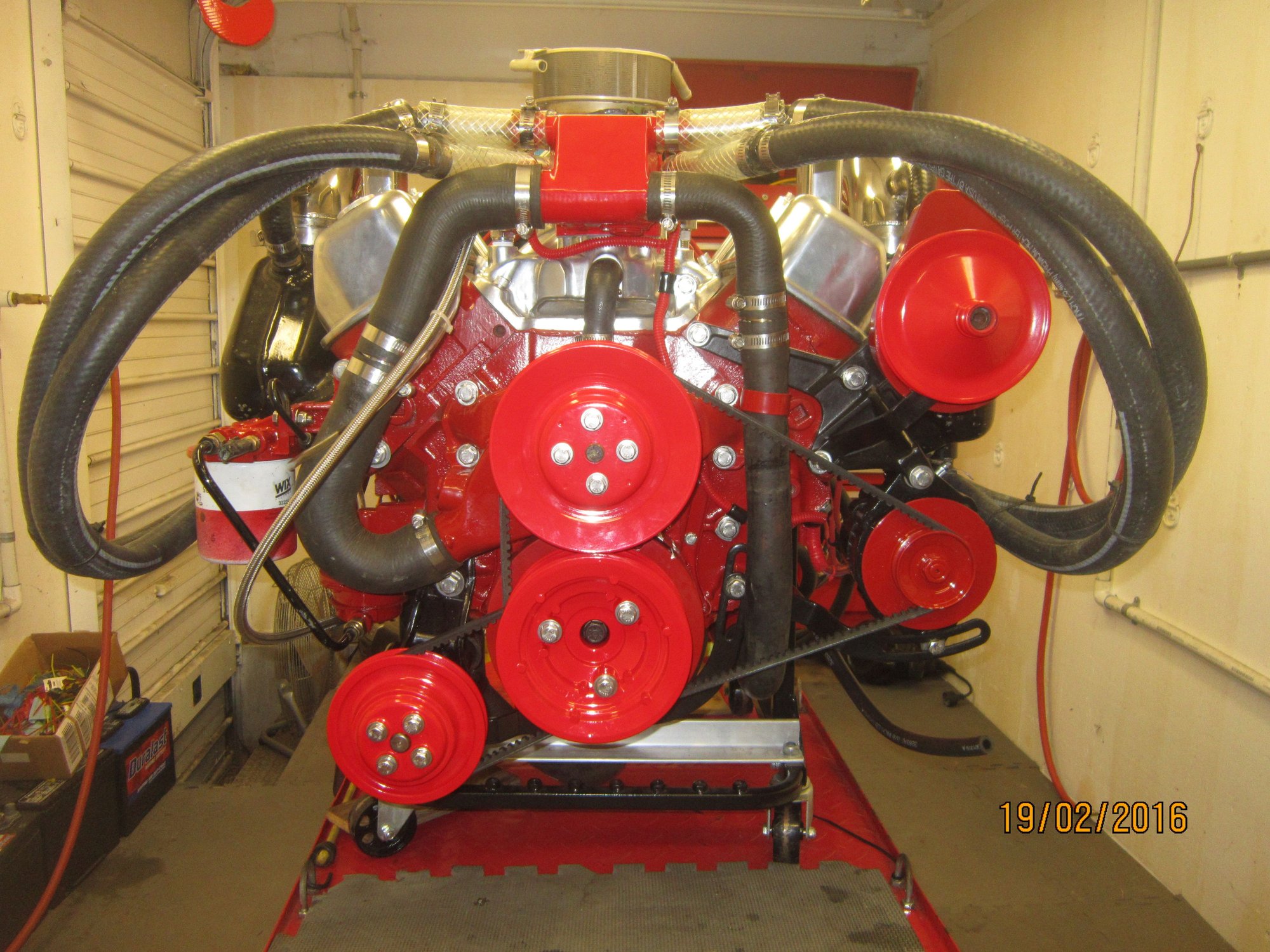

Baja, I had the same problem with my Hardin Marine Intake. After exhausting all resources I found Hardin made a stainless barb/barb fitting and used 2 standard hoses. I used the upper from one and the bottom from the other cut to length where the clamps were in a convenient location. Ended up doing the same for the hose from the oil cooler to the t-stat housing. Here is a picture. Hope this helps.

That doesn’t look so bad at all. What size coupler did you use? 2”?

Hardin has the one for the recirculating pump hose, it is not in the catalogue so you need to call and ask it's stainless. The one from the oil cooler I picked up on line and it is brass that one is 1-1/4" I believe. The one from Hardin I am not sure of the size you will need to measure.

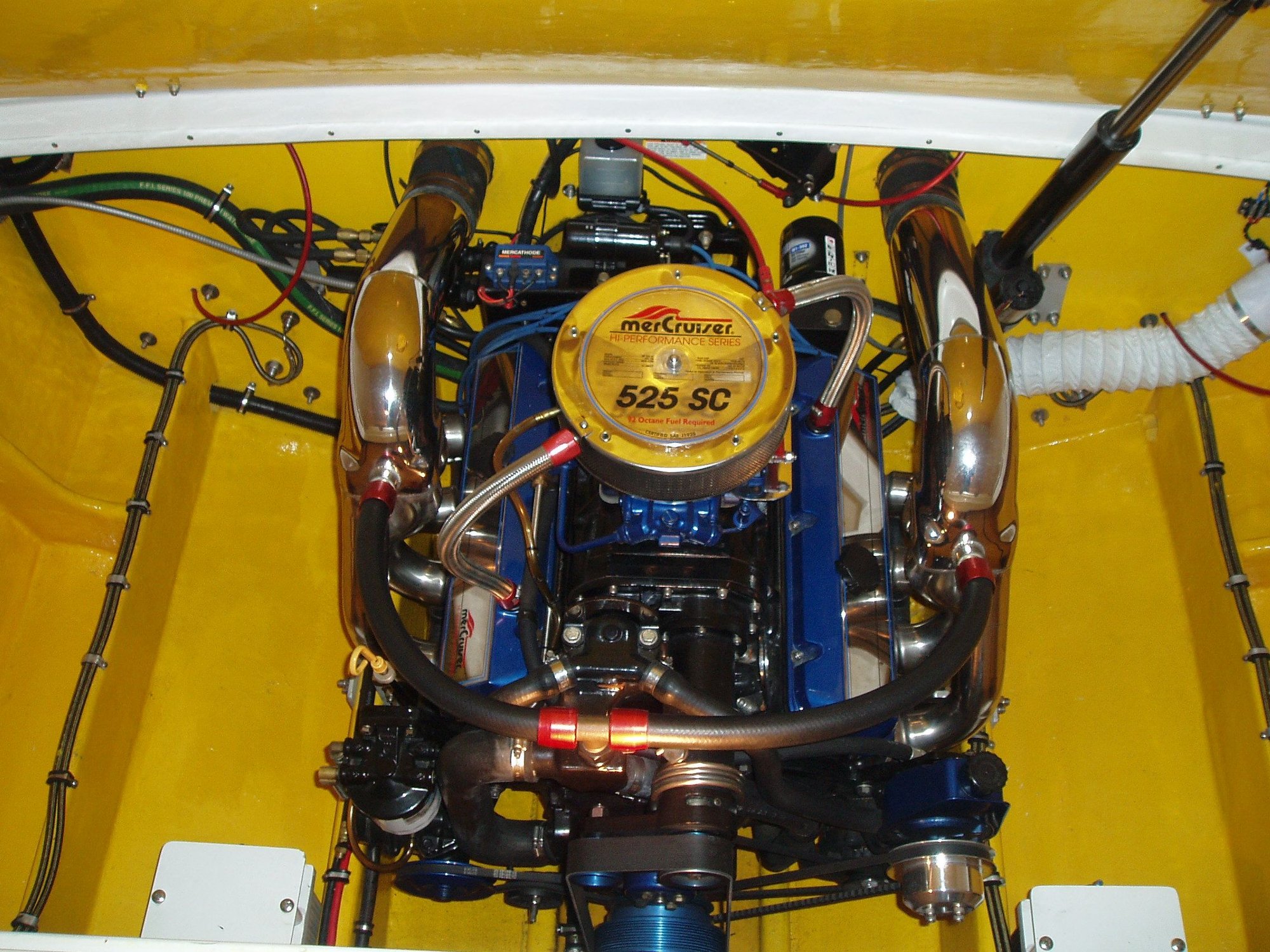

Get a hose for a Merc 525SC. I believe they are a couple inches longer.
Hard to tell in the pic, so maybe have someone verify.
I believe Rambunctious posted that he is winterizing his 525SC's tomorrow, so maybe he could measure for you.

A 525SC hose worked perfect on a 7.4L where we replaced the standard cast iron truck manifold with a Edelbrock RPM Air Gap.

Perfect. You and griff had the answer I was looking for. I figured some engine had to come from the factory with the taller intake I just didn’t know which one. I may use the Home Depot nipple trick to get me through the weekend.
