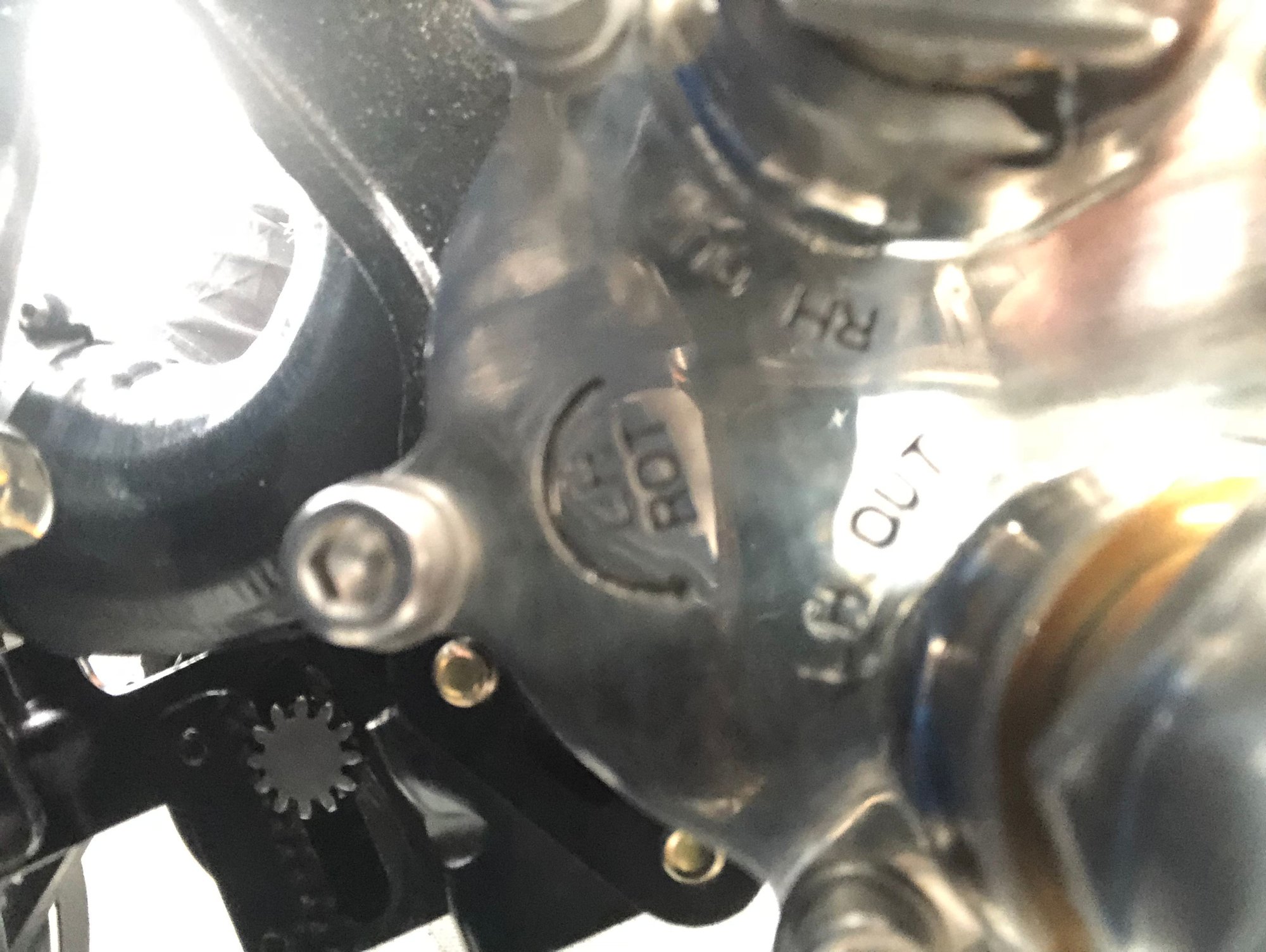

I put on a flush kit a couple seasons ago but that plastic valve has always made me a bit nervous bouncing around the bilge, and someone mentioned that a simple stainless tee works just fine in its place.
Standard Bravo sea pump setup with V belts turning clockwise looking at the front of the engine.
Do you have the hoses connected to the pump housing for a LH direction?

Yep. I even went to the trouble of switching the hoses and all it did was suck out what water was in the system

I tried back flushing all of the lines and all was clear. I closed off the flush hose and went back to the muffs with no better luck. I pulled the hose coming from the pump at the thermostat housing and ran it and only a trickle - maybe a pint worth a minute was coming out. At this point all that is left is trying a new impeller. *shrug*

Well, I took it apart and the impeller looked virgin, but there was still a lot of dish soap in there. I wiped it out, slathered the impeller in marine grease, and voila - pumps like a champ. Thanks for everyone’s input!
