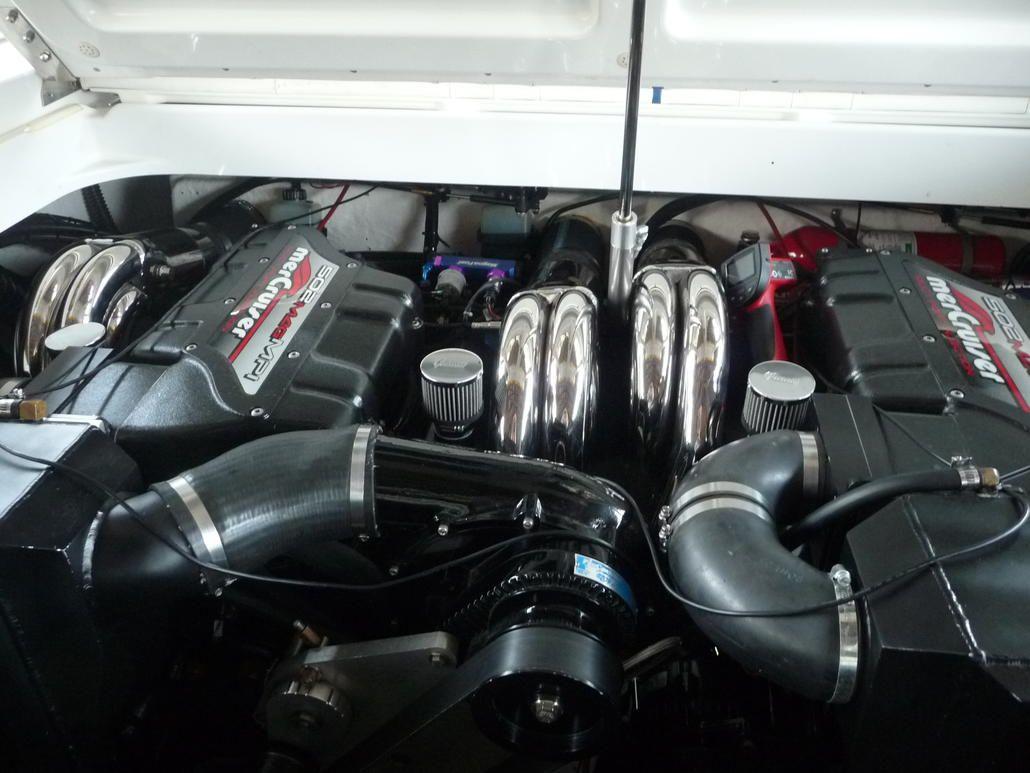

I have a pair of mildly built 502's fresh from the machine shop.
Bill Jones did the heads and intake porting, running a Bob M Cam with a crower roller rocker set up with rock stud girdles. MLS head gaskets with a full treatment of ARP fastners.
I am running a full Young Performance Marine fuel system, modified fuel rails, A1000 pumps, 1 to 1 boost reference regulators, etc.
Anyone have any tips on programming the ECM? I have a tuner that will tune these utilizing MEFI Burn and wideband O2's. Whats a good starting point?
