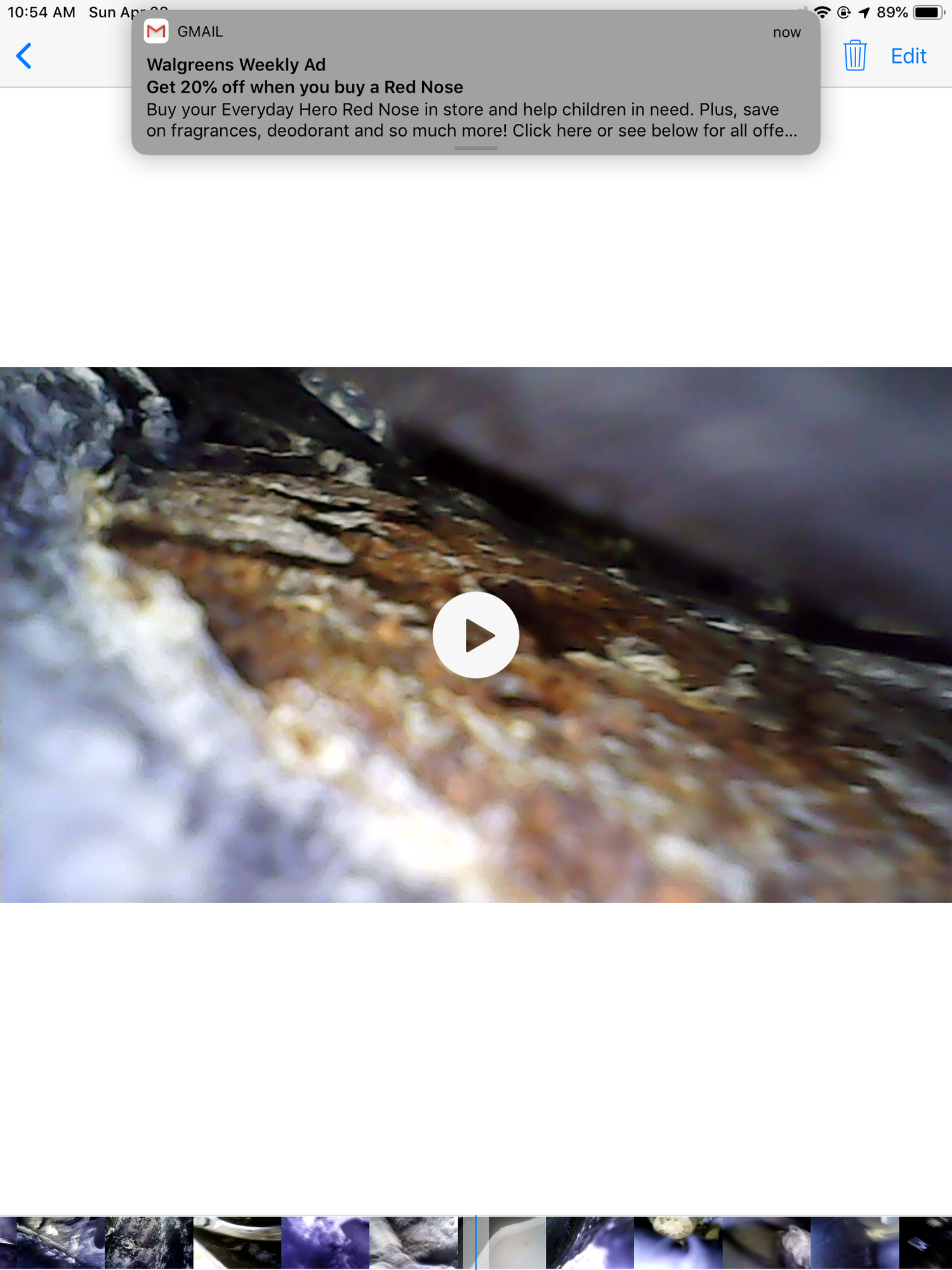

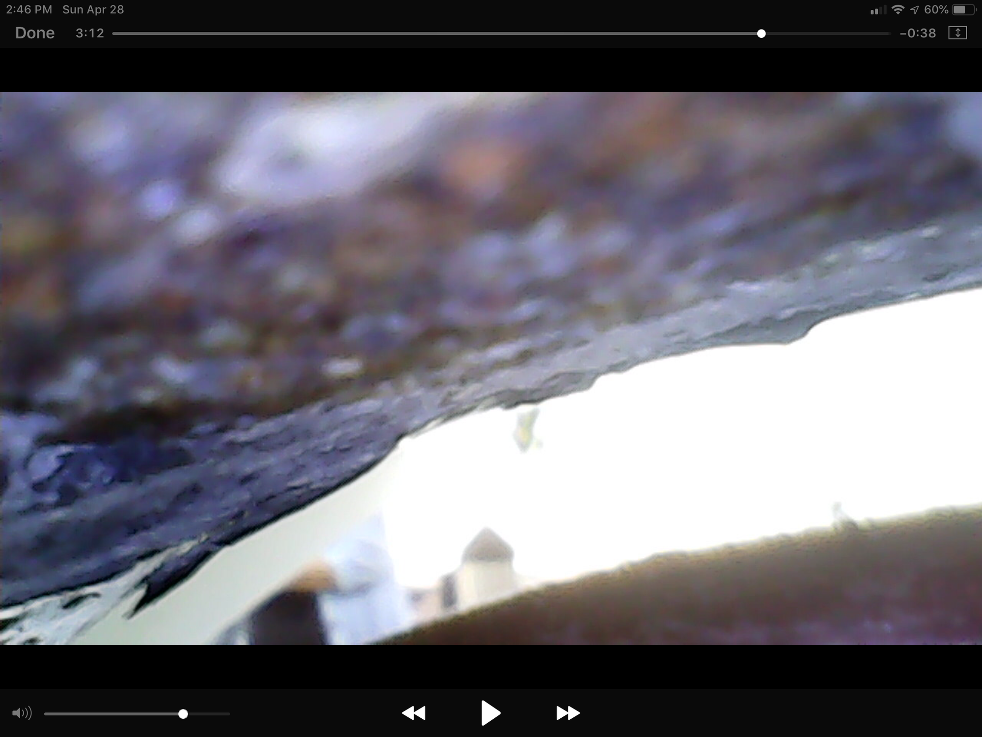

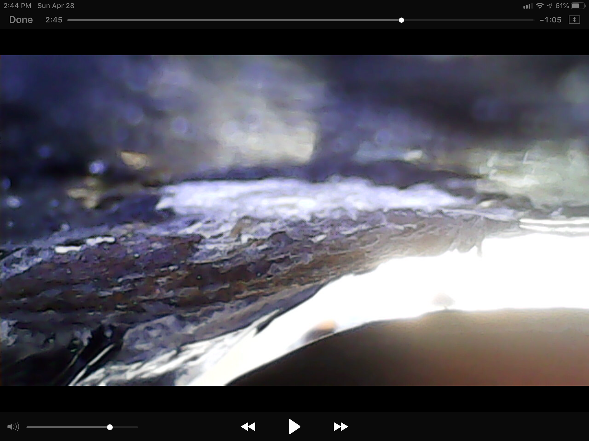

Are the gimbal rings made of steel, I think it my worst corrosion/electrolysis problem impacting my pivot seal....https://cimg3.ibsrv.net/gimg/www.off...4be87becc1.pnghttps://cimg4.ibsrv.net/gimg/www.off...13e1b9866e.png

The HP assembly has a stainless ring. I live in swfl also it’s good practice when your done flushing/washing /cleaning to reload the salt away cup and spray inside the gimbles really good. I do that since you can’t actually reach in there with a rag and wash it. Then crc656 everything really good.
1989mach1 04-28-2019 07:04 PM
Looks like it might br time for upper pins. Just did mine last winter and went with the stainless ones hoping to not have to do them again. Good luck
