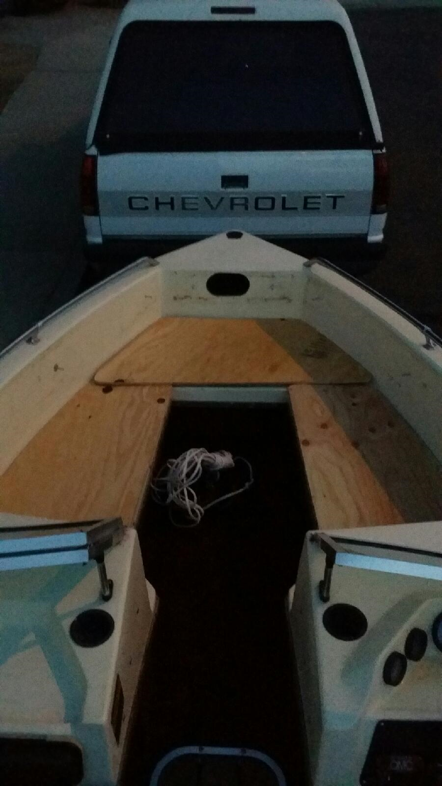

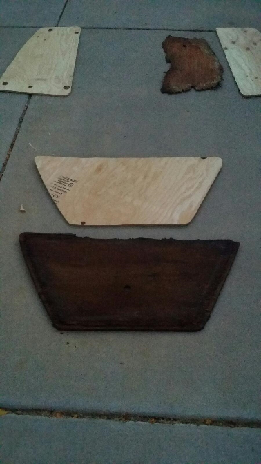

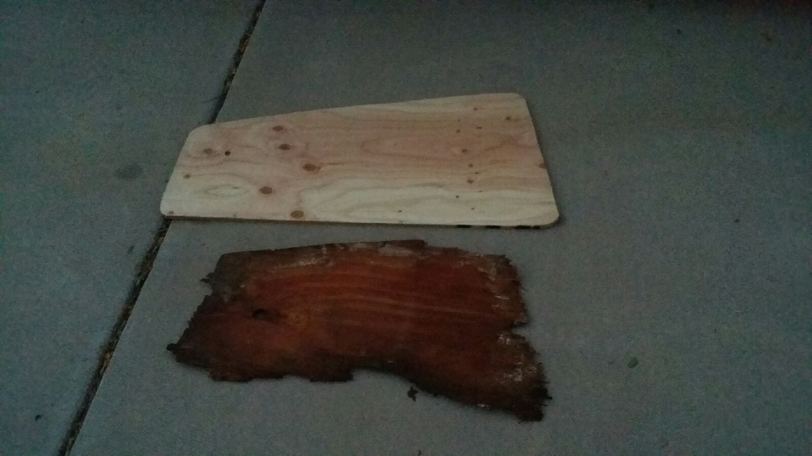

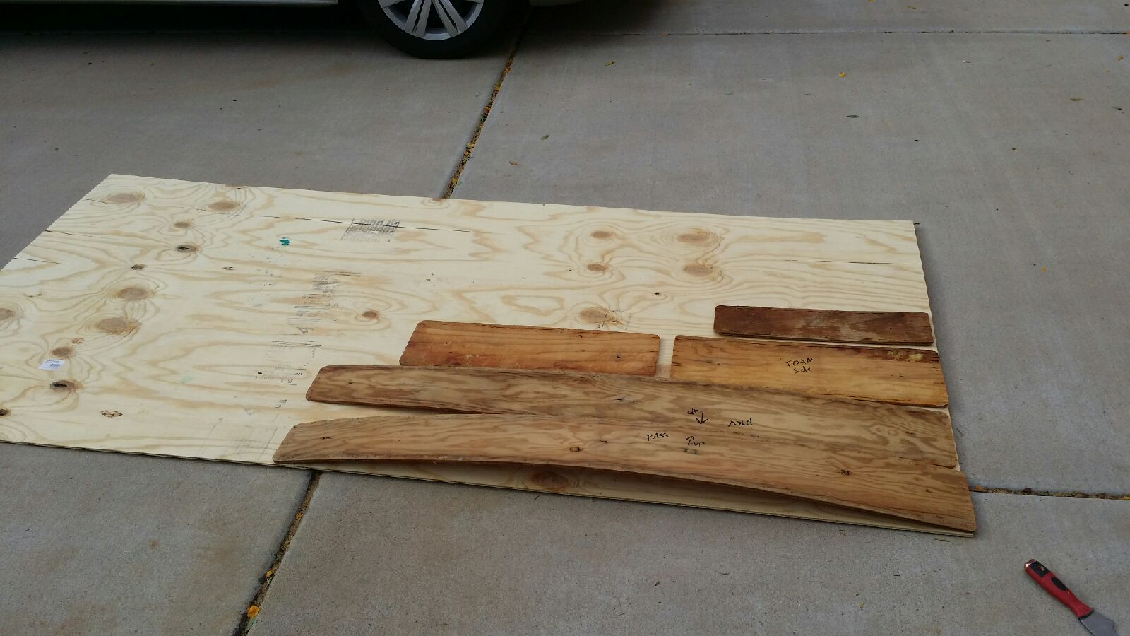

Well I started cutting new wood this weekend. These pieces I could trace out.
The old and new wood side by side. was a little hard to trace....

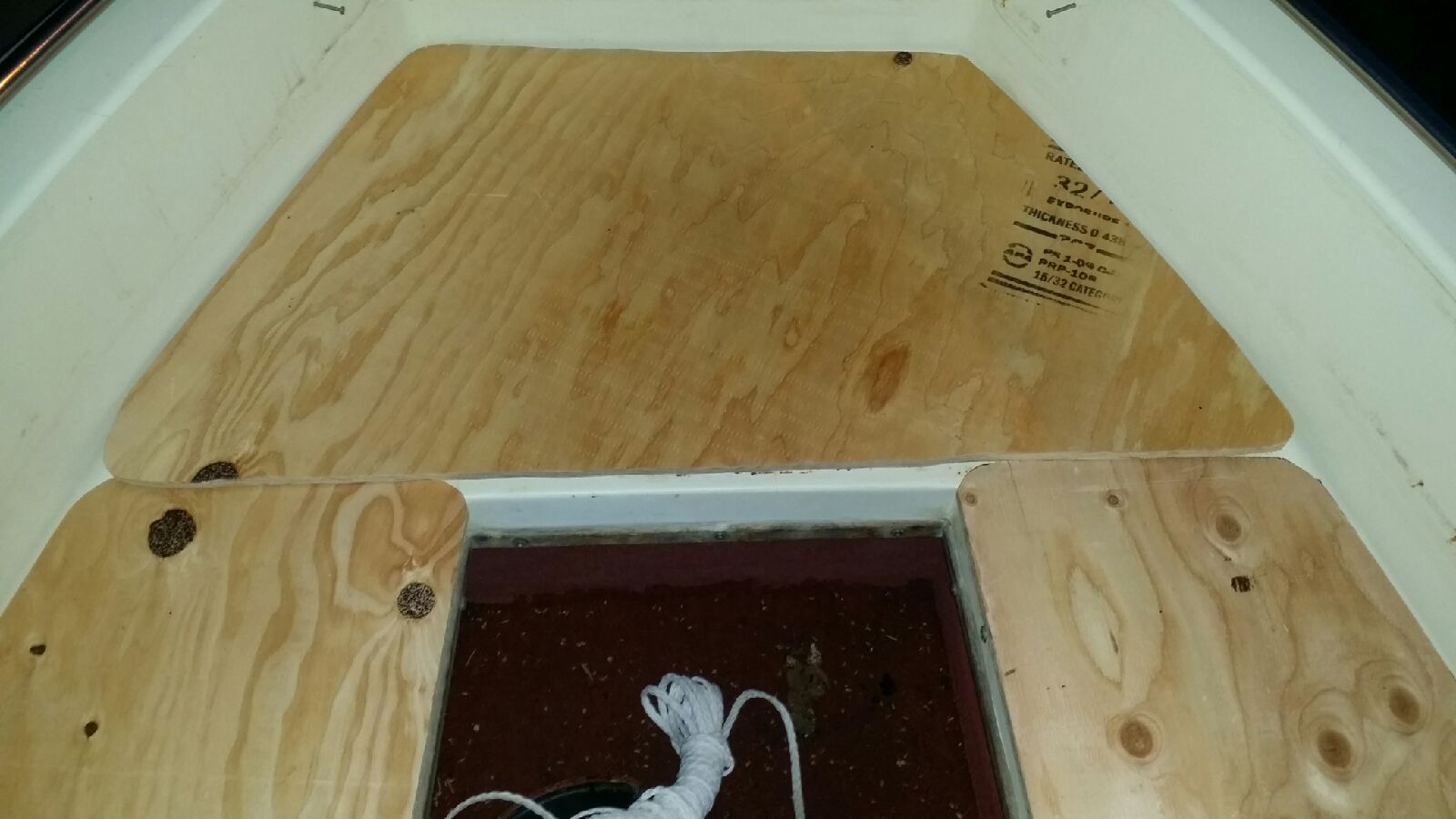

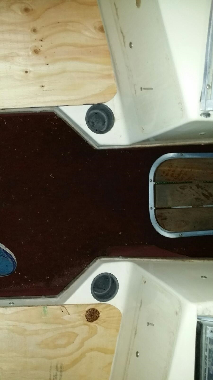

all the pieces are cut. (1/4 for sides & 1/2 for seats)
test fitting
some overlapping i need to fix, it think. better too big vs too small. gonna trim off of the bow piece i think as it already has a slight F*ck up in it.
both boards are the almost the exact same size (clamped them together and did the edges and turns) one covers the cup holders a little

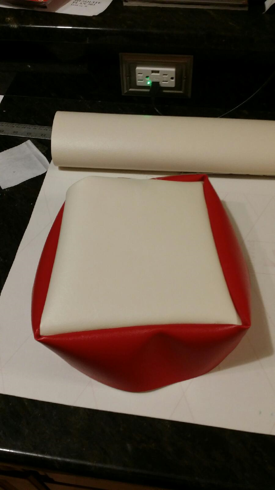

So I'm going to stick with the current color scheme of red/burgundy and an off white
what peoples thoughts on this material with a pattern. this would be on the edges of the pads and part of the bench seat where one would sit, everything else would bee an off white.
I think its kinda cool looking and not that expensive. Was thinking a textured material might hide flaws a little better since i'm amateur at this doing it DIY style (kinda like texture on drywall..)

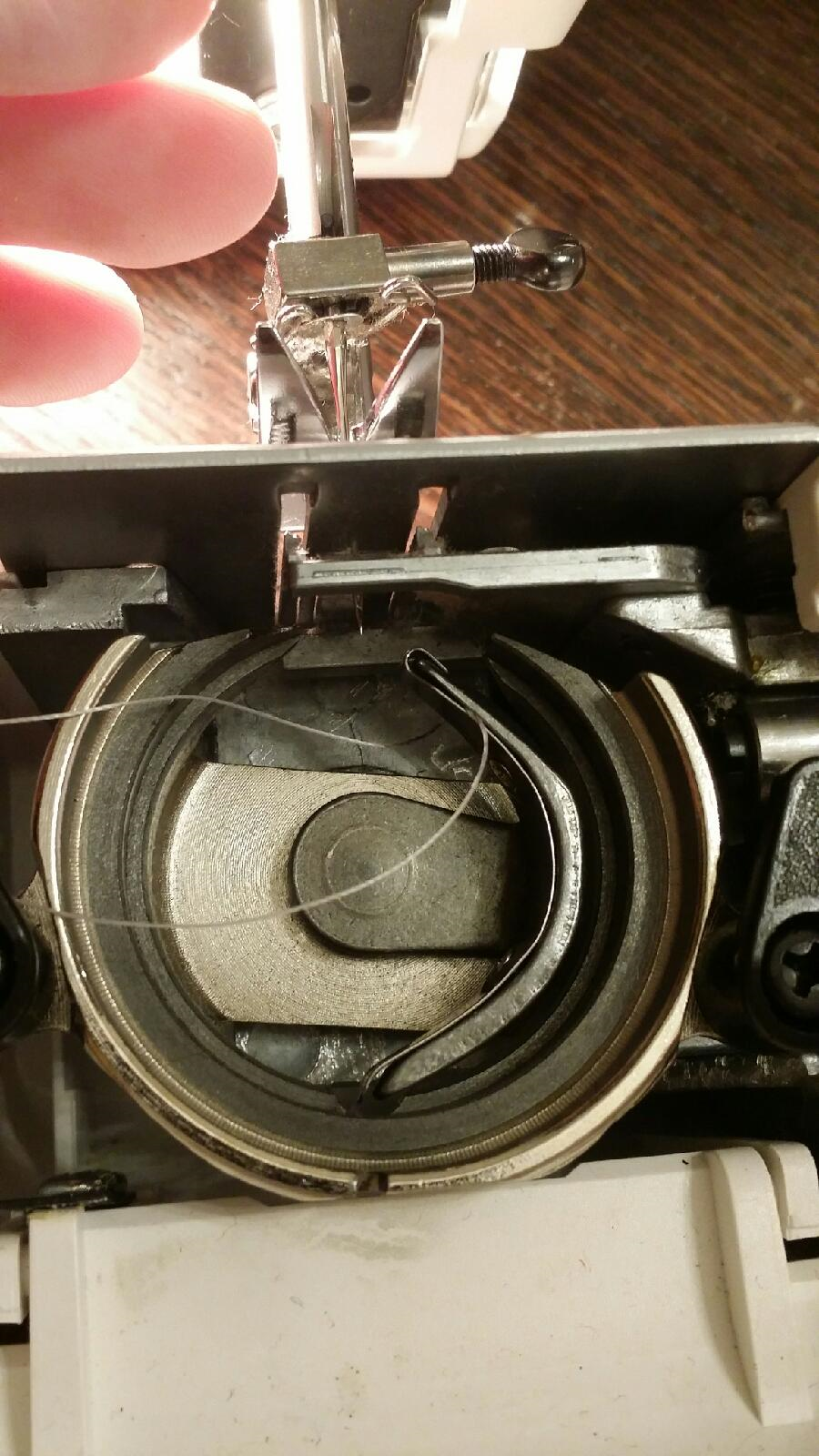

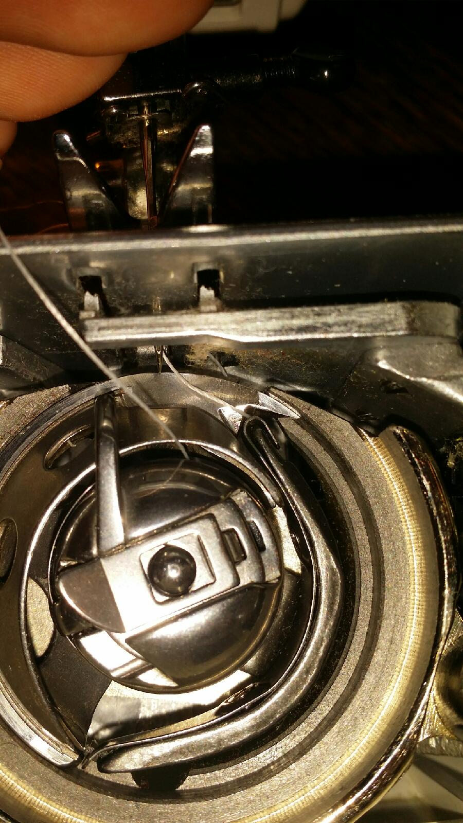

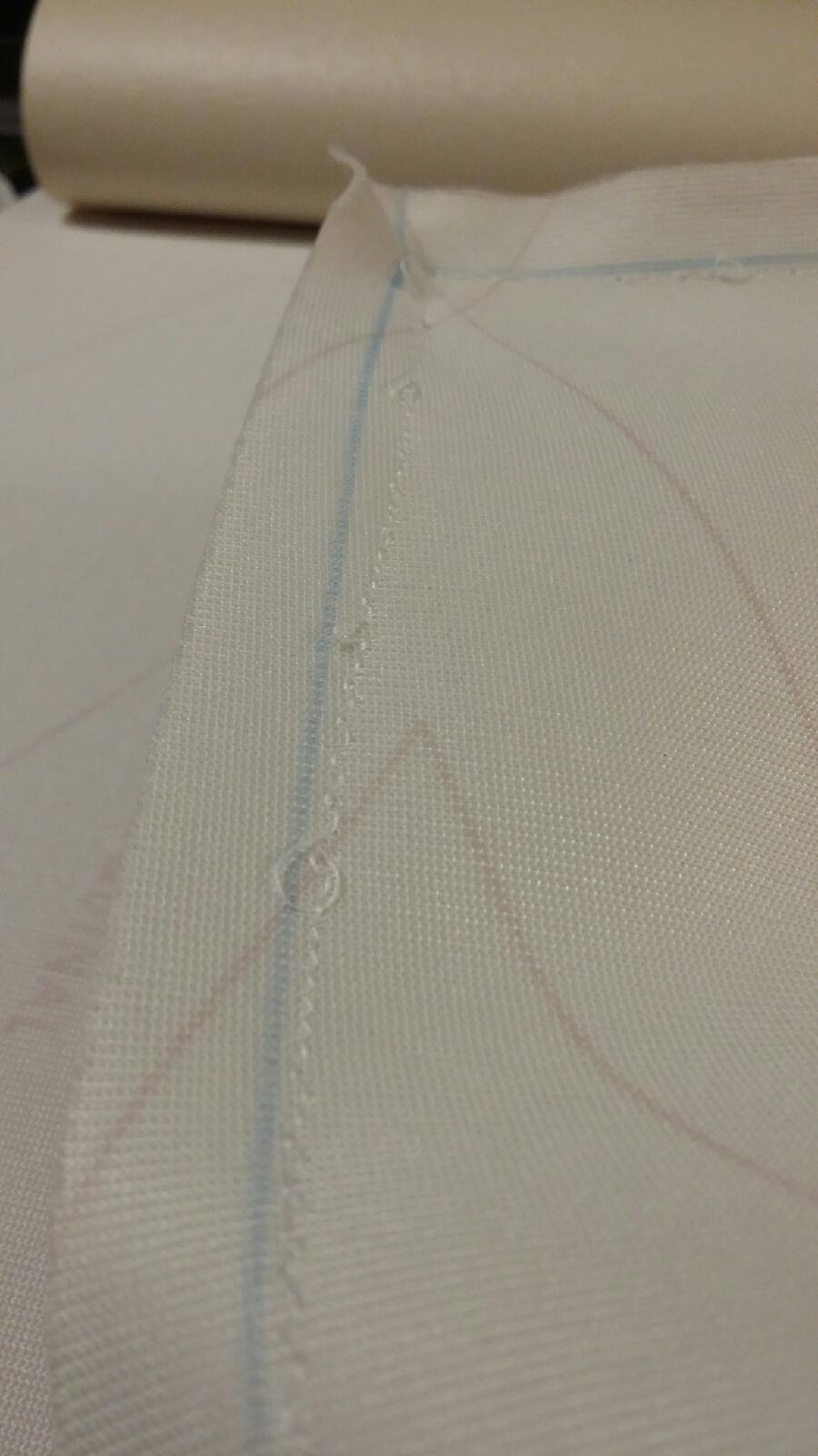

Bought a cheap machine off of offer up the other night for $60 then picked up some material to practice with. I tried the french stitching, seem the max length on the machine is closer together than I want.
practice and the machine jammed.
French stitch
bobbin side, keep getting loose string and i dont know why, also not following my line and over shooting
but it leads to a jam like this.
noticed the thread keeps getting pinched between these pieces and it doesn't feed anymore then jams
how it should look/feed
French stitch
