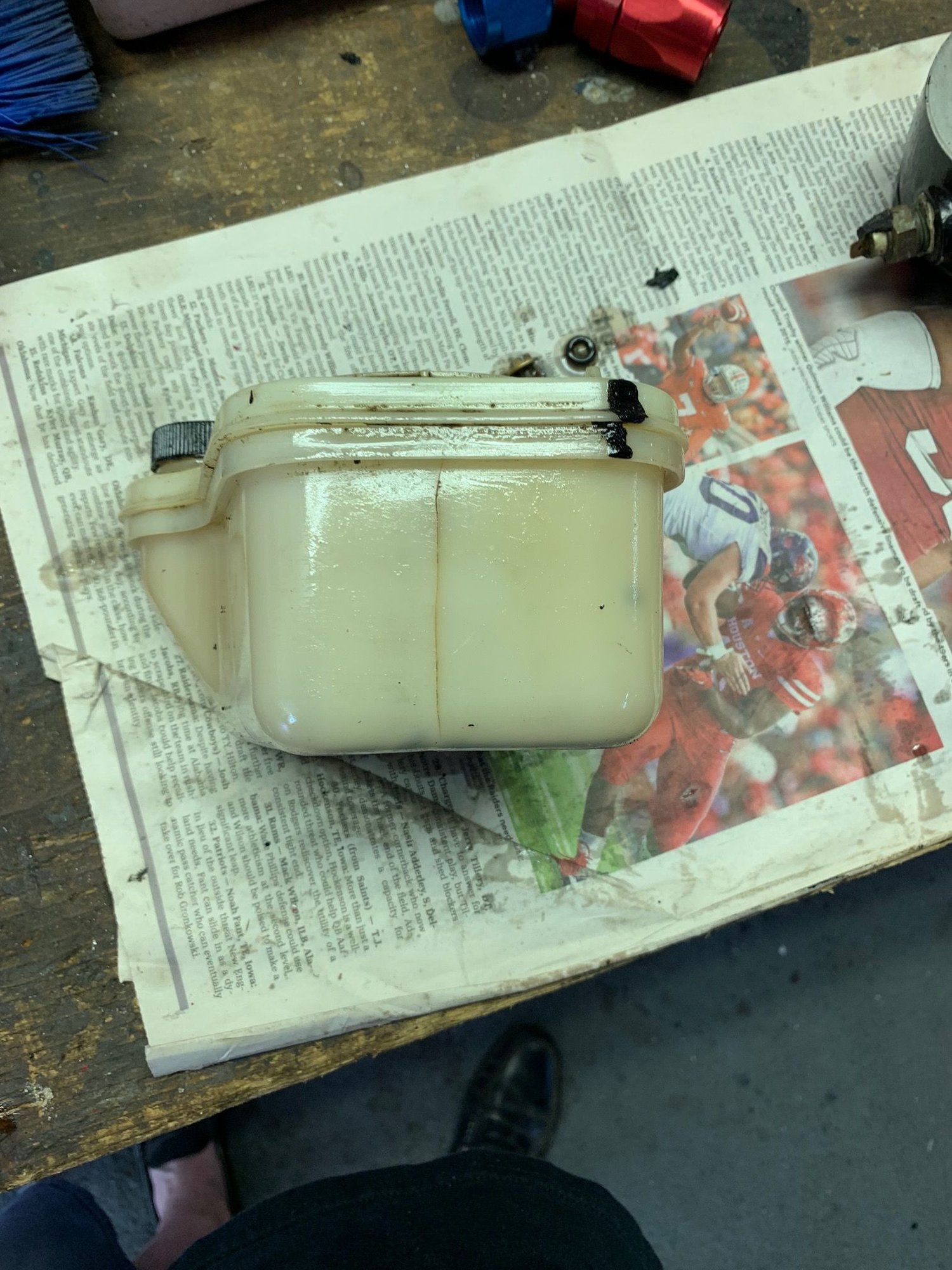

i have discovered that my port trim pump has a slight leak.
it does not look like lines, the bottom of the fluid reservoir is wet.
after looking at photos, looks like there is a screw in center of reservoir? j1171 pump trs drive
maybe this is leaking??
will address this today.....any ideas??
thanks............

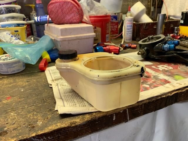

well , its a cracked fluid reservoir ....
i read or saw , it stated online somewhere that the tanks can crack.
new one 33 bucks............................................. .

pretty common. I have replaced a dozen or so of them. they split out at the bottom screw lots of times or get old and warp so they dont keep pressure on the seals.
