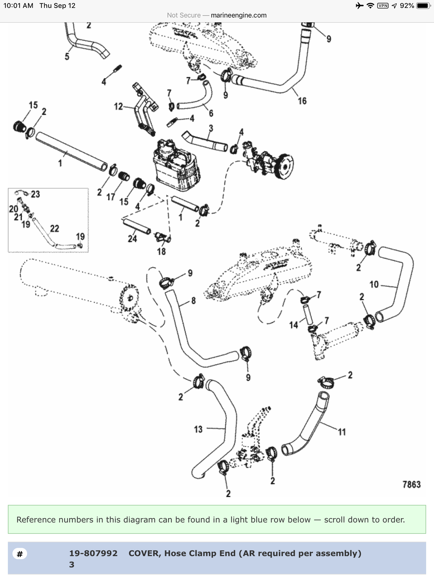

mercruiser 8.1 getting EMCT warning both manifolds. Due to Stainless Marine suggestion the hose between oil cooler and manifolds were deleted. Is this enough to cause low flow and overheat. Pumps all new, water pressure 15 psi at 3000rpm.

Hose cut out is #14 on diagram.
That's just for draining during winterization. Would look a little closer if both had the same issue

Just to clear hoses # 6 and # 14 leaving only main supply line for water to the exhaust manifolds on starboard engine, the one running hot. Port engine has original hoses and connections running normal. Starboard engine at idle was running and risers were just warm to the touch. Engines temps are balanced and normal.
