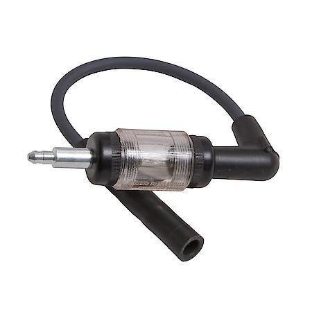

Sure sounds like a My Spark Died coil issue. Work when cold, die when hot. Inline spark testers like $15. My fav and found every part store in person and online. Lisle
