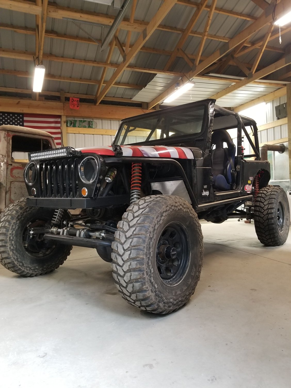

I'm a big rock crawling guy, and I sure do love the fuel injection on my LS 😁
https://cimg1.ibsrv.net/gimg/www.off...5522f8f54f.jpg
