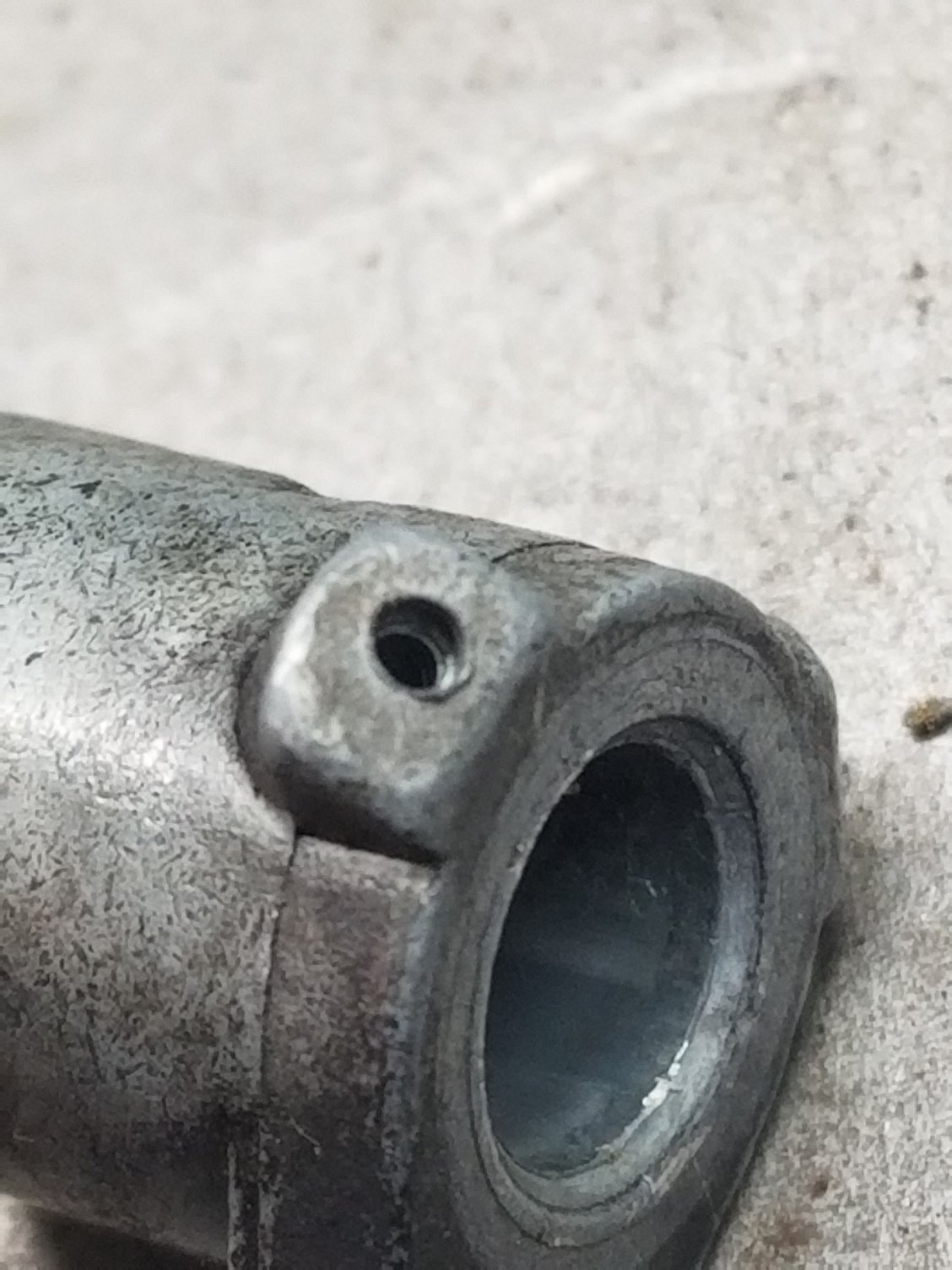

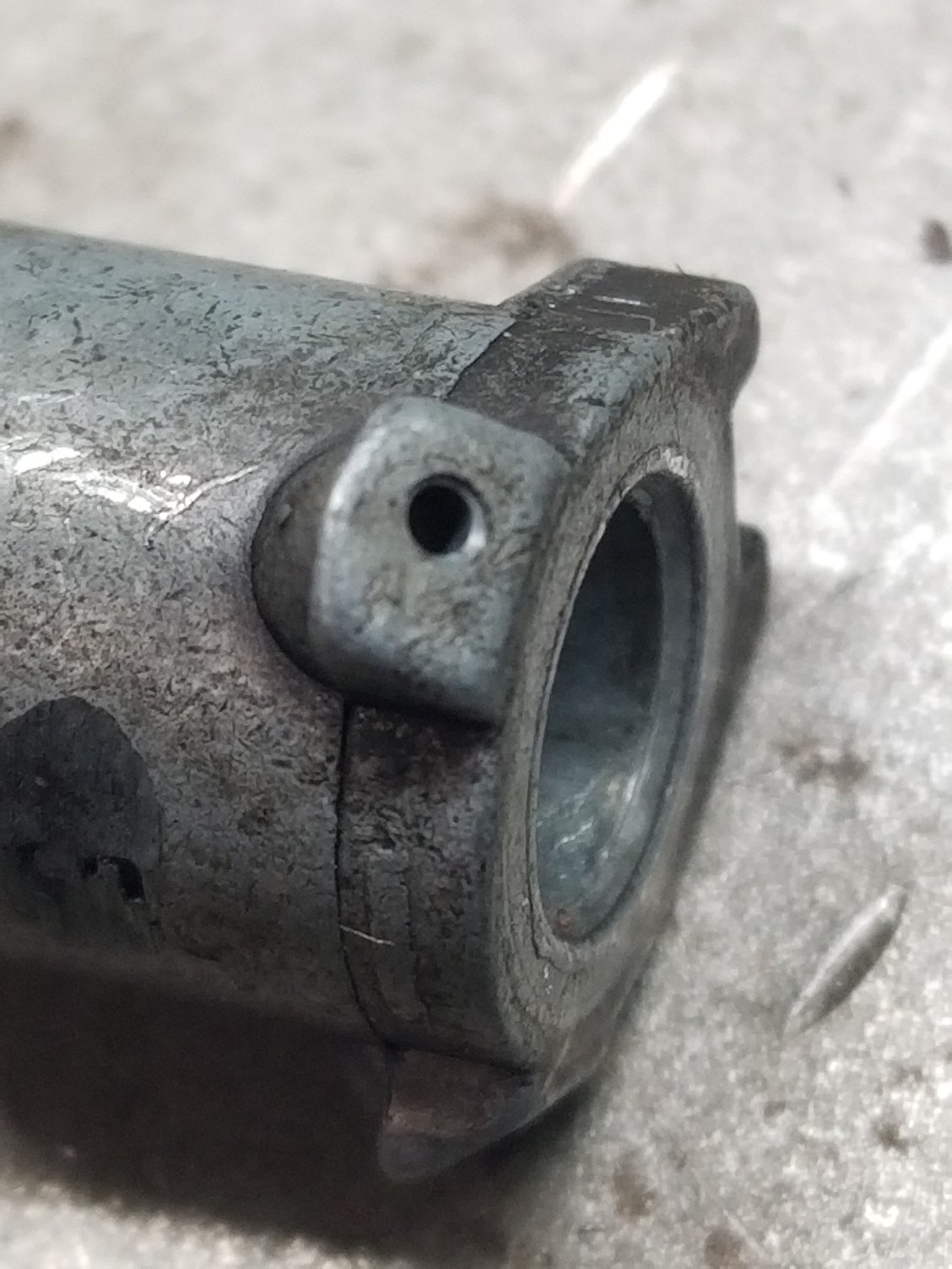

-attached are pictures of the accelerator pump nozzles, it looks like they may have been attempted to be drilled out? https://cimg6.ibsrv.net/gimg/www.off...f6cda782e7.jpg
https://cimg5.ibsrv.net/gimg/www.off...0bcf6bf22d.jpg
Crude Intentions 11-29-2020 06:48 AM
Did you ever pull number 1 plug. And make sure dizzy was dropped right? Have you ever actually seen this motor run right? If not I’d go all the way back to square 1 and start over. You shouldn’t be on accelerators for idle. Do you know if it’s the stock cam?
distantthunder 11-29-2020 08:06 AM
I would disconnect your throttle linkage, remove carb, set secondary transition slot to a square, reinstall the carb, loosen Idle screw all the way out. Leave the throttle disconnected and start the engine. If there is no change, I would think it is timing related and would loosen the distributor and rotate it to retard the timing. Something isn’t adding up here.
