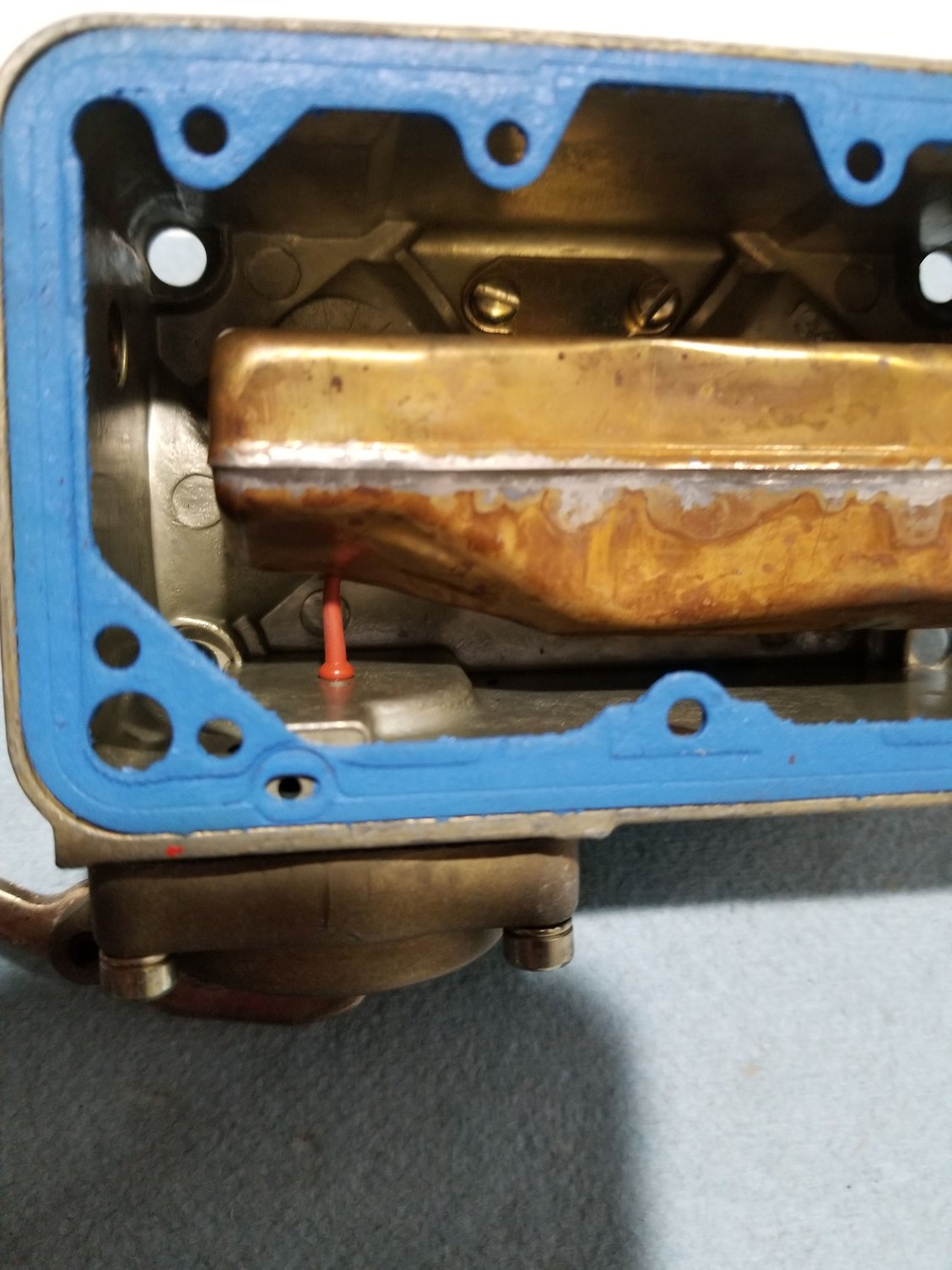

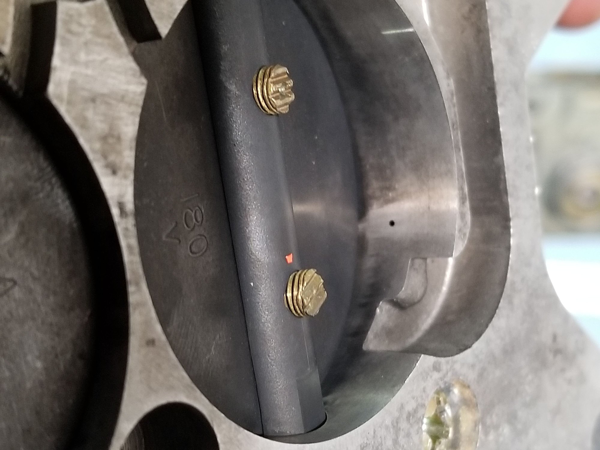

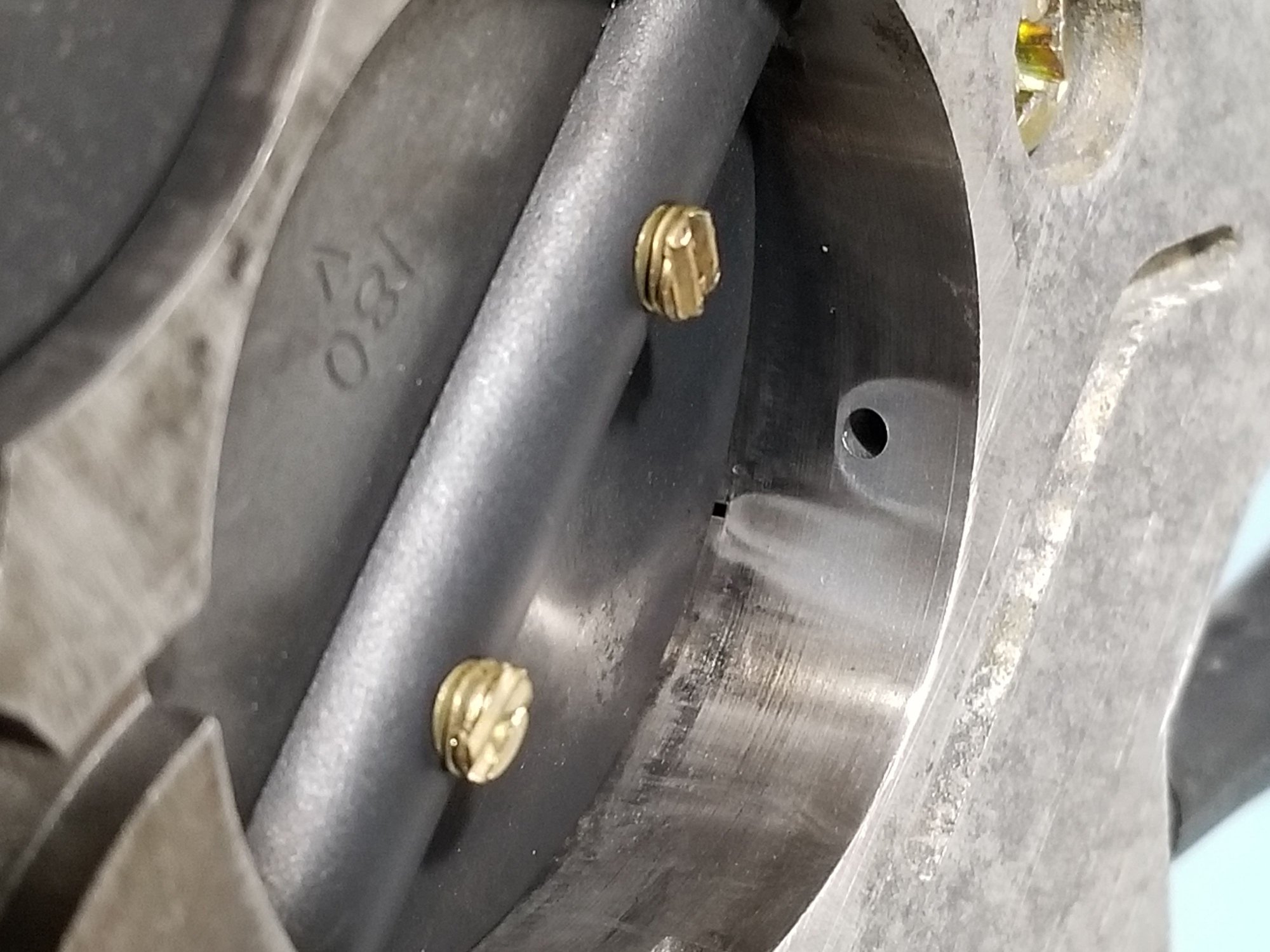

Couple things of concern came up when I was disassembling the carb. The first thing was that there is zero transfer slot showing on the secondary side.

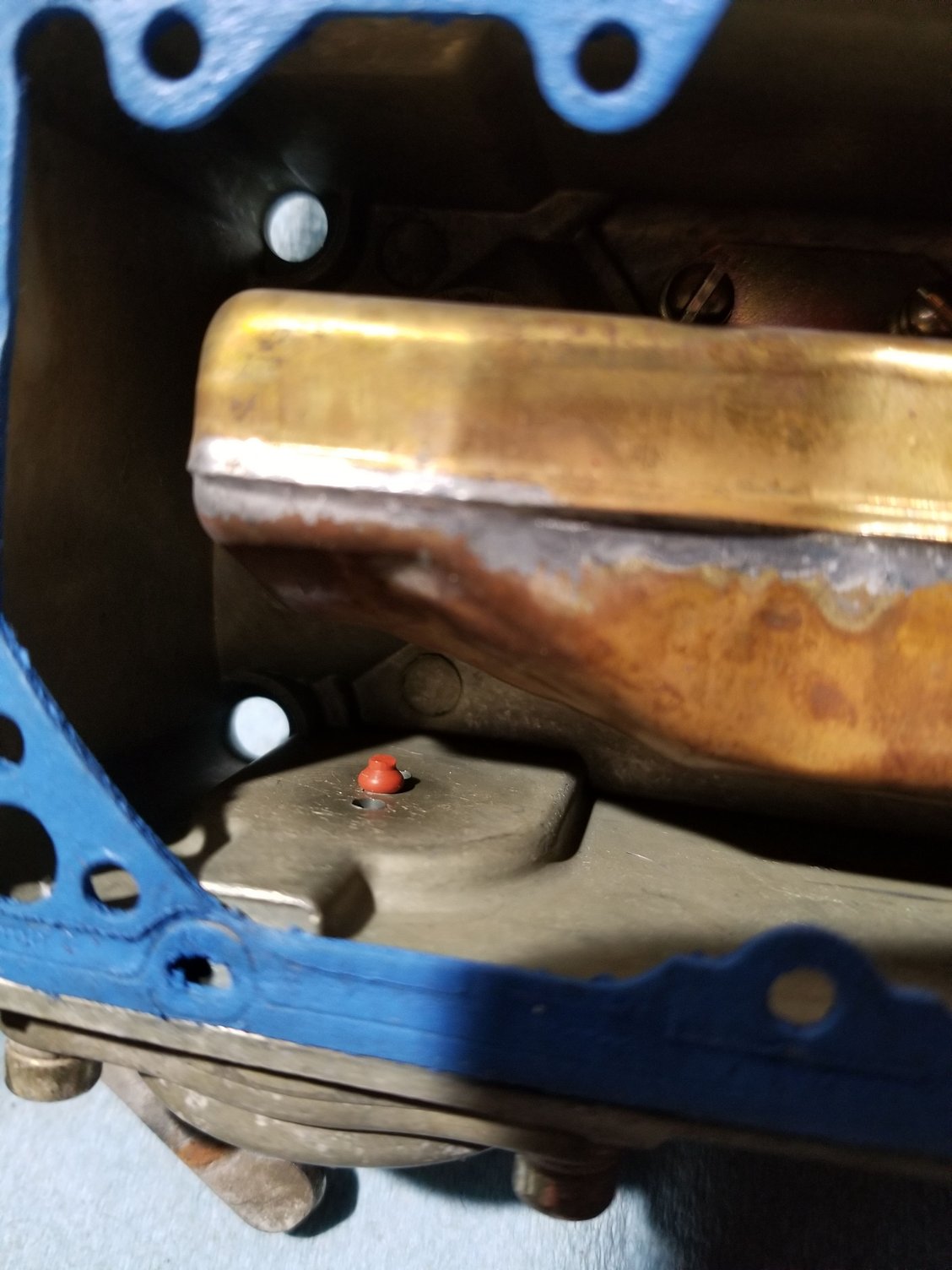

And then the accelerator check valves were different. The shorter one is on the primary side, they should match right?

My new rebuild kit comes with 2 new 6.5 power valves which are the same as what's currently in there. Im wondering if when this carb was rebuilt new power valves were not put in.
