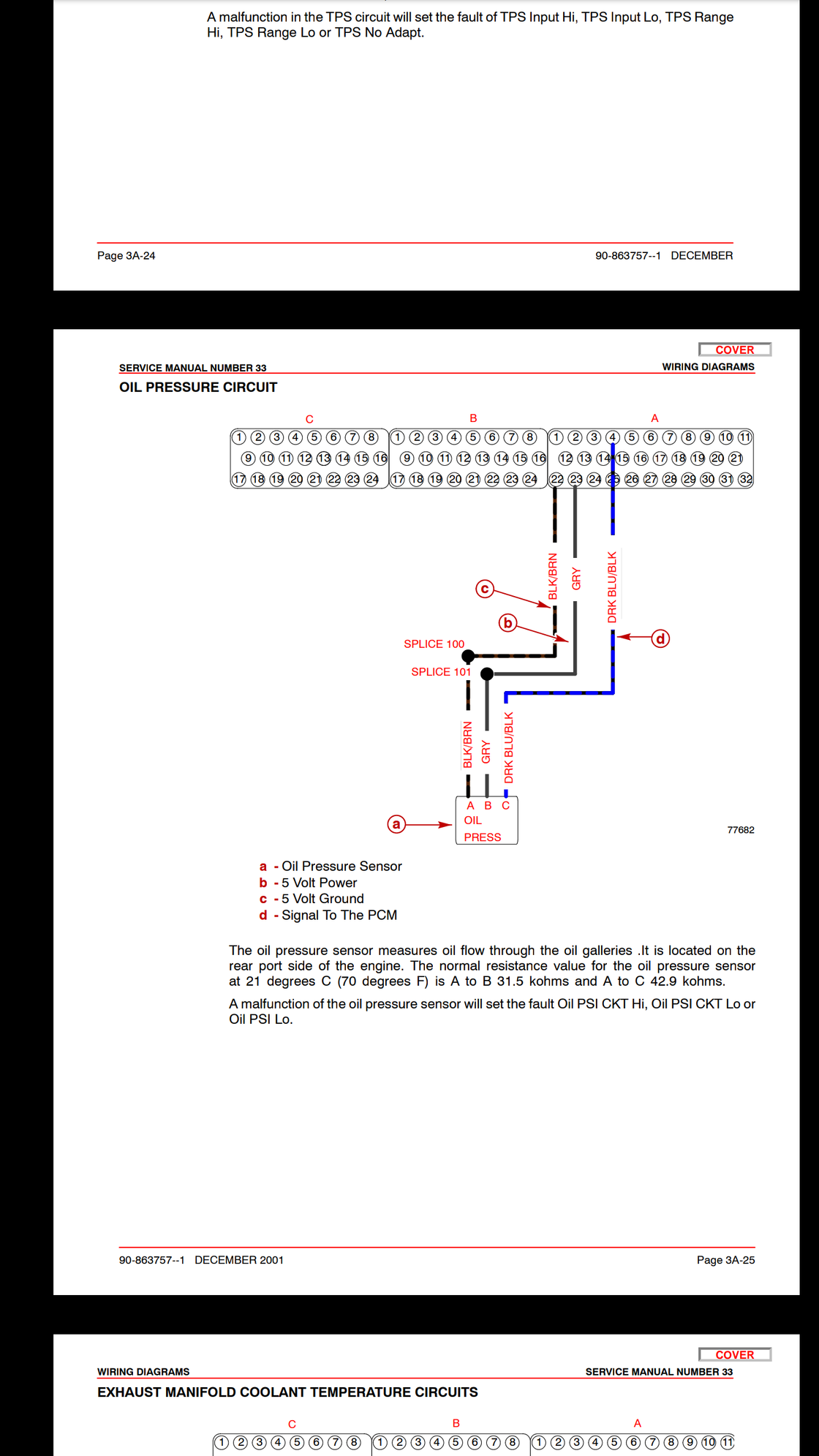

2005 496,where is sensor located?, and can it be tested to verify if defective

The sender for your dash mounted gauge is on the back of engine block near the crank position sensor. The sender that supplies info to the pcm 555 is port side block above oil filter pad.
