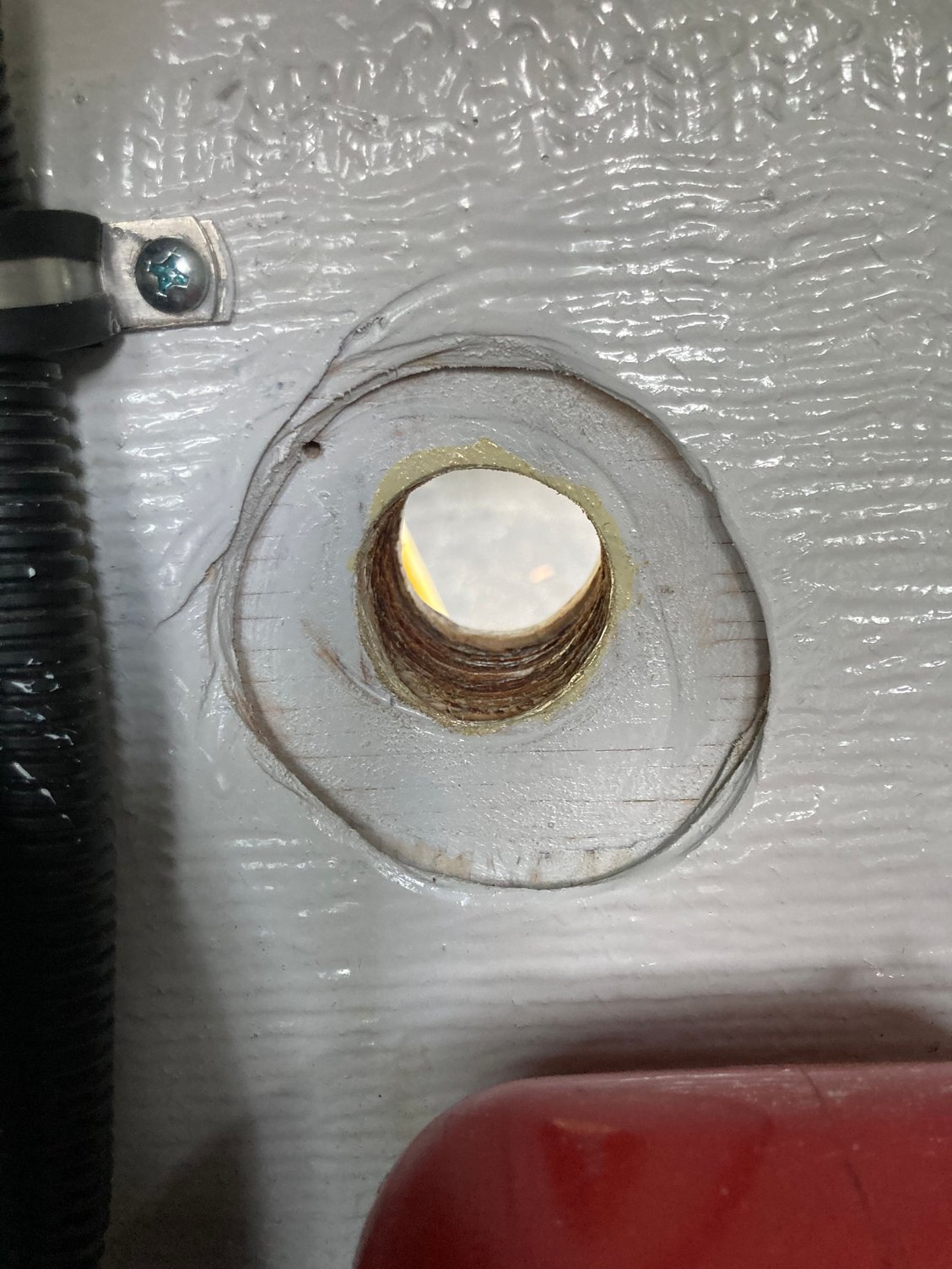

My boat has a 1.5 hole in the back of it where a water dump used to be, the PO took the fitting and I’m having a hell of a time finding one.
it doesn’t have to be anything special because I’m going to cap it off anyways. I just need to fill this large hole in the transom. I’d like to leave it fitting and not fill it in.
it needs to fit in a 1.5 hole and be longer than 2” the PO removed some of the transom just to make the fitting he had fit.

that’s the closest one yet, only problem with that one I see is the outside flange is only 1 3/4.
Do you think a 1/4 of flange on the outside will be enough? I will make sure to 4200 the **** out of it.
