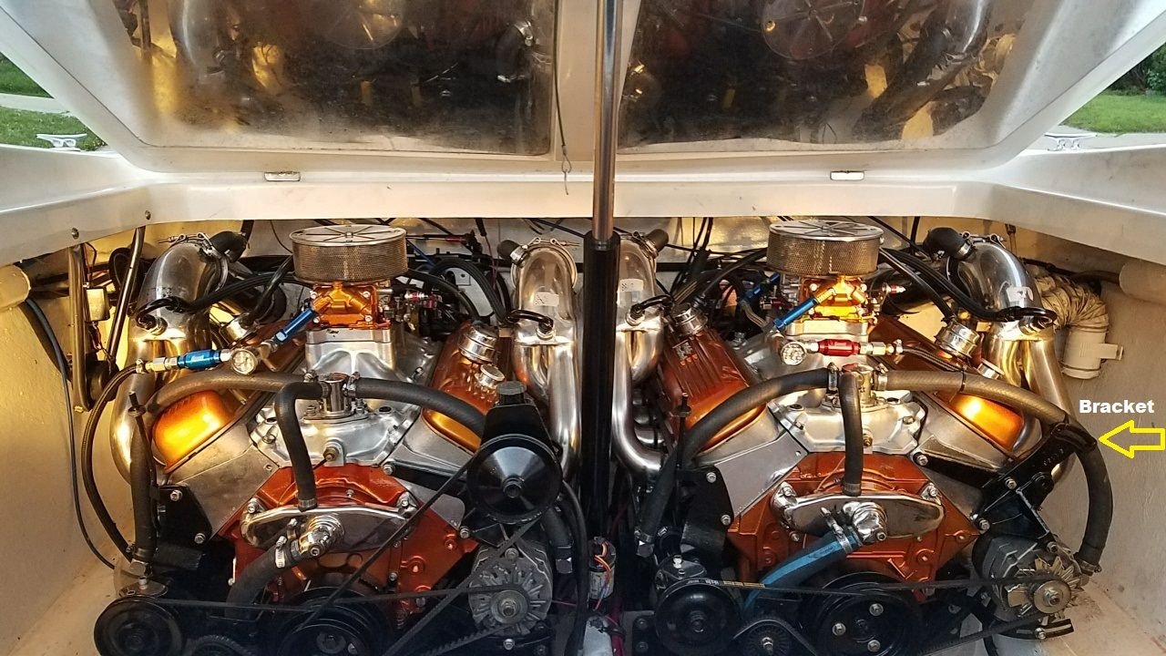

Here is what mine looks like, minus the P/S belt. The P/S belt goes from the crank outer grove to the recirculating pump outer grove to the P/S pump.
I should be at the boat tomorrow and I can give you a picture of all of them and the P/S belt number.
Hope this helps.

It's just the power steering/alternator bracket. I have used it on MKIV, Gen V and VI with a 3 groove pulley.
Hope this helps.

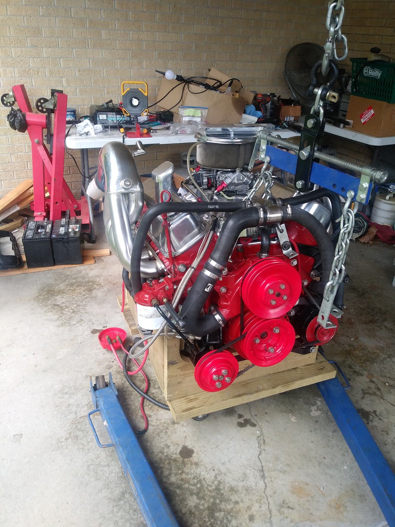

So YOU CAN SEE i HAVE USED 2 HOSES and coupled them with a stainless steel coupler to make it the correct length. I also am told that the hose is the same for a 500 hp. I don't know bit I know this works.
