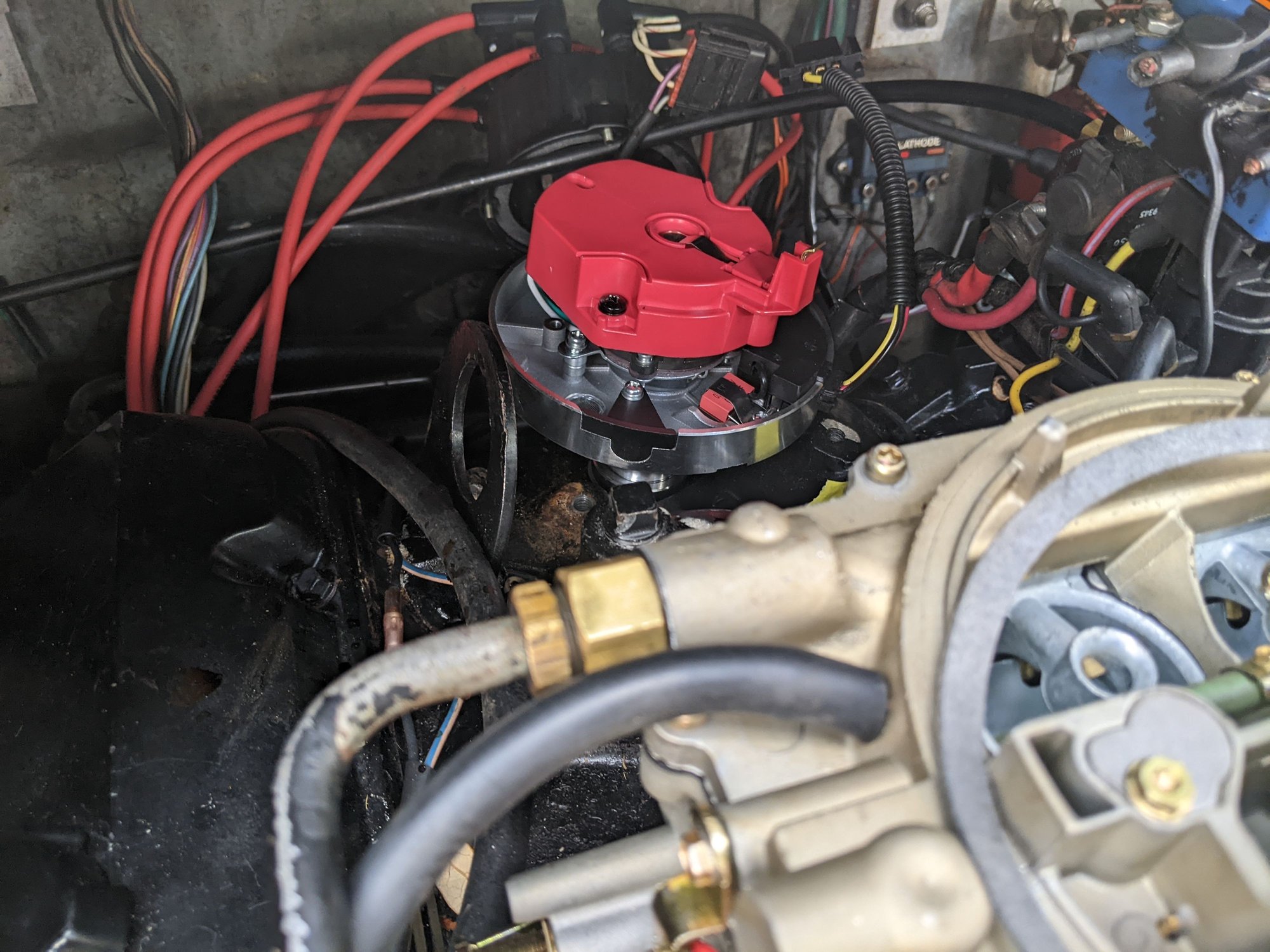

Originally Posted by SB
No. They don’t work the same. Nothing to ground out. Just set your advance gun to 0 and aim at the timing tab and dampener with engine running. That module typically means you set base timing to 8*.
You absolutely pos you have a 5 ?
I want the record to show that you were 100% right on how the tbiv works vs tbv. Thank you yesterday I began the process of swapping out the distributor and thunderbolt system for a marine HEI unit. Of course being my first time ever doing this I managed to get it 180 out and it wouldn't start and then it started raining. Came back this morning used my compression tester to find TDC on #1 and reinstalled the distributor and VROOM VROOM. Fired right up and the timing marks stayed steady as I moved and shifted her around. This unit supposedly has a 20° advance curve, i set the base at 12 instead of 8. Have a party to go to and more spotty weather on the horizon today but hoping to water test her again by no later than Monday. If she still doesn't go above 3500 rpm then, I will truly be at a loss.

Carb has been rejetted to definitely be rich, new timing light bought to double check things and readjust timing. Set base timing to 15 and checked it at 3000 rpm with the new digital advance timing light and it was spot on at 35 degrees advance. Boat still does same thing, runs decent up to 3200 then makes more noise but no more power and only goes to 3800. Looking like she's gonna have to be pulled out again. It's as if entire can shaft has rounded off equally and just won't let it go above 3800

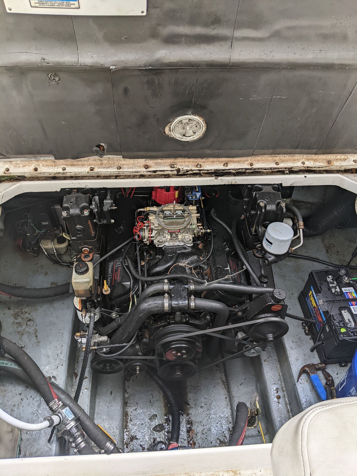

Inknow everyone hates it when threads end with no resolution so here's an update!
We got her pulled back out of the boat. Mechanic has since moved his shop within the same industrial plaza and is directly across from the engine rebuilder. It was as simple as a wave and I had the builder over with my mechanic and we all checked compression and did leak down together. Everyone is befuddled. At first thought maybe a head gasket had gone between cylinders when it seemed some air was leaking from #1 to #3 but then. Nothing l asked back the other direction from 3 to 1. All we know is we absolutely have low compression on #1 cylinder though it's not seemingly so bad to make sense as to why the boat won't go over 3000 rpm with any power. Motor is undressed and it will be brought across to the rebuilder on Monday and the head will be pulled and we can really see what we got going on. I. The meantime I have sourced a set of 088 heads that we're takeoffs from a crate motor. I can get the pair for $750. I still believe in the peanut port build but. Ow that it's out and we gotta do it again I'm thinking the 088s just might be the better match for the 18cc dome pistons we have in there. Hoping that we discover some sort of valve/head issue and all we need to do is a head swap or something and put it back in.
So what say you the experts about the 088 heads? Good match with the 18cc dome pistons to get the compression back down in a friendlier place for iron heads?
