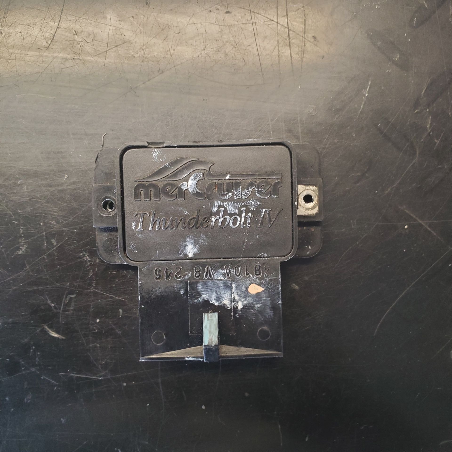

Old 06-09-2022 | 01:19 PM
  #137
Joined: Sep 2021
Posts: 74
Likes: 9
pic of the module.
CPFITNESS is offline
Old 06-09-2022 | 01:35 PM
  #138
SB
Joined: Nov 2004
Posts: 14,163
Likes: 3,721
From: On A Dirt Floor
That’s a tbolt iv module.
Oh What the heck….,,,what wire where you guys grounding ?
Think I need a beer or some mushrooms. :wink Hmmm..decisions…..decision's Maybe some advil for now….lol
