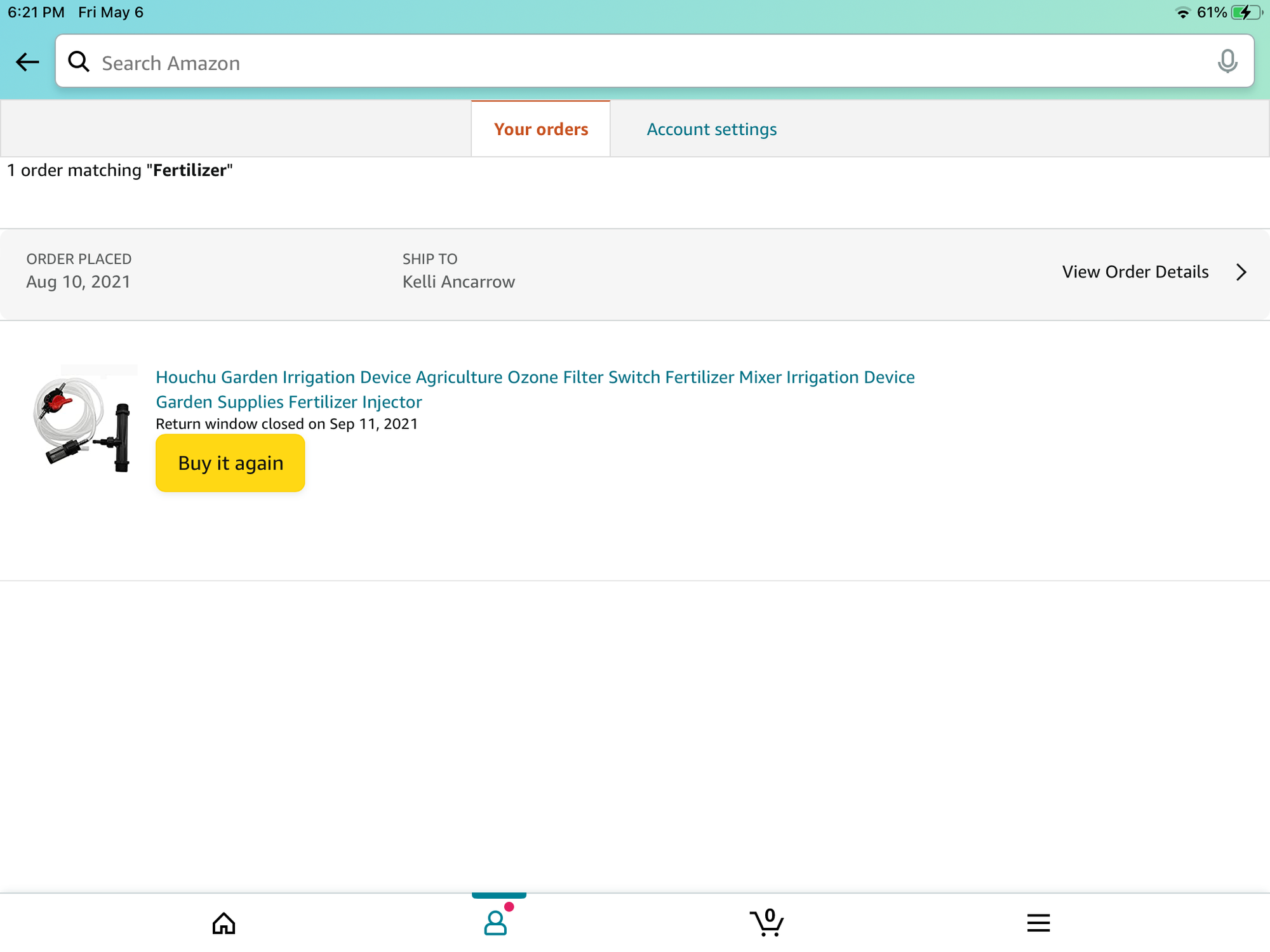

A 500gph (1.8m3/hr) HVAC water pump will dictate a 3/4" plastic Chinese venturi injector. See link below. You may or may not need to play with the check valve spring.
Fertilizer Injector, Venturi Garden Irrigation Device Kit, G3/4 Fertilizer Injector Switch Water Tube Kit
Amazon Amazon

I just plumbed this into the condensate pan, and T-Ed it into the overboard discharge hose. Works GREAT. never a drop in the pan….. got so tired of the condensate ending up in the bilge….
