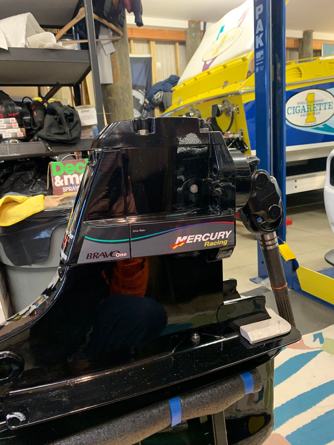

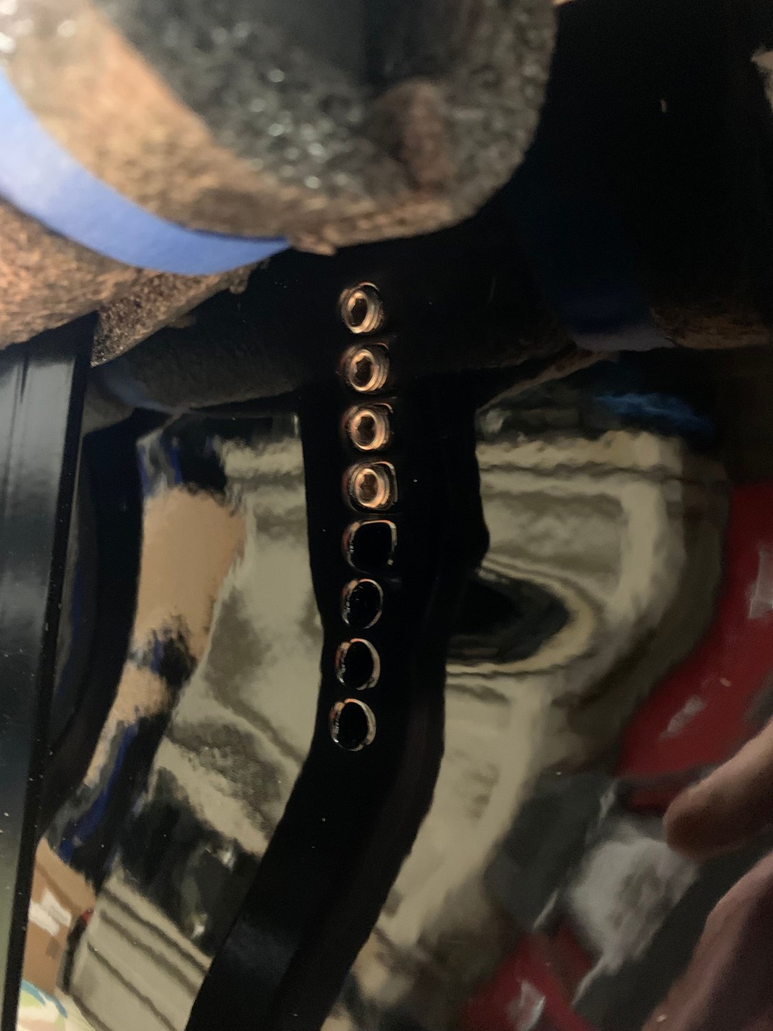

Just keep an eye out on the WP using the mercury thermostat it’s opening is very small. I had WP problems last year so I changed to a crossover and ran no thermostat to solve that problem but then I ran into not making temp in the engine. This year I’m running the crossover with the 140 Hardin marine hi-flow thermostat with the bypass. Also I tapped the 4 top hole in the drive pick up. I have new xz DWP drives . If I run into temp problem I can remove the set screws to allow more water to flow in but also control the water pressure.
