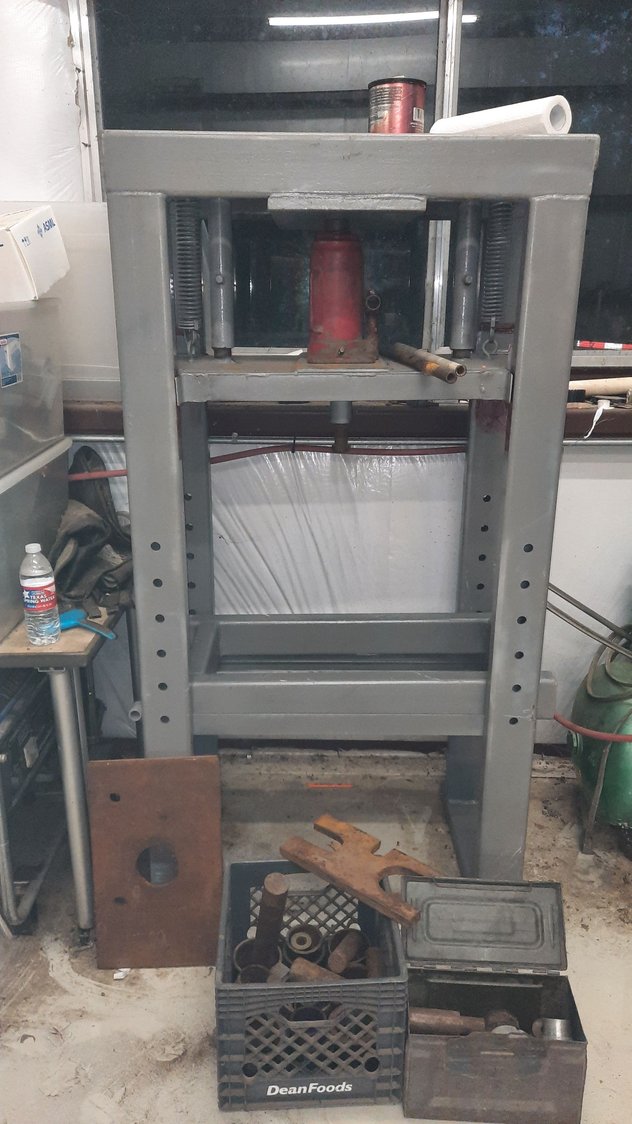

Just got back from picking up the shop built press. Thing weighs over 800 lbs + abt 200 lbs worth of thick plates/adapters/ etc. I'm worn-out from loading and unloading in the 100+ deg heat.. Ironically, prev owner who built it used it to press hubs into props.

You will most likely need to use a hydraulic press to remove and install the bearings and shaft back into the housing.

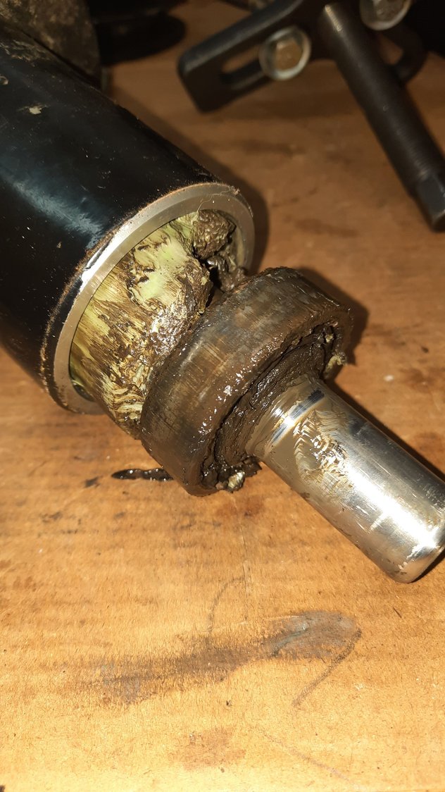

Got the bearing assy apart last night. My new-to-me hyd press made quick work of it. Didn't even have to install the handle into the bottle jack. Nothing like having the right tools for the job! Bearings were still intact but felt really rough. No wonder it sounded so unhappy. Waiting on my Ebay delivery now.
Old bearing coming out..Yuck..

Got it all back together and idle tested on the hose. Much better. Thx to all.
BTW, bearings were Koyo 62042RSCM sealed and pre-lubed. Didn't pack grease in void between the bearings since the bearings are sealed on both sides..
