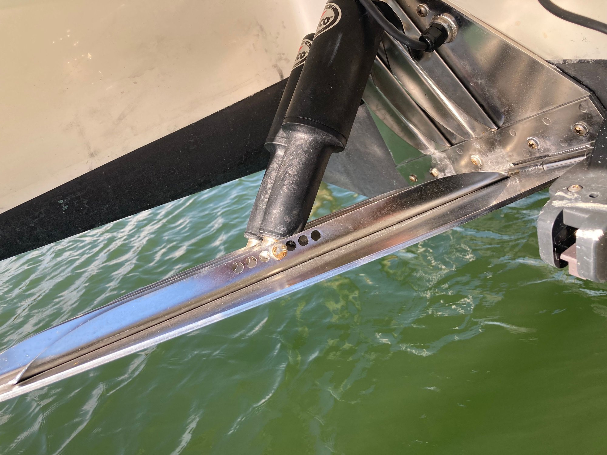

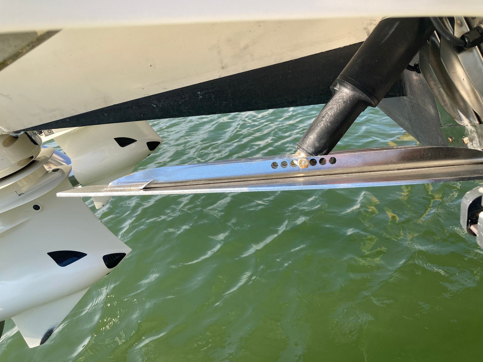

I just had these lencos installed, all electric with a digital indicator integrated into the switch panel. Quite nice

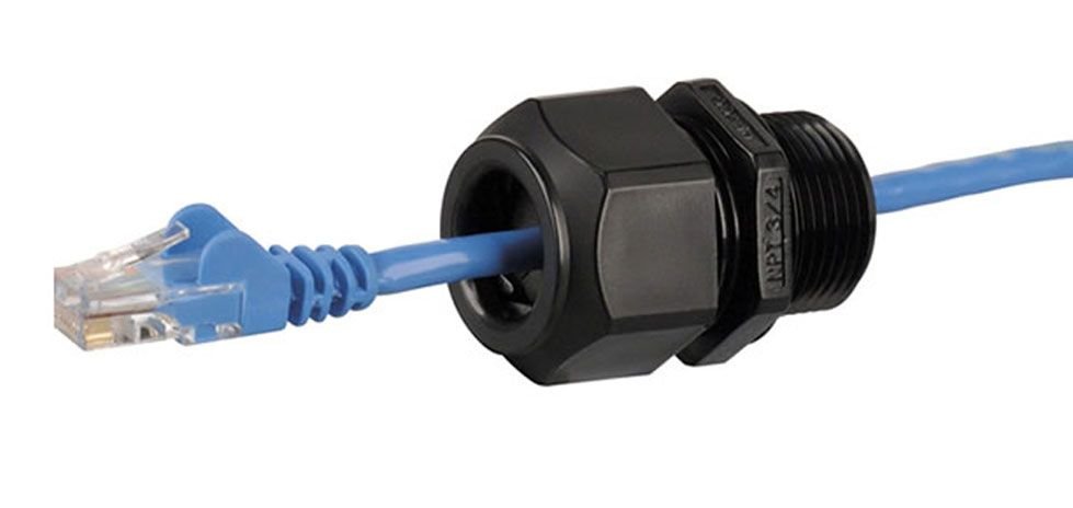

you can convert k planes for indicators easily. the thru hull fitting for the 33c cable can be found at menards. You can buy the lower pins or make them if you have access to a lathe...

nope...it screws into the k plane base plate cable gland,,, like this
There is a plug near the upper pivot pin, this replaces the plug abd you drill a hole for the cable
Part number 23... though it will be 5 bucks at menards vs.....

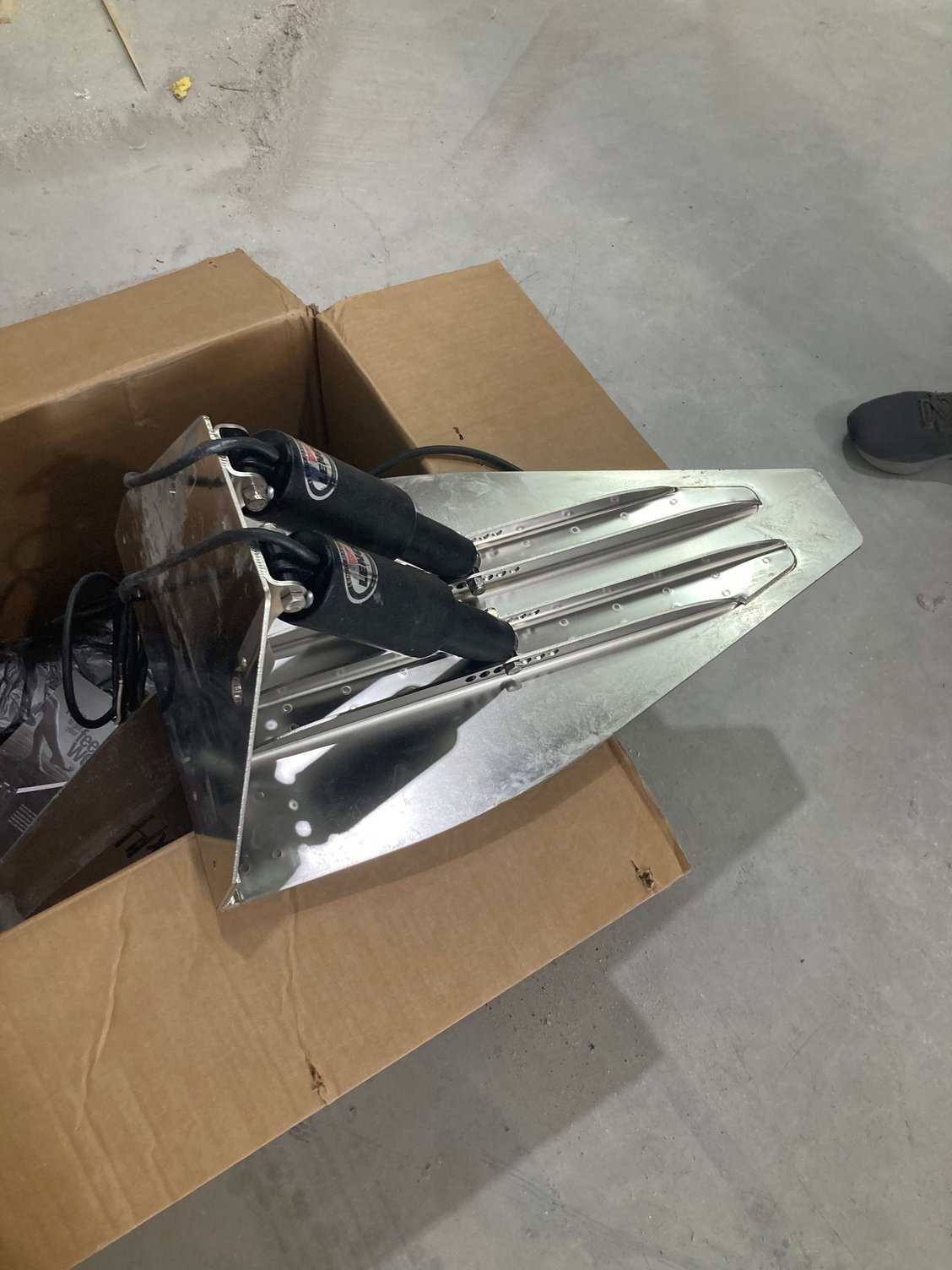

I believe these are the digital part numbers if you go that route.
Join Date: Oct 2012
Posts: 1,809
Likes: 447
Received 264 Likes on 152 Posts
Default F/S 2 K Plane electronic sensors w/harness Mercury K Plane electronic sensors (part number 863187A04), 1 harness (part number 84-895820A05), 2 L brackets that go from the sensor to tabs with bolts, and 2 stainless fittings that screw into K Plane transome plates that the wires go through (Wire grips) are needed.
