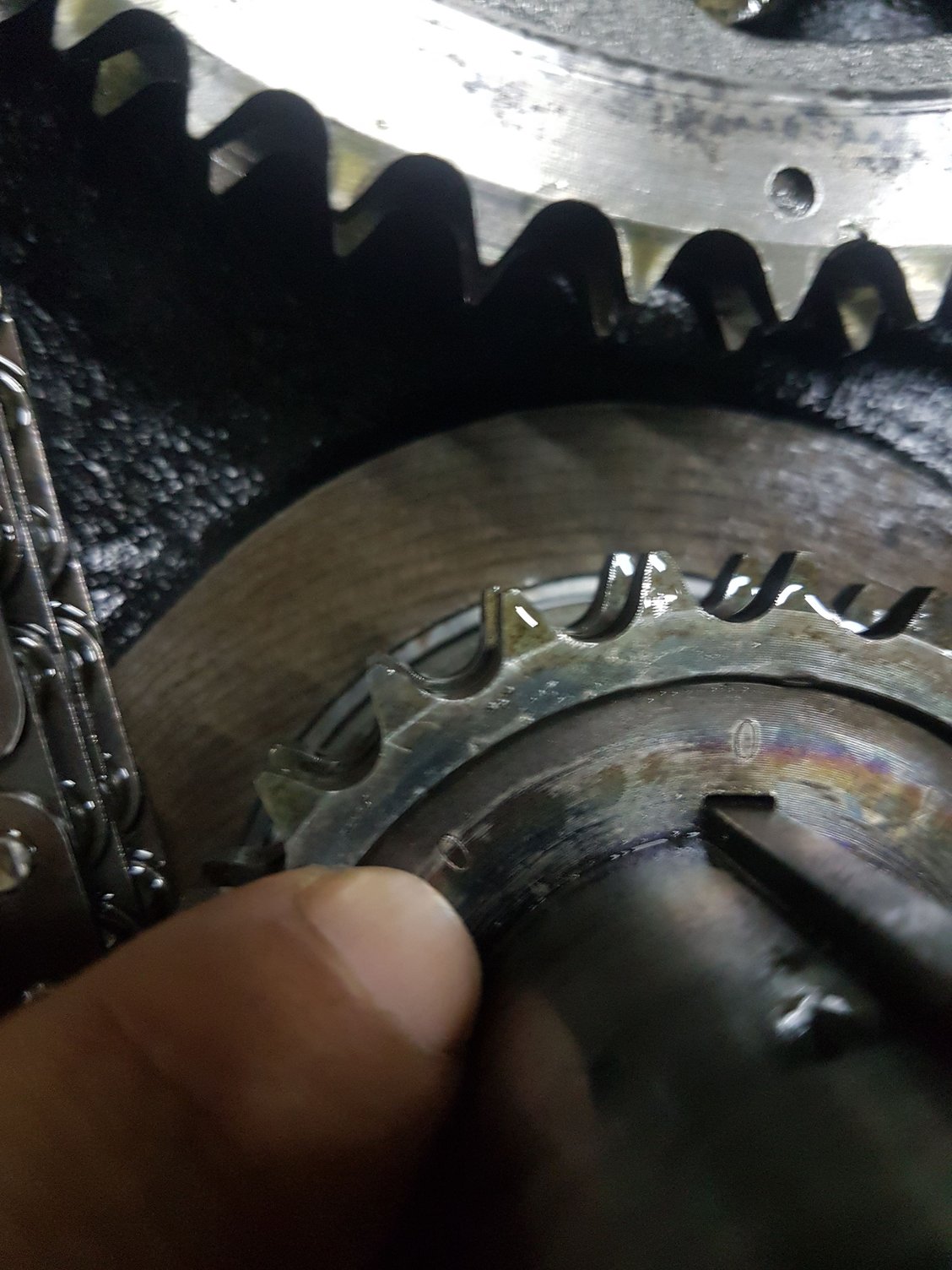

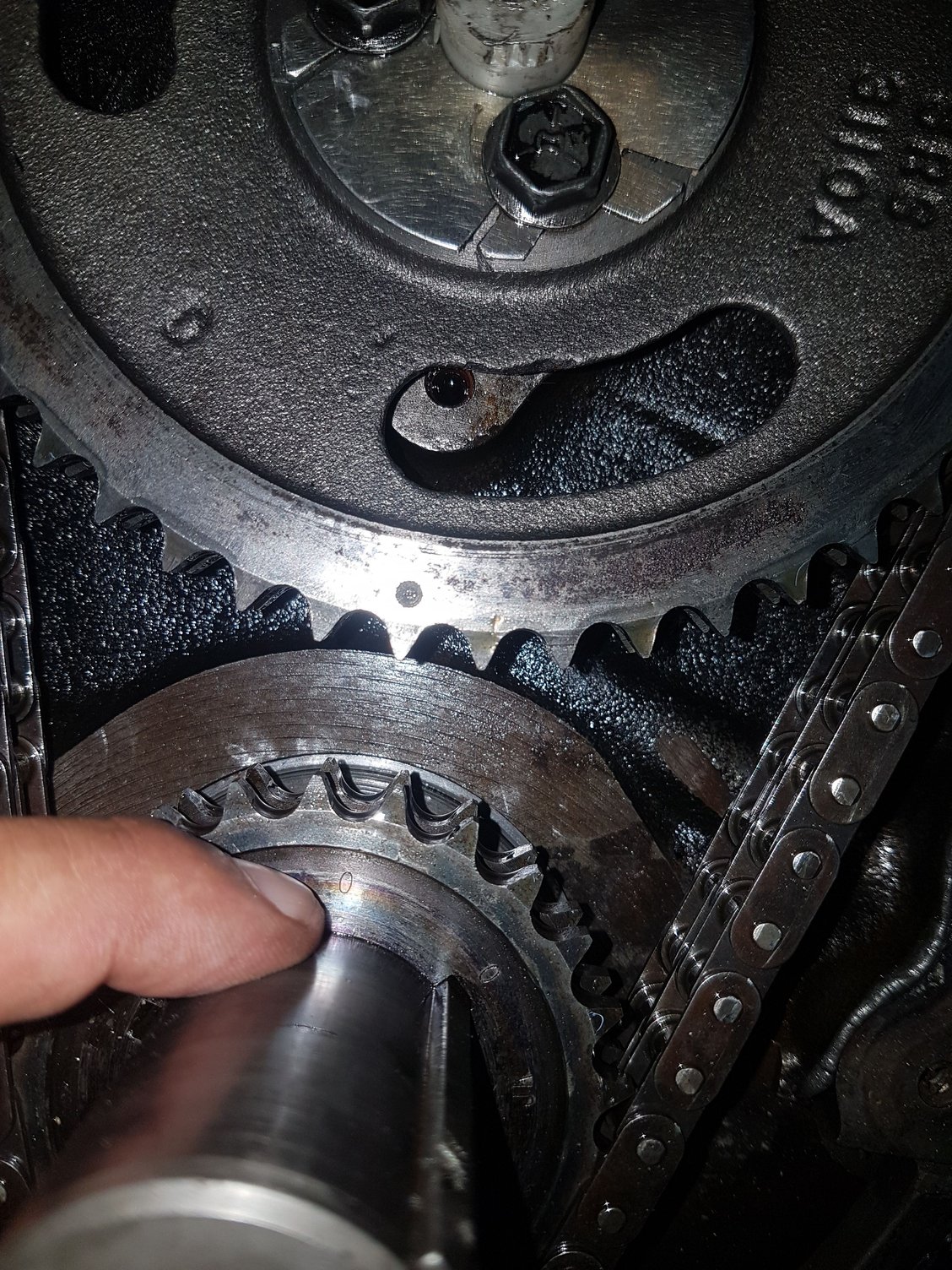

O my good SB..Yes i did have a 3-vay keyway and it was mounted wrong.When the dots where like this
the intake valve is hitting the piston.Then i found another 0 mark and i put it like this
then i have this 0.236 gap..Because i live in a vilige far far away i dont have a degree disk.So i took clay and soft springs and got this messurment

The timing set is installed correctly. The keyway on the crank is not supposed to line up with the dot on the cam gear. If you put the 0 on the keyway, then you use the 0 on the crank gear to line up with the dot on the cam gear.
