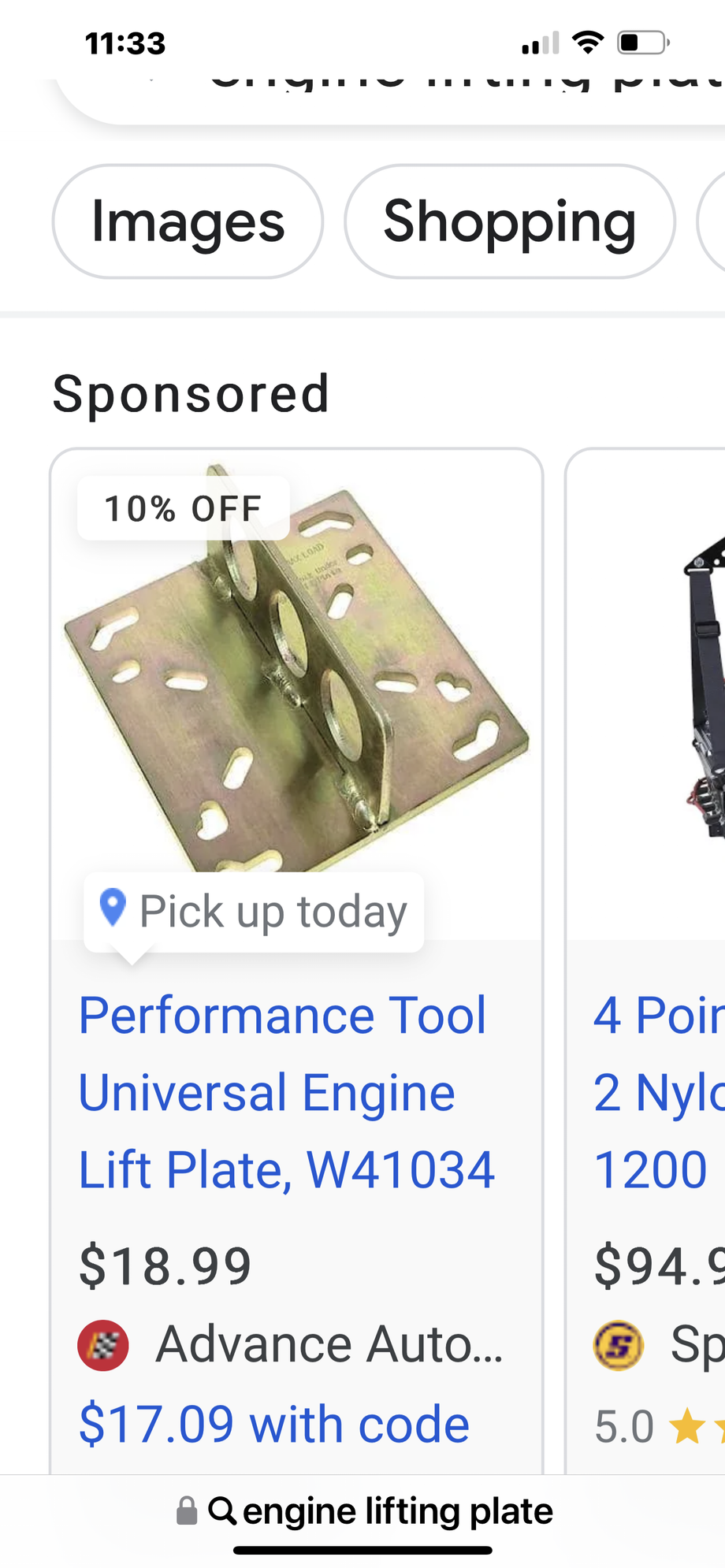

A chain across diagonally be fine also. The heads or the exhaust. The engine don’t care.
I’d be questioning my mechanic just a tad bit. Not being mean or rude - just sayin!
