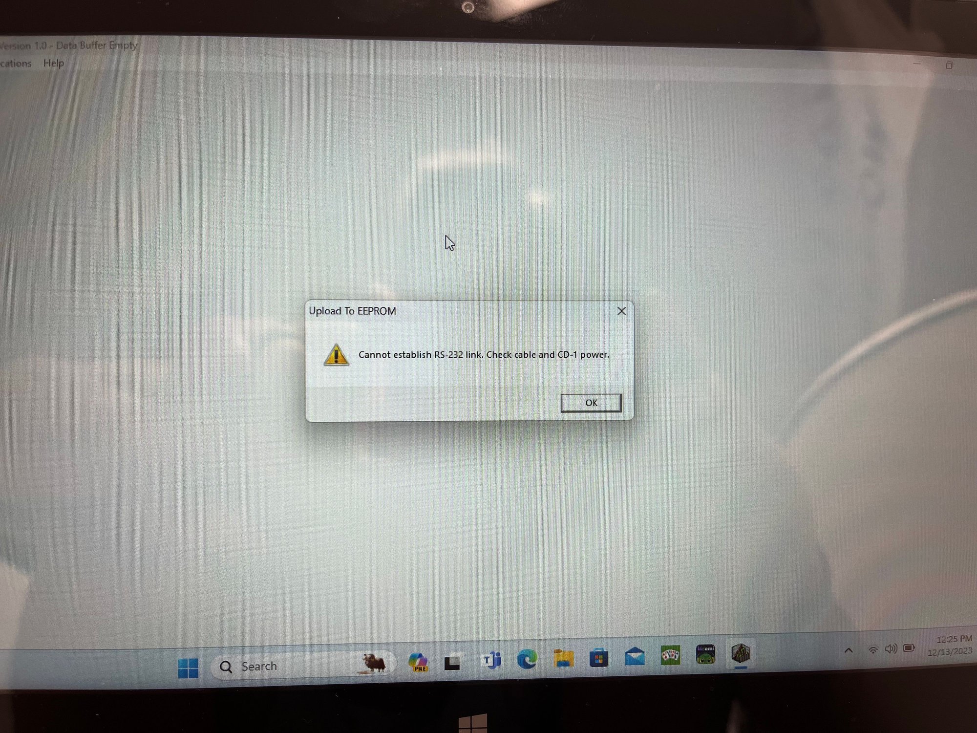

I hear ya. I bought a cheap gateway laptop but there are some driver issues as the software from Daytona is pretty dated. The customer service has been really good and it will get worked out. My daughter is coming down for Xmas and I don’t want to get in too deep if there’s something wrong with the box or coil. So , I am hooking it up like an msd box initially and after the new year I am pulling and locking the timing and using the box for timing and Idle control.

Glad I waited. May have to send the box back. Not for nothing , the software really needs updating.
