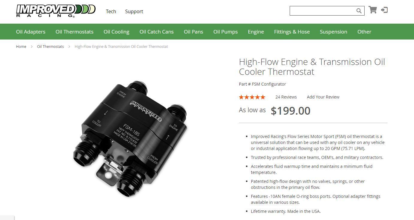

I bought a thermostat from Improved racing. Works very well. They have a few different temperature settings available and it's easy to switch them out. I started with the 212 degree setting but that was too hot and ended up buying the185 degree internals. They also have a 165 degree. I bought a Hardin block mounted remote oil filter assembly and later found out that they have basically the same assembly with an integral thermostat. Hardin and CP basically sell the same stuff. They have many different remote filter blocks.

I run an Improved racing thermostatic filter base with 12AN fittings. I like the 145 thermostat after testing a few different t-stats.
