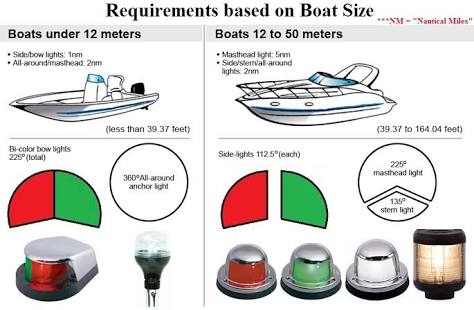

@ neva satisfied, sorry about my earlier post, your masthead light may not be on backwards!
Did some searching and although mixed results, some say powerboats should run a forward facing light while underway, but may be dependent on boat size. News to me, I've learnt something today.
I quite liked these illustrations......
[ATTACH=CONFIG]564983[/ATTACH]
[ATTACH=CONFIG]564984[/ATTACH]
RR
